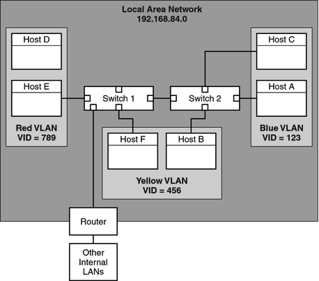

The following figure shows a local area network that has the subnet address 192.168.84.0. This LAN is subdivided into three VLANs, Red, Yellow, and Blue.
Figure 13-1 Local Area Network With Three VLANs
Connectivity on LAN 192.168.84.0 is handled by Switches 1 and 2. The Red VLAN contains systems in the Accounting workgroup. The Human Resources workgroup's systems are on the Yellow VLAN. Systems of the Information Technologies workgroup are assigned to the Blue VLAN.

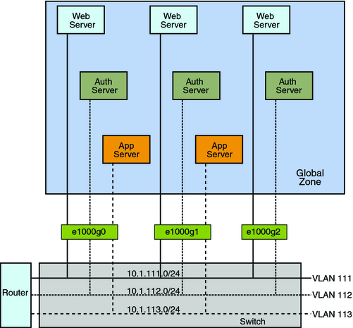

VLANs on zones allow you to configure multiple virtual networks within a single network unit such as a switch. Consider the following illustration of a system with three physical NICs:
Figure 13-2 System With Multiple VLANs
Without VLANs, you would configure different systems to perform specific functions and connect these systems to separate networks. For example, web servers would be connected to one LAN, authentication servers to another, and application servers to a third network. With VLANs and zones, you can collapse all eight systems and configure them as zones in a single system. Then you use VLAN tags, or VLAN IDs (VIDs) to assign a VLAN to each set of zones that performs the same functions. The information provided in the figure can be tabulated as follows:
To create the configuration shown in the figure, refer to Example 13-1.

Example 13-1 Configuring a VLAN
This example creates the VLAN configuration that is illustrated in Figure 13-2. This example assumes that you have already configured the different zones in the system. For more information about configuring zones, see Part II, Oracle Solaris Zones, in Oracle Solaris Administration: Oracle Solaris Zones, Oracle Solaris 10 Zones, and Resource Management.
global# dladm show-link LINK CLASS MTU STATE BRIDGE OVER e1000g0 phys 1500 up -- -- e1000g1 phys 1500 up -- -- e1000g2 phys 1500 up -- -- global# dladm create-vlan -l e1000g0 -v 111 web1 global# dladm create-vlan -l e1000g0 -v 112 auth1 global# dladm create-vlan -l e1000g0 -v 113 app1 global# dladm create-vlan -l e1000g1 -v 111 web2 global# dladm create-vlan -l e1000g1 -v 112 auth2 global# dladm create-vlan -l e1000g1 -v 113 app2 global# dladm create-vlan -l e1000g2 -v 111 web3 global# dladm create-vlan -l e1000g2 -v 112 auth3 global# dladm show-vlan LINK VID OVER FLAGS web1 111 e1000g0 ---- auth1 112 e1000g0 ---- app1 113 e1000g0 ---- web2 111 e1000g1 ---- auth2 112 e1000g1 ---- app2 113 e1000g1 ---- web3 111 e1000g2 ---- auth3 113 e1000g2 ----
When link information is displayed, the VLANs are included in the list.
global# dladm show-link LINK CLASS MTU STATE BRIDGE OVER e1000g0 phys 1500 up -- -- e1000g1 phys 1500 up -- -- e1000g2 phys 1500 up -- -- web1 vlan 1500 up -- e1000g0 auth1 vlan 1500 up -- e1000g0 app1 vlan 1500 up -- e1000g0 web2 vlan 1500 up -- e1000g1 auth2 vlan 1500 up -- e1000g1 app2 vlan 1500 up -- e1000g1 web3 vlan 1500 up -- e1000g2 auth3 vlan 1500 up -- e1000g2
You assign the VLANs to their respective zones. For example, when you check for network information about individual zones, data similar to the following would be displayed for each zone:
global# zonecfg -z webzone1 info net net: address not specified physical: web1 global# zonecfg -z authzone1 info net net: address not specified physical: auth1 global# zonecfg -z appzone2 info net net: address not specified physical: app2
The value of the property physical indicates the VLAN that is set for the given zone.
You log in to each non-global zone to configure the VLAN with an IP address.
In webzone1:
webzone1# ipadm create-ip web1 webzone1# ipadm create-addr -T static -a 10.1.111.0/24 web1/v4
In webzone2:
webzone2# ipadm create-ip web2 webzone2# ipadm create-addr -T static -a 10.1.111.0/24 web2/v4
In webzone3:
webzone3# ipadm create-ip web3 webzone3# ipadm create-addr -T static -a 10.1.111.0/24 web3/v4
In authzone1:
authzone1# ipadm create-ip auth1 authzone1# ipadm create-addr -T static -a 10.1.112.0/24 auth1/v4
In authzone2:
authzone2# ipadm create-ip auth2 autzone2# ipadm create-addr -T static -a 10.1.112.0/24 auth2/v4
In authzone3:
authzone3# ipadm create-ip auth3 authzone3# ipadm create-addr -T static -a 10.1.112.0/24 auth3/v4
In appzone1:
appzone1# ipadm create-ip app1 appzone1# ipadm create-addr -T static -a 10.1.113.0/24 app1/v4
In appzone2:
appzone2# ipadm create-ip app2 appzone2# ipadm create-addr -T static -a 10.1.113.0/24 app2/v4
