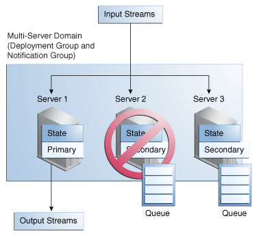

Figure 20-1 shows a typical configuration.
Figure 20-1 Oracle CEP High Availability: Primary and Secondary Servers

In general, when a secondary server fails, there is no effect on Oracle CEP application operation as Figure 20-3 shows. Regardless of the quality of service you choose, there are no missed or duplicate events.
