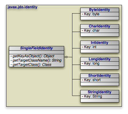

Single field identity is a subset of application identity. When
you have only one primary key field, you can choose to use one
of JDO's built-in single field identity classes instead of coding
your own application identity class. All single field identity
classes extend
javax.jdo.identity.SingleFieldIdentity
This base type defines the following methods:
public Object getKeyAsObject ()
Returns the primary key value as an object. Each
SingleFieldIdentity
subclass also defines a
getKey
method to return the primary key
in its primitive form.
public Class getTargetClass ()
The target class of a single field identity object is the persistent
class to which the identity object corresponds. Note that the
target class is not part of the serialized state of a
SingleFieldIdentity
instance. After an
instance has been deserialized, calls to this method return
null
public String getTargetClassName ()
Returns the name of the target class. This method returns the correct value even after a single field identity object has been deserialized.
The following list enumerates the primary key field types supported by single field identity, and the built-in identity class for each type:
byte
java.lang.Byte
javax.jdo.identity.ByteIdentity
char
java.lang.Character
javax.jdo.identity.CharIdentity
int
java.lang.Integer
javax.jdo.identity.IntIdentity
long
java.lang.Long
javax.jdo.identity.LongIdentity
short
java.lang.Short
javax.jdo.identity.ShortIdentity
java.lang.String
javax.jdo.identity.StringIdentity
