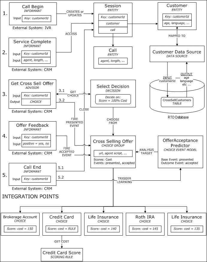

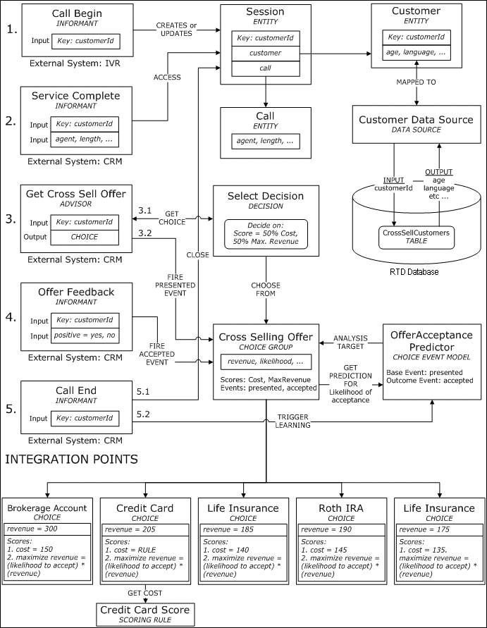

    The following diagram shows how the Get Cross Sell Offer Advisor retrieves and presents an offer, and then the Offer Feedback Informant accepts or rejects the offer. When the Call End Informant closes the session, the Offer Acceptance Predictor model is updated with the offer Presented/Accepted events.
    Figure 5-1 Tutorial Inline Service Objects: Advisor/Informant Flow

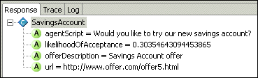

    Then, confirm in the Response subtab that an offer was retrieved. In the Log subtab, you should see something similar to the following:
    00:45:28,466 Integration Point - Get Cross Sell Offer
    00:45:28,466   Customer age = 38
    00:45:28,466   Offer presented: 'Credit Card'
    Note that even if you tried different values for customerId, the offer presented is always Savings Account or Credit Card. This is because we have only one performance goal at this point - to minimize cost, and Savings Account or Credit Card is the lowest cost, depending on the age of the customer.

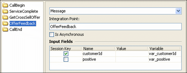

  3. Select the Edit Script tab, then right-click the left tree view and select Add Action. The action is of type Message and the Integration Point name should be OfferFeedback.
  4. In Input Fields, right-click and chose Add item to add an input field. Click in the space under Name and add customerId. In the Variable column, select the matching variable, var_customerId (see Section 3.1.1, "Creating the Load Generator Script" for more information). Mark customerId as a session key by selecting Session Key.
  5. Again in Input Fields, right-click and chose Add item to add an input field. Click in the space under Name and add positive. In the Variable column, select the matching variable, var_positive.
  6. After we add this action to the script, it is placed at the bottom of the actions list. We need to adjust the order so that OfferFeedback is called after GetCrossSellOffer. In the left side of the Edit Script tab, right-click OfferFeedback and select Move Up or Move Down so that the order is CallBegin, ServiceComplete, GetCrossSellOffer, OfferFeedback, and CallEnd.
    Figure 5-3 Adding the OfferFeedback Informant to the Load Generator Script

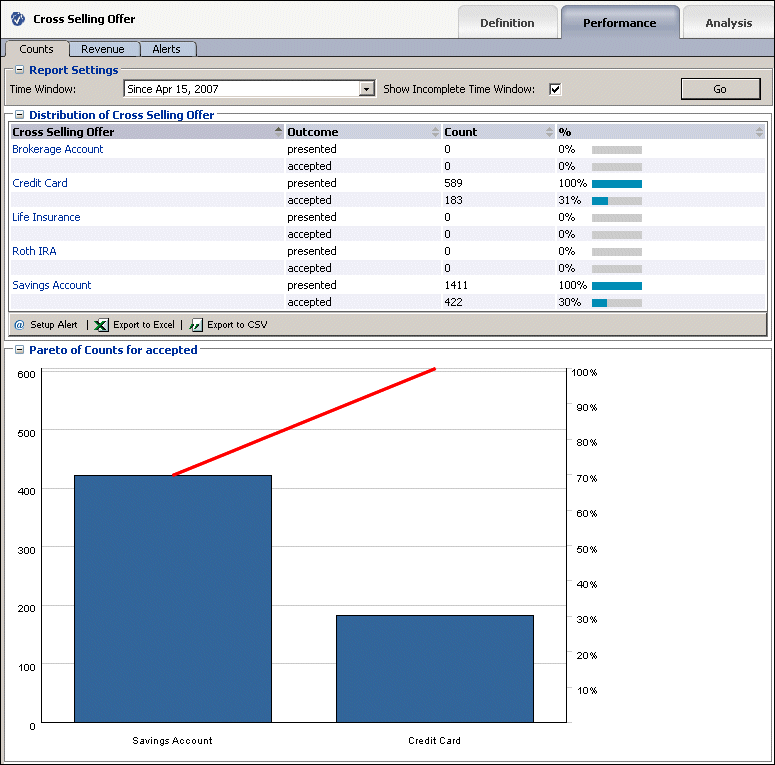

You can run the Load Generator script at this point. Again, it is recommended that you remove existing data before running the script so the results are not mixed with older data - see Section 3.2, "Resetting the Model Learnings" for information about how to do this.

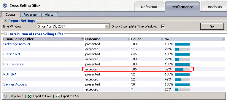

If you do run the Load Generator script, you can view the results in Decision Center. Log in to Decision Center and click the Cross Selling Offer choice group to show the results of the Offer Acceptance Predictor model. Click the Performance tab and then the Counts subtab. The distribution of offers and the Pareto graph should look like the one shown in Figure 5-4.
Figure 5-4 Decision Center Performance Counts for Cross Selling Offer
Description of Figure 5-4 follows
Description of "Figure 5-4 Decision Center Performance Counts for Cross Selling Offer"
Notice that only two offers were presented - Credit Card and Savings Account, and each one had an acceptance rate of about 30%. This is entirely expected due to the logic we have set up so far: 1) Only one performance goal - minimizing Cost - was to be met, and the Cost is lowest for Savings Account or Credit Card, depending on the age of the customer (see Section 4.4, "Scoring the Choices"). In the Load Generator script, we specified that 30% of the time, a positive response to an offer is registered through the OfferFeedback Informant. If we drill down into the analysis reports of individual offers, we will not see much correlation between the acceptance of an offer and session attributes. This is because we are using random customer profile data and forcing the acceptance rate to be 30%, regardless of customer or other attributes (such as call length, call agent name, call reason, and so on).

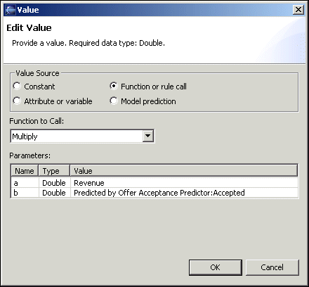

To calculate the score value for the Maximize Revenue goal, we need the base Revenue and the likelihood of acceptance value as determined by the Offer Acceptance Predictor choice event model. This can be retrieved using the edit value dialog by changing the value source to Model Prediction.
To calculate the score value for the Maximize Revenue goal:
  1. In the Inline Service Explorer, under Choices, double-click the Cross Selling Offer choice group. In the Scores tab, click in the Score column for the Maximize Revenue metric, then click the ellipsis to bring up the Edit Value dialog.
  2. For the Value Source, select Function or rule call. Under Function to Call, choose the function Multiply. In the Parameters table, click in the Value cell for parameter a. Click the ellipsis and choose Attribute or variable, then expand the Choice folder, select Revenue, and click OK. In the Parameters table, click in the Value cell for parameter b. Click the ellipsis and choose Model Prediction. Choose the likelihood predicted by the Offer Acceptance Predictor model and the Accepted event, then click OK. Click OK again in the Edit Value dialog.
    Figure 5-5 Edit Value Dialog for Maximize Revenue Score
    Description of Figure 5-5 follows
    Description of "Figure 5-5 Edit Value Dialog for Maximize Revenue Score"
    The actual value of the likelihood is from 0 to 1, 1 being 100% likely to accept. It is also possible for the value to be NaN (Not a number), which means the model did not have enough data to compute a likelihood value. In such situations, the Maximize Revenue score cannot be computed and the offer selection by the Select Offer decision will be based on built-in score comparison logic, which depends on whether the score is or is not required.
  3. By defining the score for Maximize Revenue on the choice group level, all of the choices within this group will inherit the definition and apply choice-specific values for Revenue and likelihood of acceptance during run time.

  3. To see the effect of the changes to the Advisor, save all and deploy the Inline Service.
  4. In Test view, select the Get Cross Sell Offer Integration Point and input a value for customerId, such as 8. Click Send. In the Response subtab in Test View, you should see something similar to the image shown in Figure 5-6.
    Figure 5-6 Response Subtab in Test View
    Description of Figure 5-6 follows
    Description of "Figure 5-6 Response Subtab in Test View"

    The following diagram shows the Get Cross Sell Offer Advisor retrieving an offer from the Cross Selling Offer choice group, where the total score of each offer is a weighted sum of two scores - Cost and Maximize Revenue.
    Figure 5-7 Tutorial Inline Service Objects: Weighted Sum
    Description of Figure 5-7 follows
    Description of "Figure 5-7 Tutorial Inline Service Objects: Weighted Sum"
5.2.7 Introducing Offer Acceptance Bias for Selected Customers
Earlier in the Offer Feedback Informant, we specified whether to accept a presented offer through the Positive Informant parameter. We then updated the Load Generator script so that when this Informant is called, we pass the value yes to the parameter Positive 30% of the time (see Section 5.1.7, "Updating the Load Generator Script"). This percentage did not depend on any customer profile data - any presented offer had a 30% chance of being accepted by any customer.
If we run the Load Generator script at this point, the models would not show any strong correlation between customer attribute to the acceptance of the offer. We will introduce an artificial bias in the Offer Feedback Informant logic which will always record positive offer acceptances for customers who have two or more children and who were presented the Life Insurance offer. This logic is in addition to the default acceptance rate (as defined in the Load Generator script) and will skew the acceptance rate for the Life Insurance offer to more than 30%. In Decision Center, we will be able to see clear correlations between the number of children and the acceptance rate of this offer.
To introduce the Offer Acceptance bias:
  1. In the Inline Service Explorer, double-click Offer Feedback under Integration Points > Informants.
  2. In the Logic tab, update the existing code by adding several lines to add offer acceptance bias for customers who have two or more children and who were presented the Life Insurance offer. The completed code should appear as follows:

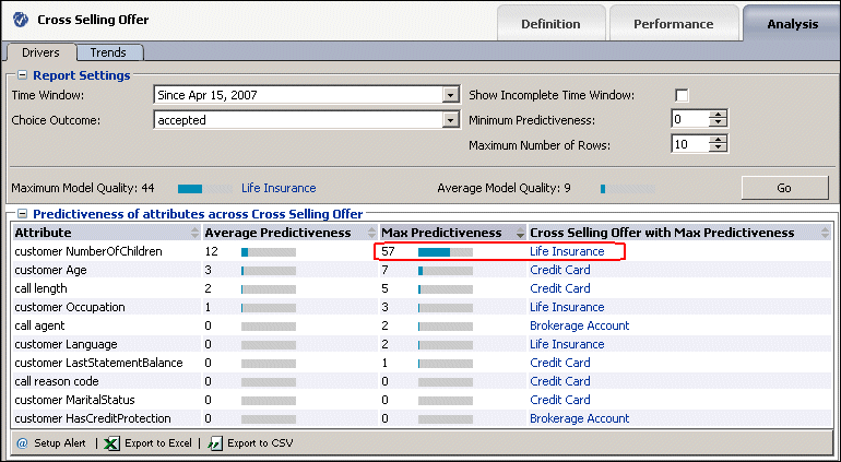

5.2.9 Studying the Results
To view the results of the Load Generator run, log in to Decision Center. Click the Cross Selling Offer Choice Group in the left navigation box. This will show the results of the Offer Acceptance Predictor model. Click the Performance tab and then the Counts subtab. You should see a table similar to the one shown in Figure 5-8.
Figure 5-8 Performance Counts for Cross Selling Offer Choice Group
Description of Figure 5-8 follows
Description of "Figure 5-8 Performance Counts for Cross Selling Offer Choice Group"
The Decision Center table shows the distribution of the offers - how many were presented and how many were accepted for each offer. Except for Life Insurance, all of the other offers had acceptance rate of about 30%, as shown in Figure 5-8. This is expected because of how we set up the Load Generator script (see Section 5.1.7, "Updating the Load Generator Script"). The acceptance rate for Life Insurance is higher than 30% because of the artificial bias we introduced in Section 5.2.7, "Introducing Offer Acceptance Bias for Selected Customers." The bias dictated that in addition to 30% of the customers accepting any offer, customers who had two or more children and were offered Life Insurance will always accept the offer.
Given the artificial bias, the model results should show that for the Life Insurance offer, the NumberOfChildren attribute will be an excellent predictor for whether or not the offer will be accepted. This is exactly what we see in the Decision Center reports: click the Cross Selling Offer Choice Group and click on the Analysis tab, then the Drivers subtab. In the Report Settings section, change the Minimum Predictiveness value to 0 and then click Go. You will see a list of attributes, ordered by the maximum predictiveness value. The highest value for Max Predictiveness should be for the NumberOfChildren attribute, since it is the only artificial bias we added. The corresponding offer should be Life Insurance, similar to the image shown in Figure 5-9.
Figure 5-9 Cross Selling Offer Analysis Drivers
Description of Figure 5-9 follows
Description of "Figure 5-9 Cross Selling Offer Analysis Drivers"

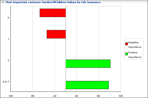

We can further analyze the importance of the NumberOfChildren attribute for the Life Insurance offer by viewing reports specific to this offer. In the navigation box in Decision Center, expand the Cross Selling Offer Choice Group and click the choice Life Insurance, then click the Analysis tab and finally the Drivers tab. This report shows the important drivers for acceptance of this particular offer (Life Insurance).
In the Report Settings section, change the Minimum Predictiveness value to 0 and then click Go. You will see a list of attributes, ordered by the Predictiveness value. The NumberOfChildren attribute should have the highest predictiveness value. Click the attribute name to display more detailed reports, one of which should look similar to Figure 5-10.
Figure 5-10 Life Insurance Offer Analysis Drivers
Description of Figure 5-10 follows
Description of "Figure 5-10 Life Insurance Offer Analysis Drivers"
The graph shown in Figure 5-10 shows that for NumberOfChildren values of 2 and above, there is a strong positive correlation for offer acceptance. This means that the number of acceptances of this offer for these attribute values (2 or more) is much higher than expected. Similarly, for values of 0 or 1, the correlation is also very strong, but is negative, meaning that customers with 0 children or 1 child did not accept Life Insurance as much as expected.
