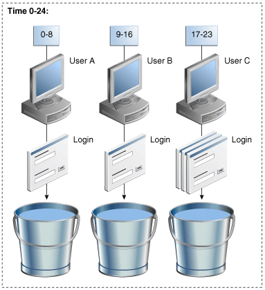

Bucket Creation and Population

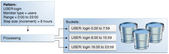

Figure 17-1 shows a bucket creation and population example.
Figure 17-1 Login Times
This diagram illustrates pattern usage

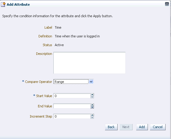

If you want to track employee login times, you would:
  • Set up a pattern where the member type is User and the attribute is Time.
  • Choose multi-bucket as the creation method for the pattern. A multi-bucket pattern creates as many buckets as required to capture behaviors as opposed to a single-bucket pattern which only creates one to capture a specific behavior.
  • Set start time=0:00 and end time=23:59, which are the hours of the day, and a increment step size of 8 hours.
During the processing of the transaction/login data, Oracle Adaptive Access Manager creates the buckets as required and populates them with counts for each member. Each bucket automatically keeps from overlapping with each other based on the other buckets already in the system. As shown in Figure 17-1, Oracle Adaptive Access Manager builds a maximum of 3 buckets with 8-hour periods in which logins have occurred.
For example, if Jeff logs in at 8:27, his counter in the 7:00 and 14:59 bucket is incremented by one. If no user has ever logged into this system between 7:00 and 14:59 then Oracle Adaptive Access Manager also creates that bucket as part of the processing. This 7:00 and 14:59 bucket then is used to record login time behavior for all users going forward.
After creation, the buckets are populated with the logins of users that have fallen within each 8-hour time range.
Oracle Adaptive Access Manager only records that Jeff used this computer if he logs in successfully. This validates that what is recorded is most likely Jeff's real behavior and not a fraudulent attempt to log in using Jeff's credentials. The memberships and associated statistics are saved in each user profile.

  • Multi-Bucket
    Multi-bucket patterns usually create more buckets than single-bucket patterns. They create buckets as required based on the parameter configurations.
    You configure the data types and samples you want Oracle Adaptive Access Manager to generate buckets from, and then during pattern processing Oracle Adaptive Access Manager creates buckets as needed to capture behaviors.
    For example:
    • If you specify "For each" as the compare operator and country as the attribute, Oracle Adaptive Access Manager creates a bucket dynamically for each country as activity occurs from the country. The first time any user logs in from Canada, Oracle Adaptive Access Manager creates a Canada bucket and adds that user as a member with a count of one. The next user to log in from Canada is added to that same bucket as a member with a count of one. Each subsequent time a user logs in from Canada his Canada bucket counter is incremented.
      Figure 17-3 Countries Multi-Bucket
      This diagram illustrates multi-buckets
    • Buckets are not created until they are needed. If you choose user logins for a 24-hour range with an increment step size of 8 then up to 3 buckets are created, one for each 8-hour time slot in which logins occur.
      Figure 17-4 Time Multi-Buckets
      This diagram illustrates multi-buckets.

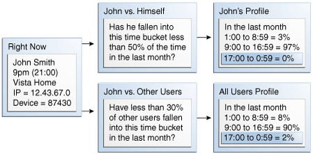

17.1.5 Pattern Rules Evaluations
OAAM uses patterns and the buckets they generate to capture the frequencies at which specific behaviors occur for each individual user, device, location, and so on. Since the pattern buckets are updating in real-time rules can be run against them to dynamically determine if the current behavior seems abnormal. The rules evaluations can view either the individual's current behavior versus his past behavior or the individual's current behavior versus the past behavior of all individuals.
The Autolearning feature tracks transactions and authentications being performed by different actors (entities) based on patterns you create. This process establishes what is normal or average behavior for an individual or a population.
Figure 17-5 Bucket Evaluation
This diagram illustrates bucket evaluation
In this example John's login behavior is being evaluated against his own profile and the profile of all users.
Bucket Evaluation Example
In this example a pattern was created to capture user, device and IP login time behavior. The multi-bucket pattern was configured to create buckets to cover the entire 24 hours of the day in four hour samples. Consequently, OAAM ended up creating four time buckets as login activity occurred within each time range.
Buckets Time Range
Bucket #1 0:00 to 4:59
Bucket #2 5:00 to 8:59
Bucket #3 9:00 to 16:59
Bucket #4 17:00 to 23:59
After a month of recording, the system has created four time buckets and populated them with members and counters for each member. The three entities now have the following bucket memberships.
Entity Membership
User A #3
Device X #2, #3, #4
IP Y #2, #3
Evaluation of the memberships produces the following conclusions:
These scenarios are not a sequence; each is a distinct scenario.
Scenarios Risk
If User A logs in at 3:37 using Device X from IP Y very high risk (none are in #1)
If User A logs in at 18:07 using Device X from IP Y medium - high risk (device in #4)
If User A logs in at 8:27 using Device X from IP Y medium risk (device and IP in #2)
If User A logs in at 11:15 using Device X from IP Y very low risk (all in #3)
The following paragraph describes the first scenario in more granular detail.
If User A logs in at 3:37 and he has previously only logged in between 9:00 and 16:59 that elevates the risk because he is not a member of the Bucket #1. If Device X is used and it has previously only been used between 5:00 to 23:59 that elevates the risk because User A and Device X are not members of Bucket #1. And, if IP Y is used and it has previously only been used between 5:00 to 16:59 that elevates the risk as well since User A, Device X, and IP Y are all not members of Bucket #1. Since all three of the major components involved in the risk evaluation are not in bucket #1 the overall risk level is very high. It is important to emphasize that each of these elements is evaluated for membership in the time profiles independently in this example.

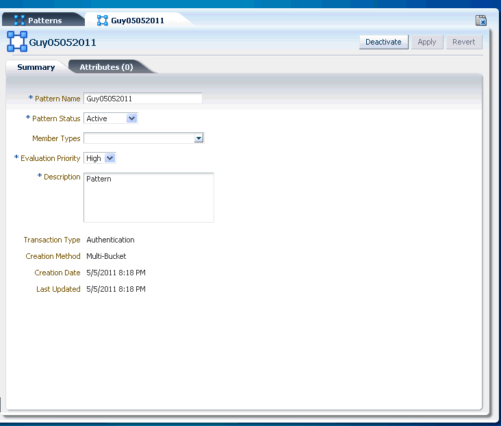

17.4.1 Creating a New Pattern
These steps describe the Create New Pattern flow:
  1. Search for a pattern.
  2. If pattern exists, view pattern details.
  3. If pattern does not exist, create new pattern.
  4. Specify pattern name, member type, evaluation priority, and description.

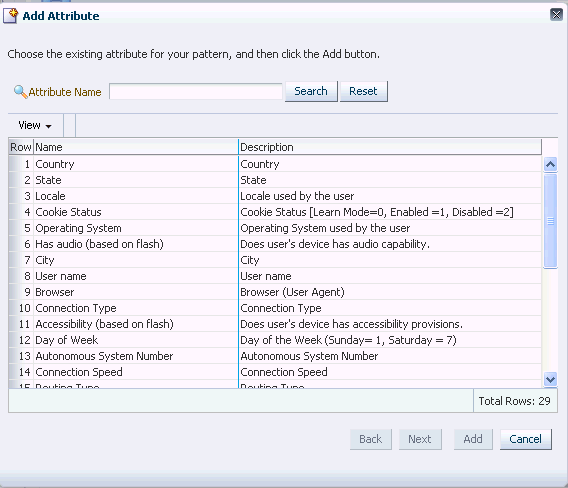

  5. Add attributes.
    If there are no validation errors, the new Pattern is created successfully.

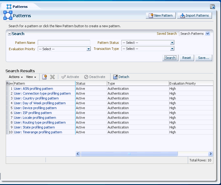

17.5 Navigating to the Patterns Search Page
To navigate to the Patterns Search page:
  1. In Fraud Prevention, expand the Navigation tree.
  2. Double-click Patterns.
    The Patterns Search page is displayed with results based on the default search criteria.
    Alternative methods to open the search page are listed in Section 3.9, "Search, Create, and Import."
The Patterns Search page is the starting place for managing your patterns. From the Patterns Search page, you can:
17.6 Searching for a Pattern
To search for a Pattern:
  1. Navigate to the Patterns Search page, as described in Section 17.5, "Navigating to the Patterns Search Page."
    An example Patterns Search page is shown in Figure 17-6.
    Figure 17-6 Patterns Search Page
    The pattern search page is shown.
    The Pattern Search page displays a Search section and a Results table that shows a summary of the patterns that match your search criteria.
  2. Specify criteria in the Search Filter to locate the pattern and click Search.
    The search filter criteria are described in Table 17-1.
    If you want to reset the search parameters to the default setting, use the Reset button.

The Search Results table displays a summary of patterns that match the criteria specified in the Evaluation Priority, Pattern Name, Pattern Status, and Transaction Type fields.
If you want the summary to include the creation method, select Creation Method from the additional fields list under the View drop-down list.
Clicking the Pattern column header sorts all the pattern names in ascending or descending order. Sorting is available for all columns.
A tool tip is available to display the complete description of a pattern if the description is not shown fully in the user interface.

  8. Enter a description.
  9. Click Apply.
    Figure 17-7 New Pattern
    The pattern summary tab is shown.
    The Pattern Details page is opened with the Summary and Attributes tabs.
    If you try to create a pattern that already exists in the database, an error occurs.
    If you try to create a pattern with the same members as another pattern, a message appears: "A pattern with the same member configuration already exists. Are you sure you want to create a new pattern? If you answer "yes," you are allowed to create the pattern.
    The pattern is enabled upon creation and the Pattern Details page is displayed. You can edit or review the pattern.

17.9.2 Adding Attributes
For information on attributes, see Section 17.1.3, "Member Types and Attributes."
Follow these steps to add attributes.
  1. If you are not on the Pattern Details page of the pattern, follow the instructions in Section 17.8.1, "Viewing Details of a Specific Pattern."
  2. In the Attributes tab, click the Add button in the Search Results toolbar.
  3. In the Add Attributes dialog, select an attribute or attributes from the Add list.
    Select attributes (data points) you are interested in for the member type. OAAM collects data on the attributes to determine if the member belongs to the profile.
    For example, if you select "user" as the member type and the attributes: IP (NNN.N.N.N), City (Redwood City) and Is Registered (False); OAAM records when users match all of these attributes--the user has an IP address of NNN.N.N.N, who lives in Redwood City, and who is not registered. This profiling can then be used to evaluate risk for the "user."
    For example, if you want OAAM to track the login times for "user" and "IP" (member type), you would select "time" as an attribute.
    After the attributes are added, they are not available in the list for further selection.
  4. Specify the condition information for the attribute.
    1. Select the Status.
      For example, "Active" if you want OAAM to collect data on the attribute to be used in the pattern membership.
    2. Enter the description.
      For example, "This pattern creates buckets to track login times for users and IPs."
    3. Select a compare operator.
      For example, "range" with start value of 0 and end value of 23 if you want to collect data for a range of 24 hours.
      The list of compare operators depends on the value of the attribute and the type of pattern (multi-bucket or single bucket) you have chosen.
      For detailed information about compare operators, see Section 17.19, "Pattern Attributes Operators Reference."
    4. Enter Increment Step.
      The sample size (interval)
      For example, 2 for 2 hour intervals.
    5. Click Add.

  2. In the Patterns Search page, enter the search criteria you want and click Search. For information, see Section 17.6, "Searching for a Pattern."
  3. Select the row for each pattern you want to export.
  4. Select Export Selected from the Actions menu.
  5. In the Export Patterns dialog, click Export.
  3. Select the row for each pattern you want to delete and press the Delete button.

17.13.3 Use Case: Track Off-Hour Access
Jeff is a Security Administrator at Dollar Bank. He wants to track off-hour access by employees based on a standard day shift. To do this, he must create a pattern for behavior-based profiling on time.
The pattern profiles the login times of users into three 8-hour buckets.
Figure 17-9 Using Buckets to Track Off-Hour Access
This illustrates the use of buckets to track time
  2. In the Patterns Search page, click the New Pattern button.
  3. In the Create Pattern dialog, enter the Pattern name: "User: Work hours."
  4. Select Authentication as the transaction type.
  5. From the Creation Method list, select Multi-Bucket.
  6. Select User as the Member Type.
  7. Select First as the Evaluation Priority.
  9. Click OK.
    A confirmation is displayed.
  10. Click OK.
    The Pattern Details page appears.
  11. Click the Attributes tab.
    On this tab you can add/edit the attributes of the users behaviors to be tracked. Choose from available attributes shown in the dropdown list.
  12. In the Attributes page, click the Add button.
  13. In the Add Attributes dialog, select Time from the available attributes shown in the drop-down list.
  14. Edit the attribute details.
    1. Select Active as the Status.
      For example, "This creates three 8-hour buckets."
    3. Select a compare operator range with start value of 0 and end value of 23.
    4. Enter 8 as the Increment Step.
    5. Click Add.
  15. Click Apply.
OAAM creates buckets as needed for the behavior.

17.19.12 Range
Range is usually used with numerics.
Figure 17-10 Range Compare Operator
The range attribute dialog is shown.
17.19.12.1 Fixed Range
When the user enters values for Start Value and End Value and leaves the Increment Step value as 0, he wants to create a bucket for the activity when the attribute value is Greater Than Equal To the Start Value and Less Than Equal To the End Value. Using the Day of Week example, if the user enters 1 (Sunday) as the Start Value and 5 (Thursday) as the End Value, all the logins from Sunday (day=1) through Thursday (day=5) will result in the creation and updates to the count of a single bucket. A fixed range is when the upper and lower limit are fixed and there are no steps "in between" (the increment step is not entered by user).
17.19.12.2 Fixed Range with Steps (or Increment)
When the user enters values for Start Value and End Value and also provides a value for the Increment Step, he wants to create a bucket for the activity when the attribute value is Greater Than or equal to the Start Value and Less Than Equal To the End Value and he wants to create finer level buckets which are separated by the "increment" value of the attribute. Using the Day of Week example, if the user enters 1 (Sunday) as the Start Value and 5 (Thursday) as the End Value and the Increment Step as 1, all the logins from Sunday (day=1) through Thursday (day=5) will result in the creation and updates to the count of multiple buckets. A bucket will be created and updated for the day starting Monday and then for each day (since the increment is one).
17.19.12.3 Upper Unbound Ranges with Steps
Upper unbounded ranges with increment steps are used for items, such as numbers, such as amounts. Basically, multiple-tiered ranges can be configured.
For example you can configure
0 to 100 with Step 10.
101 to 1000 with Step 100.
1001 to 10000 with Step 1000.
10001 to ... with Step 10000.
All the ranges but the last one works the same way as the earlier range example with Start Value and End Value with Increment Step.
The last range works as if the upper limit is infinity. In this scenario, buckets are created for each 10000 (ten thousand) after 10001 (ten thousand one).
If a user has an amount of 200,123 (two hundred thousand 123), a bucket would be created for him for 200,000 through 210,000. His transaction for this amount will fall into this bucket.
