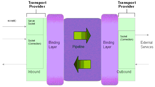

Figure 43-1 shows the basic architecture of the sample socket transport provider. Any client can connect to the server socket. Data is received at the server socket and passes through the pipeline. The response comes back through the outbound transport. The response is finally sent back to the inbound transport and back to the client.

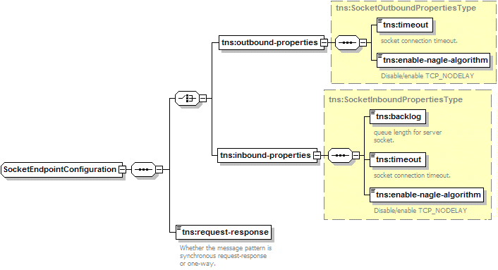

Figure 43-2 illustrates the configuration properties for the transport endpoint. These properties are configured in the schema file: SocketTransport.xsd. See Section 43.2, "Sample Location and Directory Structure" for information on the location of this file. This file allows you to extend the basic set of properties defined in the common schema provided with the SDK. Refer to the SocketTransport.xsd file for information on each of the properties.
 Tip: See also Section 40.3.4, "4. Define Transport-Specific Artifacts," for more information on these configuration properties. |
Figure 43-2 SocketEndpointConfiguration Properties

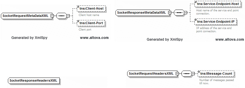

Also in the SocketTransport.xsd file are the request/response header and metadata properties, as illustrated in Figure 43-3. Refer to the SocketTransport.xsd file for more information on these properties.
Figure 43-3 Request/Response Header and Metadata Configurations

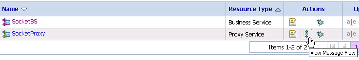

In the Resources section, click the View Message Flow icon in the SocketProxy row, as shown in Figure 43-4.

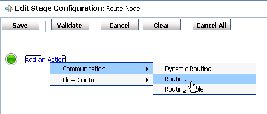

In the Edit Stage Configuration window, click Add an Action.
In the Route Node window, click Add an Action and select Communication > Routing from the menu, as shown in Figure 43-6.

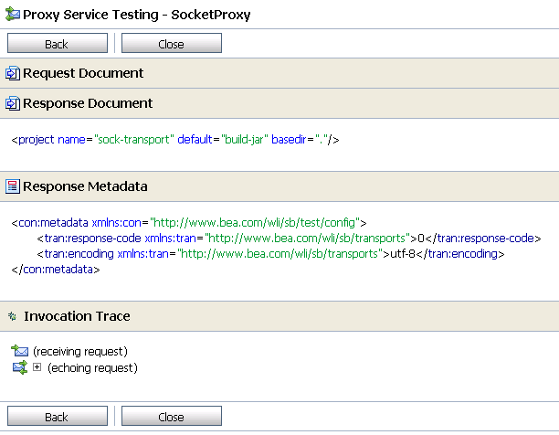

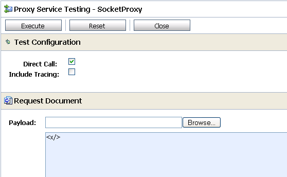

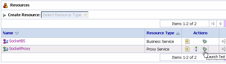

In the SocketProxy row of the Resources table, click the Launch Test Console icon, as shown in Figure 43-7.
In the Test Console, enter any valid XML stanza in the text area, or use the Browse button to select a valid XML file on the local system. For example, in Figure 43-8, a simple XML expression <x/> is entered in the text area.
Click Execute. If the test is successful, information similar that shown in Figure 43-9 appears in the Test Console. In addition, the XML text input into the Test Console is echoed in the server console.
