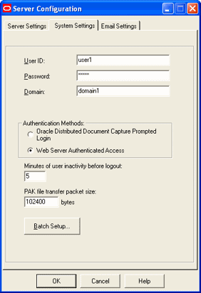

Set Oracle Distributed Document Capture for automatic login (optional).
On the System Settings tab of the Distributed Document Capture Server Configuration application shown in Figure 6-1, select Web Server Authenticated Access from the Authentication Methods options. This setting enables the client to launch automatically without users needing to log in. For details, see the section on authentication in the Installation Guide for Oracle Distributed Document Capture.

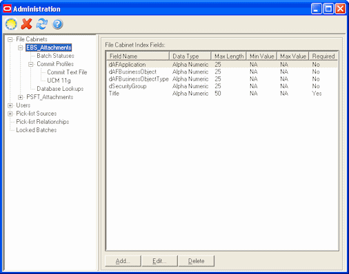

In Capture Administration, add index fields to a selected file cabinet for capturing values for new documents, as shown in Figure 6-2. For details, see the section on Capture Administration in the Administrator's Guide for Oracle Distributed Document Capture.
Create index fields for values you want saved with attached documents on the Content Server. For example, you might configure a Doc Type pick-list index field for users to select from standard document types.
Create the following alphanumeric index fields to contain the business application entity values and required fields:
dAFApplication
dAFBusinessObjectType
dAFBusinessObject
dSecurityGroup
Title

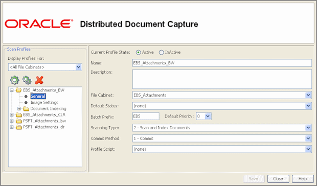

In Oracle Distributed Document Capture's Profile Administration, create a scan profile, as shown in Figure 6-3. You later associate this scan profile with one or more document classifications, so that when a user selects a classification, the associated scan profile's settings are used. For details, see the section on scan profiles in the Administrator's Guide for Oracle Distributed Document Capture.
On the General pane, select 2 - Scan and Index Documents in the Scanning Type field. This scanning type includes indexing, and scans or imports pages into a single document in a batch. Specify a file cabinet and batch prefix.

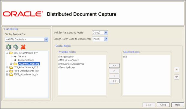

On the Document Indexing pane, move all fields you want displayed to users to the Selected Fields box. It is recommended that you display the Title field for users to enter, and make the field required.
Note: Typically, you would not select the business application entity fields (dAFBusinessObject, for example) for display to users. If you choose to display them, lock them on the Field Properties pane to prevent users from changing their values. |

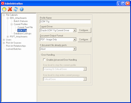

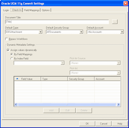

In Capture Administration, create an Oracle UCM 11g commit profile to commit the scanned or imported documents to Oracle UCM when users send a completed batch.
This commit profile specifies how to connect to the Content Server and how the business application and Capture values are passed to the Content Server. For information about creating Oracle UCM commit profiles, see the section on committing profiles in the Administrator's Guide for Oracle Distributed Document Capture.
Select Oracle UCM 11g Commit Driver in the Commit Driver field. For this integration, it is recommended that you select PDF - Image Only in the Document Output Format field. Click the Configure button adjacent to the Commit Driver field.
On the Login tab, specify settings for logging in to the Content Server instance. (The other tabs become active after you log in.) Use the following format for the Content Server URL:
http://UCM host name or IP address:WebServerPort/ucm web root/idcplg
The specified Content Server user must be assigned the AFWrite role for the AFDocuments security group. It is recommended that you create a special Capture user specific to the Managed Attachments Solution for this purpose to ensure regular users do not gain write access to the AFDocuments security group, which is reserved for the Managed Attachments solution.

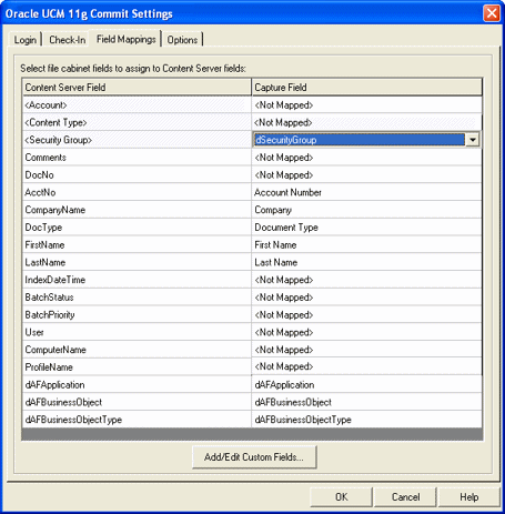

On the Check-In tab, choose Assign values dynamically and By Field Mappings fields, as shown in Figure 6-6. Also specify how you want documents named in the Document Title field. It is recommended that you use the Title field.

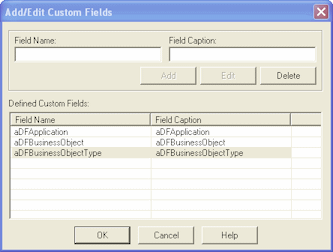

On the Field Mappings tab, click the Add/Edit Custom Fields button, and add the following custom fields in the Add/Edit Custom Fields screen shown in Figure 6-7:
dAFApplication
dAFBusinessObject
Click OK. The custom fields you added now display on the Field Mappings tab shown in Figure 6-8. Map these custom fields to the corresponding index fields you created in step 2, as they are required to attach the new Oracle UCM document to the business application entity. Also map other Capture fields whose values you want written to Content Server fields. Click OK.

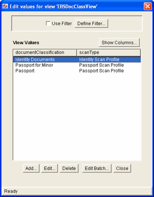

On Content Server, configure document classification and scan types.
From the Administration tray in Content Server, click the Admin Applets link.
Select the Configuration Manager applet. The Configuration Manager displays.
Click the Views tab, select the appropriate document classification view from the alphabetical list (EBSDocClassView for Oracle E-Business Suite or PSFTDocClassView for Oracle PeopleSoft), and click Edit Values.
In the Edit Values screen, click Add and add document classifications and their corresponding scan profile. Note that documentClassification entries must be unique, but a scan profile can be used multiple times. Click Close when done.
From the Options menu, select Publish schema to publish the data.
