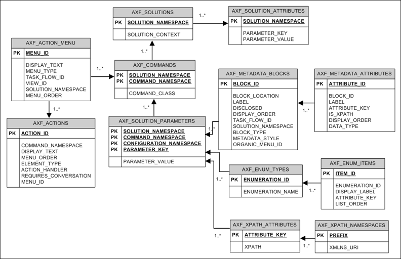

The diagram that follows displays the AXF configuration tables and their relationships.

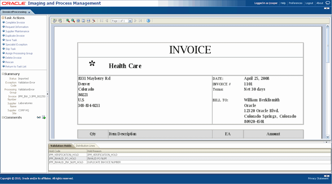

Use this table to insert and customize an action menu on an AXF web page such as the Task Viewer or Task List screen. A common use is to display a Task Actions pane in the Task Viewer for users to click action links related to the displayed task, as shown in Figure A-2. Use the AXF_ACTIONS Table to define a specified menu's actions.
Table A-9 Column Description for AXF_ACTION_MENU Table
| Column | Description |
MENU_ID |
Specifies a primary key to the AXF_ACTIONS Table, identifying the menu in which to place menu actions. |
DISPLAY_TEXT |
Specifies the pane's title (for example, Task Actions, Shortcuts, or Re-Assignments). |
MENU_TYPE |
Specifies where on the screen the menu is displayed and its type. (LEFT_SIDEBAR displays a side pane leftmost on the screen.) |
TASK_FLOW_ID |
Specifies the active task flow with which to associate the menu. For example, to add a side menu to a task list display, specify a value of |
VIEW_ID |
(Reserved for future use.) |
SOLUTION_NAMESPACE |
Identifies the AXF solution, as defined in the AXF_SOLUTIONS Table. |
MENU_ORDER |
Defines the order in which the menu is displayed when multiple menus are set for display. |
This table defines the task actions used in an AXF solution. You can display action menus on AXF web pages such as the Task Viewer page (see Section A.2.2) or a Task List (see Section A.2.1). This table links to the AXF_COMMANDS Table.

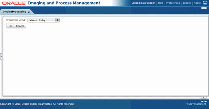

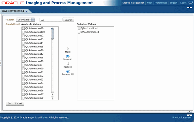

This example follows an XPATH attribute specified for an AssignProcessingGroupEdit command in the AXF_SOLUTION_PARAMETERS table. The PARAMETER_VALUE column contains an XPATH: prefix, indicating that the attribute value comes from the AXF_XPATH_ATTRIBUTES table.
Fields not shown: SOLUTION_NAMESPACE=InvoiceProcessing
Table A-14 Example AXF_SOLUTION_PARAMETERS Table
| COMMAND_NAMESPACE | CONFIGURATION_NAMESPACE | PARAMETER_KEY | PARAMETER_VALUE |
AssignProcessingGroupEdit |
oracle.imaging.axf.web.EnumerationPicker |
ATTRIBUTE_NAME |
XPATH:InvoiceProcessing_ProcessingGroup |
In the AXF_XPATH_ATTRIBUTES table that follows, the corresponding XPATH column displays the XPATH expression used to locate the value in the payload.

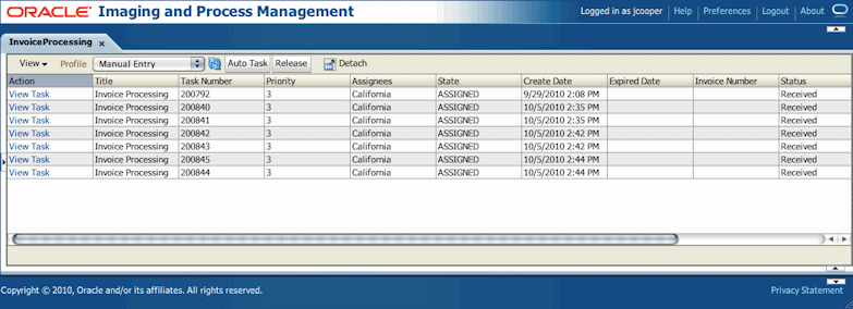

The AXF Task List web tool is a reusable web interface for displaying human workflow tasks controlled by an AXF solution.
Task List Features
The Profile list uses standard BPEL views to restrict the task list view based on user/group, BPEL Process versions, and BPEL payload attribute values. (Use the BPM Worklist application to create views and share them with other users or groups.)
Users can select a task from the table by clicking its View Task link, which retrieves the workflow task from a specified BPEL server and process, claims it and displays it in the Task Viewer. After users complete the selected task, they return to the Task List.
When autotask mode is selected, the AXF solution automatically claims and opens tasks as users complete them, until all of a user's tasks have been processed or the user chooses to stop processing tasks by returning to the Task List. Users activate autotask mode by clicking Auto Task.
Users can release an assigned task by clicking the Release button. The task is then released back into the pool of available tasks. If the user clicks Release but did not previously acquire the selected task, a message indicates that the task cannot be released.
You can configure the Task List to include a side pane action list with links.

The AXF Task Viewer web tool is a reusable web interface that displays the content associated with a Human Workflow Task. In a typical configuration, a business user displays the Task Viewer on one monitor, and keys values shown in the image into a business application on another monitor.
You can customize the web page through database configuration.
Task Viewer Features
Users view Oracle I/PM image documents in the Image Viewer pane, using either the basic or advanced Oracle I/PM viewer mode. The Task Viewer uses the Oracle I/PM viewer tool to render image documents.
If configured, users can select actions in the side Task Actions pane, which invoke a solution's AXF commands. You enable the Task Actions pane in the AXF_ACTION_MENU Table, configure the action links to invoke AXF commands in the AXF_ACTIONS Table, and the commands themselves in the AXF_COMMANDS Table. If autotask mode is selected, users disable it by returning to the Task List, typically by clicking a Return to Task List link in the Task Actions pane.
If configured, users can view a Summary section that displays metadata values about the task. You configure these items for display in the AXF_METADATA_BLOCKS Table and AXF_METADATA_ATTRIBUTES Table. You can also configure the section's title and the task payload values displayed.
If configured, users can view a Comments section that displays comment fragments and provides icons for displaying full comments or adding them for the task. You configure comments for display in the AXF_METADATA_BLOCKS Table.
If configured, users can view a dynamic data table (bottom tabs) from the BPEL payload XML, such as General Ledger lines for an invoice processing solution. You configure the table in the AXF_METADATA_BLOCKS Table and its data lines in the AXF_METADATA_ATTRIBUTES Table. For more information, see Section 5.4.7.

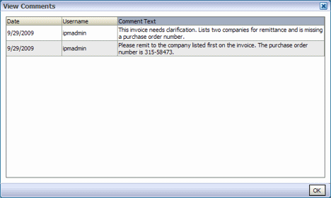

The Comments pane enables users to view and enter comments related to the human task during the transaction's processing. You configure comments in the AXF_METADATA_BLOCKS Table. Also see Section 1.2.4.5, "About Comments."
The Enumeration Picker web tool enables users to select a choice from a list of values configured in AXF tables. For example, the Enumeration Picker shown in the graphic that follows displays a Processing Group dropdown field containing North, South, East, and West values.
After the user selects a value, the value is updated into the BPEL payload before the configured command executes, typically a command to return to the Task Viewer or to complete the command.

The Identity Picker web tool enables users to select one or more users or groups from an identity store configured for BPEL. Typically, a related action is taken after choosing an identity; for example, a task is assigned or delegated. The action to take after selecting an identity is configured in the AXF_SOLUTION_PARAMETERS Table.
Note: The command updates the task payload when the user clicks OK. The BPEL process is responsible for using this information to delegate the task. |
Note: The Filter and Search Attribute settings use the BPEL Worklist views configuration. To change these settings, use the BPEL Workflow application. |
Table A-31 Identity Picker Parameters in AXF_SOLUTION_PARAMETERS Table
| Parameter Key | Description |
CMD_ON_CANCEL |
Specify the command (COMMAND_NAMESPACE) to execute when a user clicks the Cancel button on the Identity Picker page. |
CMD_ON_OK |
Specify the command (COMMAND_NAMESPACE) to execute when a user clicks the OK button on the Identity Picker page. |
IDENTITY_FILTER |
Define how the identity picker searches, where:
Note: Specify USER or GROUP for a command. To allow both search types, create an additional command that uses the other type to open the identity picker. For example, you might create AssignByGroup and AssignByUser commands. |
IDENTITY_ATTRIBUTE |
This attribute is updated in the BPEL task when a user clicks OK on the Identity Picker page. The Attribute value is a constant as defined under System Attributes; see Section A.3.6.2. If the value has an XPATH: prefix, then the value comes from the AXF_XPATH_ATTRIBUTES Table and it is the XPATH to update the value in the task payload. |
This example shows an InvoiceApprovalEdit command that searches for user information stored in BPEL, and updates the BPEL task using an XPATH variable.
Table A-32 Example Identity Picker Parameters in AXF_SOLUTION_PARAMETERS table
InvoiceApprovalEdit |
oracle.imaging.axf.web.backing.IdentityPicker |
IDENTITY_FILTER |
USER |
CMD_ON_CANCEL |
OpenTask |
XPATH:InvoiceProcessing_InvoiceApprovalAssignment |

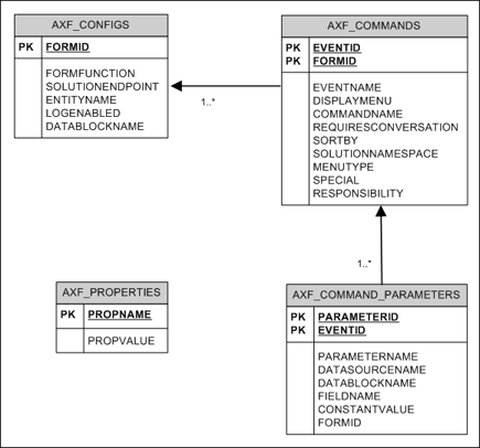

Configuring AXF for Oracle E-Business Suite requires configuring AXF-related tables in Oracle E-Business Suite. This section covers the following topics:
Section A.4.1, "About the Oracle E-Business Suite AXF Tables For the Imaging Solution"
Section A.4.2, "AXF_CONFIGS Table (Oracle E-Business Suite)"
Section A.4.3, "AXF_COMMANDS Table (Oracle E-Business Suite)"
Section A.4.4, "AXF_COMMAND_PARAMETERS Table (Oracle E-Business Suite)"
Section A.4.5, "AXF_PROPERTIES Table (Oracle E-Business Suite)"
The following diagram shows how the tables used by the Oracle E-Business Suite system in AXF solutions are related.
Use the AXF_CONFIGS table to enable the AXF solution on various Oracle E-Business Suite Forms. This table provides a fine level of granularity when selecting which Forms to AXF-enable, up to the Data Block level.

Use the AXF_COMMANDS table to describe the actions to take based on user activity. This table works with the AXF_CONFIGS Table (Oracle E-Business Suite).
Table A-51 Column Description for AXF_COMMANDS Table

Use the AXF_COMMAND_PARAMETERS table to define the information sent for each defined command. Each command may require or omit a different set of parameters.
Table A-53 Column Description for AXF_COMMAND_PARAMETERS Table
