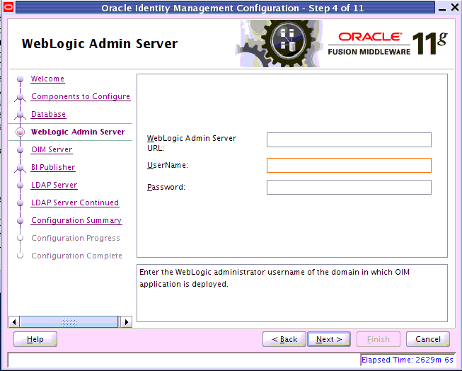

In this screen, you specify the t3 URL, user name and password for the WebLogic administration domain in which the Oracle Identity Manager application is deployed. Ensure that the Administration Server is up and running.
In the WebLogic Admin Server URL text box, enter the t3 URL of the Administration Server for the WebLogic domain in the following format:
t3://hostname:port
In the UserName text box, enter the WebLogic Administrator user name.
In the Password text box, enter the WebLogic Administrator password.
After entering information in the fields, click Next to continue.
