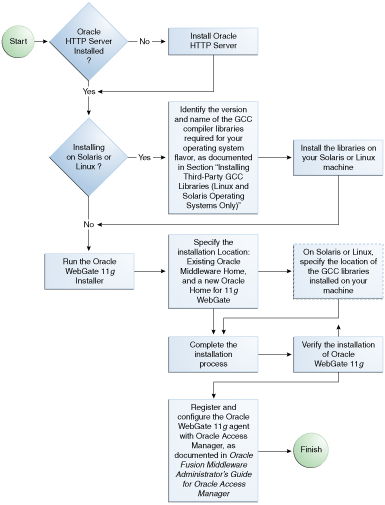

The following figure illustrates the process of installing Oracle HTTP Server 11g Webgate for Oracle Access Manager.
Figure 20-1 Oracle HTTP Server 11g Webgate Installation Process
Surrounding text describes Figure 20-1 .
