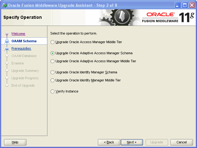

The Specify Operation screen is displayed, as shown in Figure 12-2.
Figure 12-2 Upgrade Assistant Specify Operation Screen
Select the Upgrade Oracle Adaptive Access Manager Schema option.
Click Next.

To verify that your Oracle Adaptive Access Manager upgrade was successful:
Run Upgrade Assistant again, and select Verify Instance on the Specify Operation page.
Follow the instructions on the screen for information about how to verify that specific Oracle Fusion Middleware components are up and running.
