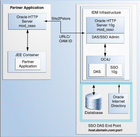

Oracle Single Sign-On 10g Infrastructure Before Upgrade
Figure 11-1 illustrates the Oracle Single Sign-On 10g topology, which is the starting point for upgrading to Oracle Access Manager 11g.
Figure 11-1 Oracle Single Sign-On 10g Infrastructure
The topology comprises the following:
Partner applications in a JEE container front-ended by Oracle HTTP Server to communicate with the Oracle Single Sign-On infrastructure
Oracle Identity Management infrastructure that includes the Oracle HTTP Server 10g front-ending the Oracle Delegated Administration Services application and the Oracle Single Sign-On Server
The Oracle Single Sign-On endpoint, which consists of a host name and a port number, represents the URL that Oracle Single Sign-On users can use to access the Oracle Single Sign-On Server and the Oracle Delegated Administration Services application.
An example Oracle Single Sign-On endpoint is host.domain.com:port.
Note: This example is used in this section to illustrate different upgrade scenarios and their Oracle Single Sign-On endpoints. |

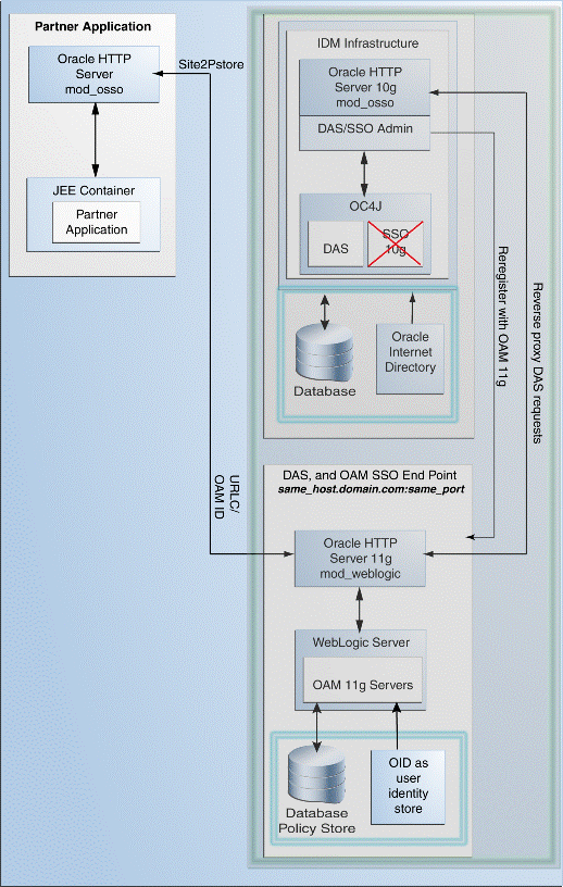

Oracle Delegated Administration Services Required After Upgrading from Oracle Single Sign-On to Oracle Access Manager
Use this upgrade scenario if you want to continue to use the Oracle Delegated Administration Services application and the Oracle Single Sign-On Admin tool after upgrading from Oracle Single Sign-On 10g to Oracle Access Manager 11g. Figure 11-2 illustrates the scenario.
Note the following points when using this upgrade scenario:
Use this scenario if you are using Oracle Portal, Oracle Forms, Oracle Reports, or Oracle Discoverer partner applications because you require Oracle Delegated Administration Services and Oracle Single Sign-On Admin. Upgrade all partner applications at once.
The Oracle Delegated Administration Services application runs on a new port.
Any Oracle Delegated Administration Services requests from partner applications, such as Oracle Portal, arrive at the Oracle HTTP Server 11g and redirected to Oracle HTTP Server 10g, which front-ends the Oracle Delegated Administration Services 10g application. The Oracle HTTP Server 11g front-ends Oracle Access Manager 11g. Such requests are redirected to Oracle HTTP Server 10g port, which front-ends the Oracle Delegated Administration Services 10g application.
Note: You must reregister Oracle Delegated Administration Services and Oracle Single Sign-On Admin with Oracle Access Manager 11g because their port is changed. |
You are using the same OHS 10g port that front-ended Oracle Single Sign-On 10g as the new port for Oracle Access Manager 11g. Therefore, the Oracle Single Sign-On 10g server goes down.
The Oracle Single Sign-On-Oracle Delegated Administration Services endpoint (same_host.domain.com:same_port) remains the same for all the partner applications.
After you perform the upgrade, Oracle Internet Directory is selected as the user identity store automatically.
Figure 11-2 Oracle Delegated Administration Services Required After Upgrading from Oracle Single Sign-On
To use this upgrade scenario, follow the steps listed in Table 11-1.

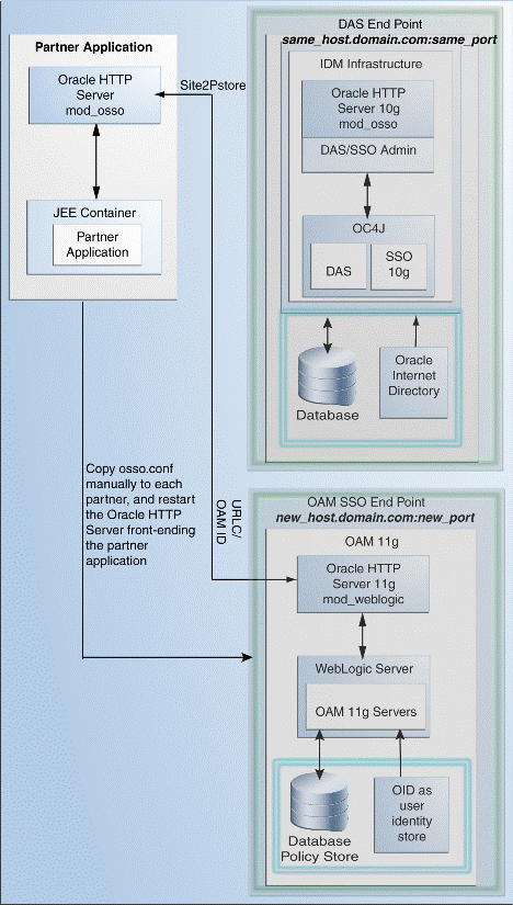

Oracle Delegated Administration Services Required, but Oracle Single Sign-On Admin Not Required After Upgrading from Oracle Single Sign-On to Oracle Access Manager 11g
Use this upgrade scenario if you do not require the Oracle Single Sign-On Admin tool application, but you require the Oracle Delegated Administration Services application after upgrading from Oracle Single Sign-On 10g to Oracle Access Manager 11g. Figure 11-3 illustrates the scenario.
You are using the OHS 10g port for Oracle Delegated Administration Services. Therefore, you must install Oracle Access Manager 11g on a different machine.
Upgrade your partner applications in a phased manner.
Oracle Single Sign-On will no longer work after the upgrade. However, Oracle Delegated Administration Services will continue to work.
You must copy the osso.conf files generated during the upgrade manually for each OHS/mod_osso fronting a set of partner applications. This step associates these applications with Oracle Access Manager as their new Oracle Single Sign-On provider. This step is also necessary for Oracle Delegated Administration Services.
The Oracle Delegated Administration Services endpoint (same_host.domain.com:same_port) remains the same for all the partner applications.
The Oracle Access Manager Oracle Single Sign-On endpoint is new, such as new_host.domain.com:new_port.
Figure 11-3 Oracle Single Sign-On Administration Server Not required

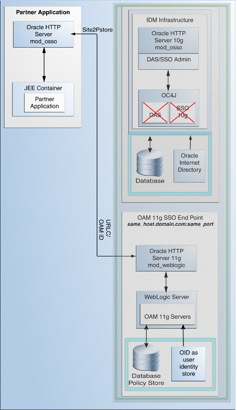

Oracle Delegated Administration Services Not Required After Upgrading from Oracle Single Sign-On to Oracle Access Manager
Use this upgrade scenario if you do not require the Oracle Delegated Administration Services application or the Oracle Single Sign-On Admin tool. Figure 11-4 illustrates the scenario.
Oracle Single Sign-On and Oracle Delegated Administration Services will no longer work after the upgrade.
You are using the same OHS 10g port that front-ended Oracle Single Sign-On 10g as the new port for Oracle Access Manager 11g. Therefore, the Oracle Single Sign-On 10g server as well as the Oracle Delegated Administration Services application cannot be accessed.
The Oracle Single Sign-On endpoint (same_host.domain.com:same_port) remains the same for all the partner applications.
Figure 11-4 Oracle Delegated Administration Services Not Required

Redirecting the Partner Application Request to Oracle HTTP Server 10g server
You must use mod_proxy to redirect the Oracle Internet Directory and Oracle Delegated Administration Services request to the Oracle HTTP Server 10g.
Open the Oracle HTTP Server 11g httpd.conf file in a text editor and add entries of OHS 10g host name and post name front-ending Oracle Internet Directory and Oracle Delegated Administration Services as shown in the following example:
ProxyPass /oiddas http://pdcasqa14-3.us.abc.com:8888/oiddas ProxyPassReverse /oiddas http://pdcasqa14-3.us.abc.com:8888/oiddas
Note: The above example is using the OHS 10g port number. |
Restart Oracle HTTP Server 11g by running the following opmnctl command:
OHS_INSTANCE_HOME/bin/opmnctl stopall OHS_INSTANCE_HOME/bin/opmnctl startall

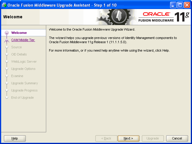

The Oracle Fusion Middleware Upgrade Assistant Welcome screen is displayed, as shown in Figure 11-5.
Figure 11-5 Upgrade Assistant Welcome Screen
Click Next.

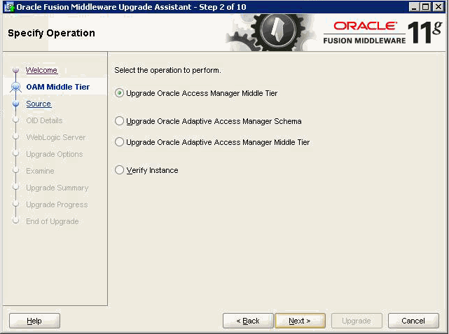

The Specify Operation screen is displayed.
Select Upgrade Oracle Access Manager Middle Tier.
The options available in Upgrade Assistant are specific to the Oracle home from which it started. When you start Upgrade Assistant from an Oracle Application Server Identity Management Oracle home, the options shown on the Select Operation screen are the valid options for an Oracle Application Server Identity Management Oracle home.
Click Next.
