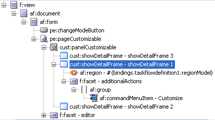

Right-click the first Show Detail Frame
in the Structure window, and select Facets - Show Detail Frame.
Click the arrow to the right of this option, and from the list of supported facets, select Additional Actions.
The f:facet-additionalActions
element for that facet is inserted in the page.
Add a Panel Group Layout inside the Additional Actions
facet, and add a Button component inside the Panel Group Layout
component.
Set the Text
attribute for the Button
to Customize
, and specify customize
as the Action
value.
The page in the structure navigator should appear as shown in Figure 21-1.

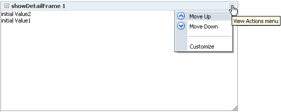

In JDeveloper, run Page1.jspx
. The Actions menu on the showDetailFrame1
component displays the Customize action, as shown in Figure 21-2.

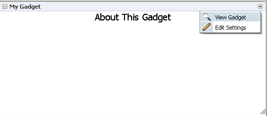

Save and run MyPage.jspx
The view_gadget
page fragment is rendered in the Show Detail Frame
component (named My Gadget) on the page. The Actions menu displays the About Gadget and Edit Settings options. Click About Gadget to navigate to the about_gadget
fragment. Note that the Actions menu now displays the navigation rules for the other two fragments (Figure 21-5).
Figure 21-5 Custom Actions on a Show Detail Frame Enclosing a Task Flow

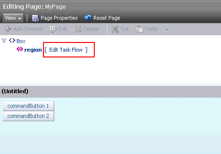

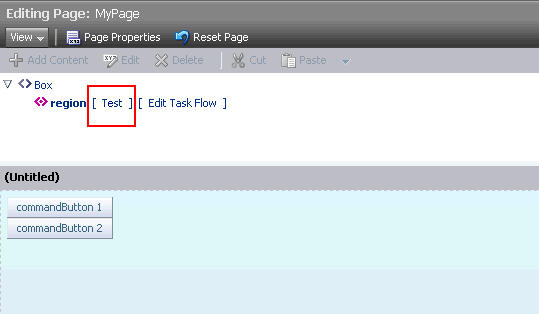

The component navigator in Oracle Composer Source view provides an option to zoom into a task flow and display the components on its page or fragment, as shown in Figure 21-6.
Figure 21-6 Edit Action on a Task Flow Instance
Users can zoom in, edit the page or fragment, and zoom out of the task flow to navigate back to the page containing the task flow. In addition to the Edit Task Flow and Close links displayed next to a task flow name, you can configure your application to also display custom actions next to a task flow name, as shown in Figure 21-7.
Figure 21-7 Custom Action on a Task Flow Instance
This section describes the procedure to enable custom actions on task flows in the component navigator. It contains the following sections:

This sample creates a custom action called Test

To ensure that the default Edit Task Flow/Close options are also displayed next to the task flow, you must define a facet called zoom
, as shown in the following example:

To display the custom action that you created, you must ensure that the customLink.jspx
page is called from within Oracle Composer. Use the sourceViewNodeAction
attribute on the Page Customizable
component to reference the JSPX page containing the custom action.
The Page Customizable
tag appears as follows in the page source:
<pe:pageCustomizable id="pageCustomizable1" sourceViewNodeAction="/customLink.jspx">
The sourceViewNodeAction
attribute can take the name of a JSPX file or an EL value that evaluates to a JSPX file name.
When you run MyPage.jspx
to the browser and open the page in Oracle Composer Source view, the component navigator displays a Test link and an Edit Task Flow link next to each task flow instance on the page. Figure 21-8 shows MyPage.jspx
in the component navigator, with the Test link highlighted. Clicking the Test link displays a sample message to the user.
Figure 21-8 Custom Action Displayed Against a Task Flow in the Component Navigator

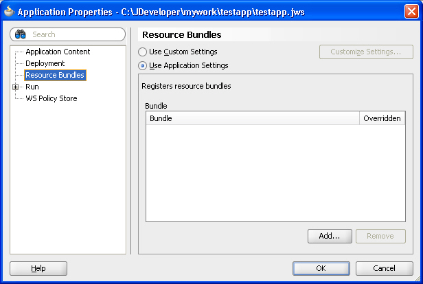

Form the Application menu, select Application Properties.
Select Resource Bundles in the left panel of the Application Properties dialog (Figure 21-11).
Figure 21-11 Application Properties Dialog
Click the Add button.

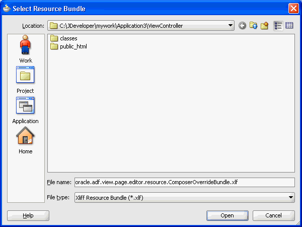

In the File Name field in the Select Resource bundle dialog, enter oracle.adf.view.page.editor.resource.ComposerOverrideBundle.xlf
, as shown in Figure 21-12, and click Open.
Figure 21-12 Select Resource Bundle Dialog
In the Application Properties dialog, select the Override check box.
This ensures that the file is available to users at runtime.
Click OK.
