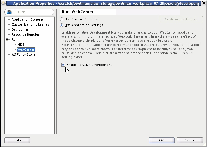

This section explains how to enable iterative development, if it has been disabled.
Note: The iterative development feature is enabled by default when you create a new WebCenter Portal application. |
Select Application Properties from the Application menu.
Along the left side of the Application Properties dialog, expand the Run node.
Select WebCenter.
Select Enable Iterative Development, as shown in Figure 1-1.
Figure 1-1 Enabling Iterative Development
Click OK.
