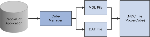

Defining Cognos PowerPlay Cube Instance Definition Options
This diagram shows both the optional and the required steps that enable Cube Manager to build a Cognos PowerPlay cube.
The .mdl and .dat files merge to create the PowerCube (.mdc file)
Note. Cube Manager and the enterprise server must be set up to run on the same machine.
