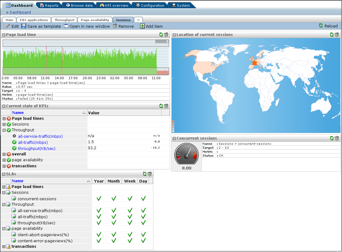

RUEI allows you to create a set of your own customized dashboards. A dashboard is a visual display of the most important information required to achieve an objective, consolidated and arranged on a single screen so that the information can be monitored at a glance. An example is shown in Figure 5-1.
Each of your currently defined dashboards is available via tabs at the top of the screen. The last tab (») provides an overview of the templates available to you to use as the basis for creating new dashboards.

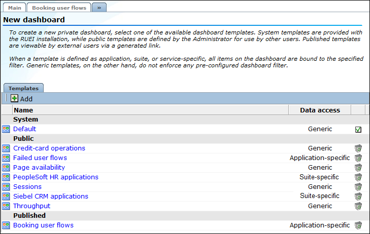

Dashboards are created based on templates. There are three types of templates: system, public, and published. System templates are provided with the product installation, and cannot be modified. However, they can be disabled. Public templates, on the other hand, are dashboard templates created and maintained by Administrators. They cannot be modified by any other user. Published templates are used to create dashboards that are viewable by external users via a generated link.

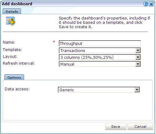

To create a new dashboard, do the following:
Click the Dashboard tab, and then click the last (») tab. The templates currently available to you are listed. An example is shown in Figure 5-2.
Figure 5-2 Example of Available Templates
Click the template you want to use as the basis for the new template. A dialog similar to the one shown in Figure 5-3 appears.
Specify a name for the new dashboard. This must be unique across your dashboards, and is limited to a maximum length of 30 characters.
Select the template upon which the dashboard should be based. Alternatively, select the option "(none)" for the dashboard to be created from scratch. Note there is no link between the newly created dashboard and the template upon which it is based. That is, any future changes to the template are not applied to any dashboards created from it.
Select the dashboard's format. This can be based on one, two, or three columns. The percentages indicate the amount of available screen space allocated to each dashboard column.
Select the refresh interval. This can either be manual (that is, the dashboard is only refreshed when you click the Reload icon on the taskbar), or automatic (every 5, 10, or 15 minutes).
Within the Options tab, the Data access menu specifies if the dashboard will be bound to a specific application, suite or web service, or if it will be generic. The options within these menus depends on your assigned access permissions. The use of dashboard filters is described in Section 5.4, "Using Data Access Filters".
When ready, click Save.
Each of your currently defined dashboards is available by clicking its associated tab within the Dashboard tab. You can also click the Open in a new window icon on the taskbar. This is useful for viewing dashboards in a full-screen display, or for viewing several dashboards at the same time through resized and aligned windows.
You can modify a dashboard's properties by clicking the Edit icon within the dashboard taskbar. A dialog similar to the one shown in Figure 5-3 appears. Use this dialog to modify the dashboard's underlying template, name, layout, and refresh interval. The dashboard's layout and filter (described in Section 5.4, "Using Data Access Filters") are also reported.
You can also add or remove items to and from a dashboard, as well as modify existing items. This is described in the following section.

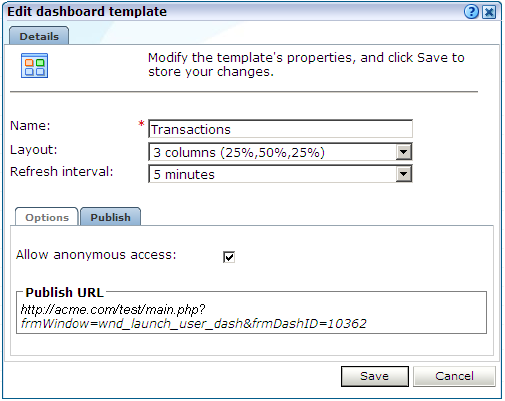

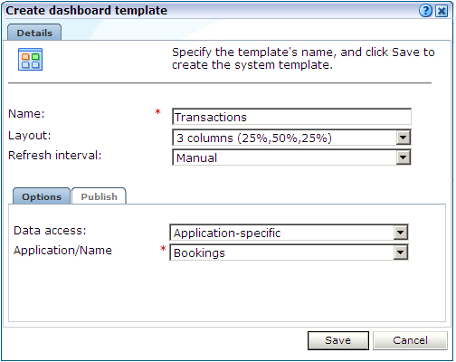

As explained earlier, public templates are created by Administrators for use by others users as the basis for their dashboards. To create a public template, do the following:
Click the Dashboard tab, then click an existing dashboard tab, and then click the Save as template icon on the taskbar. Note this option is only available to Administrators. The dialog shown in Figure 5-5 appears.
Figure 5-5 Create Dashboard Template Dialog
Specify a name for the new template. This must be unique across system templates.
Specify the template's format and refresh interval.
Within the Options tab, use the Data access menu to specify whether the template should be bound to a specific application, service, or suite. The use of filters is described in Section 5.4, "Using Data Access Filters".
In the case of an application or service-specific template, specify the application or service to which it should be bound. In the case of a suite-specific template, specify the suite type (for example, PeopleSoft), and the configured suite. Note the options available within the Suite type menu depends on the suite instances configured on your system.
Within the Publish tab, use the Allow anonymous access check box to specify whether external users can view the selected dashboard. If checked, copy and send the displayed link to the required users. Note that the use of this facility is fully described in Section 5.9, "Publishing Templates".
When ready, click Save. The newly created template immediately appears within the list of public templates. Access to the items on the template depends on the user's individual access permissions.

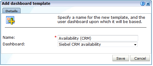

Sometimes, a user has created a private dashboard that you feel would be useful to other users. In this case, the Administrator can make it available to other users as a public template. Do the following:
Click the Dashboard tab, then click an existing dashboard tab, and then the last tab (»). The currently available templates are listed. An example is shown in Figure 5-2.
Click the Add command button. The dialog shown in Figure 5-6 appears.
Specify a name for the new public template. This must be unique across public templates, and is limited to a maximum length of 30 characters.
Select the user dashboard on which it will be based. Alternatively, select the option "(none)" for the template to be created from scratch. Note there is no link between the newly created template and the dashboard upon which it is based. That is, any future changes to the dashboard are not applied to any template or any dashboards based on it. When ready, click Save.
In addition to defining dashboards, and the templates used as the basis for their creation, RUEI also enables templates to be made available to external users. For example, via a portal page. As explained in Section 5.6, "Creating Public Templates", a dashboard can be made externally available. Do the following:
Select the Edit option from the required template's context menu. A dialog similar to the one shown in Figure 5-5 appears.
Click the Publish tab, and check the Allow anonymous access check box.
Once again, select the Edit option from the required template's context menu. Click the Publish tab. Copy and send the displayed link to the required users. An example is shown in Figure 5-7.

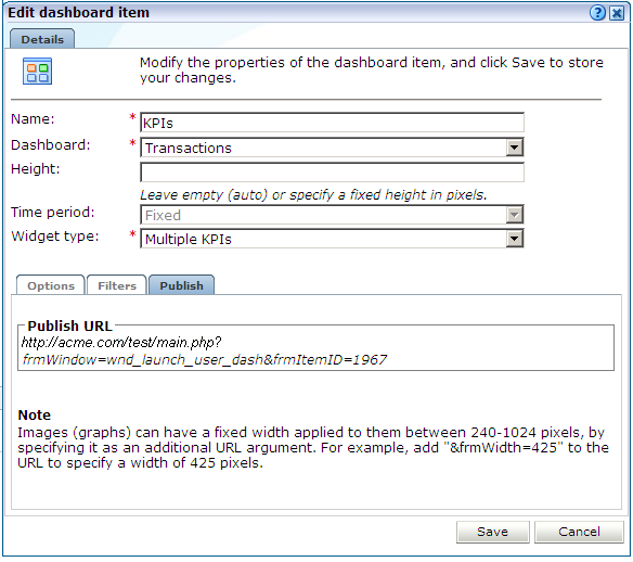

In addition to publishing complete templates, you can also make individual template items available to external users. Do the following:
Right click the required published template, and select Edit content from the context menu. The selected dashboard opens in a new window.
Click the title of the required dashboard item. A dialog similar to the one shown in Figure 5-8 appears.
Click the Publish tab, and copy and send the Publish URL link to the required users. Note that the container part of the dashboard item (with the item name and icons in the top left-hand corner) is removed when items are externally published. By default, images are published with the lowest of their indicated width ranges (for example, 240-1024 pixels). However, you can control this by appending the argument &frmWidth= and the preferred width to the publish URL. Note that aspect ratio is preserved for maps.
Note that access to the item is controlled through its associated template. Therefore, if the published item is moved to another template, or the template's distribution is amended to make it non-published, the item is no longer available to external users, and an error message will be disabled when the publish URL is clicked.
