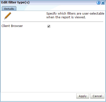

Edit Filters. Opens a new window where you can edit filters. |

For each filter listed in the filter panel, right click it, and select Mark as report filter from the menu. An example is shown in Figure 3-16.
Be careful when designing reports with multiple filters because it can make the report difficult to view.Select Open as report from the View menu, and finalize the structure of the required report. Notice that the selected filter is now shown within the report. An example is shown in Figure 3-17.
Highlight the filter by placing the mouse pointer over it, and select Edit filter type from the menu. A dialog similar to the one shown in Figure 3-18 appears.
Use the check box(s) shown in the Edit filter type(s) dialog to control which filters can be selected by a user when the report is opened. There will be a check box for each defined report filter. When ready, click Apply.
Save the report, as described in Section 2.11, "Creating New Reports".
When the report is opened, and a report filter has been enabled, you can choose one or more values to filter the report. An example is shown in Figure 3-19:
