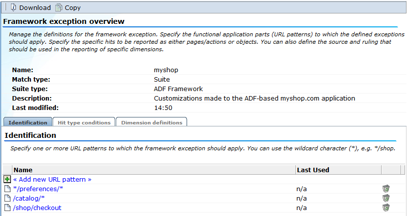

Click the newly created framework exception. An overview similar to the one shown in Figure 10-9 appears.
Click Identification tab, and then the Add new URL pattern item. This specifies the scope of the framework exception. Enter one or more patterns, to reflect the structure of your application. Note that the patterns must start with either a slash ("/"), or a wildcard ("*"), otherwise they will not match any URL. Use wildcards as appropriate to include all sub-directories of a given URL pattern, or to specify only a given sub-directory regardless of the path leading to that directory. For instance, */preferences/* will match any path that contains "preferences", including deeper paths, such as:.
www.myshop.com/preferences
www.myshop.com/user/preferences
www.myshop.com/another/location/preferences/subdir/subdir/
Note however, that a path without any wild cards will only match the exact URL, e.g. /shop/checkout will not match /shop/checkout/payments/.
Also, note that URL arguments in a path are not take into consideration, so the same path with or without URL arguments is seen as identical.
