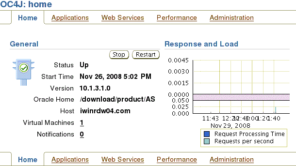

In a Web browser, navigate to the Enterprise Manager home page.
Log in using the oc4jadmin credentials. You may be prompted to activate the oc4jadmin account. If prompted to activate the account:
Create a password for the oc4jadmin account to activate it. Enter the password you want to use. Confirm the password and click OK to activate the account.

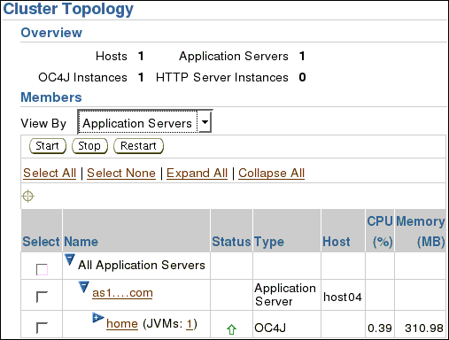

On the Cluster Topology page, locate the link to the OC4J instance installed under the Application Server.
Click home (the OC4J instance).
This takes you to the home page of the OC4J instance.

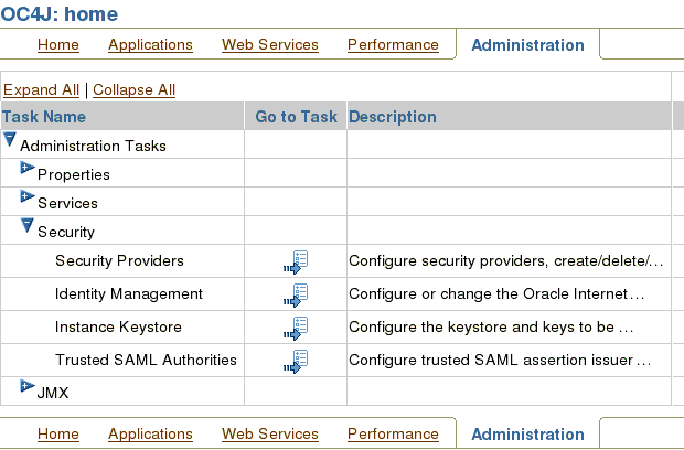

On the OC4J home screen, click the Administration tab.
On the Administration Tasks screen, expand Security.

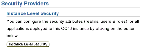

Click the task icon next to Security Providers.

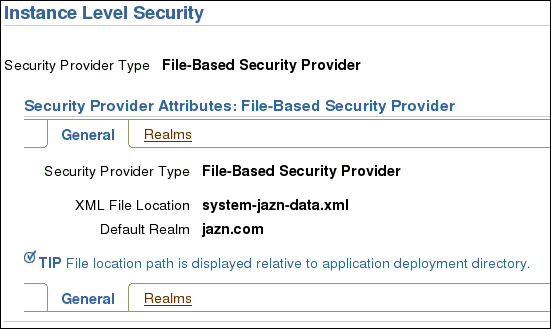

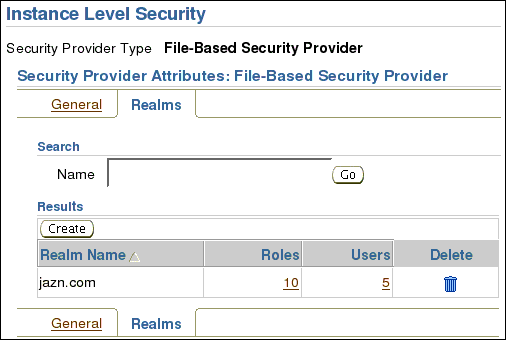

On Security Providers screen, click Instance Level Security.
On Instance Level Security screen, click the Realms tab.

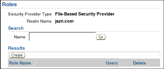

Under the Realms tab, in the default realm jazn.com, click the number in Roles column.

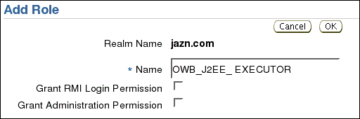

On the Roles screen, click Create.
On the Add Role screen, enter Name OWB_J2EE_EXECUTOR.
Click OK.

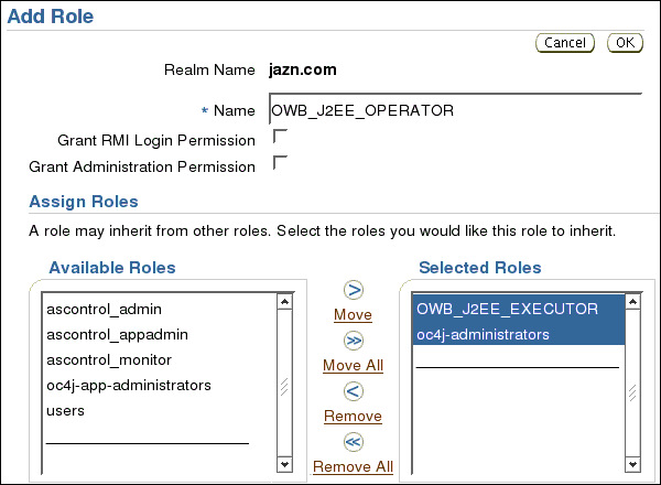

On the Add Role screen, enter Name OWB_J2EE_OPERATOR.
Click OK.
Under Assign Roles, in the list of Available Roles, select OWB_J2EE_EXECUTOR and oc4j-administrators, and move to the list of Selected Roles.
Click OK.

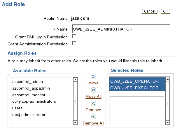

On the Add Role screen, enter Name OWB_J2EE_ADMINISTRATOR.
Under Assign Roles, in the list of Available Roles, select OWB_J2EE_OPERATOR and OWB_J2EE_EXECUTOR, and move to the list of Selected Roles.
Click OK.

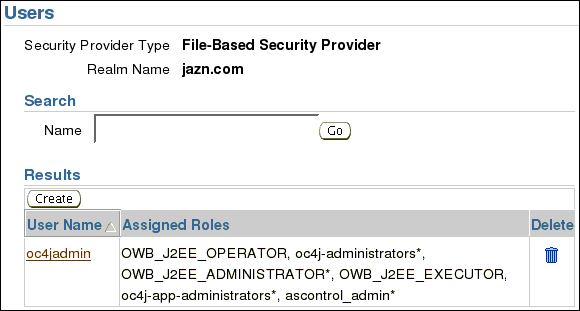

Under the Realms tab, in the default realm jazn.com, click the number in Users column.
On the Users screen, click user oc4jadmin.
Under Assign Roles, in the list of Available Roles, select OWB_J2EE_ADMINISTRATOR and oc4j_app_administrators, and move to the list of Selected Roles.
Click Apply.

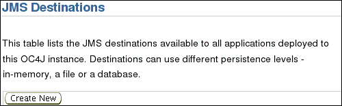

You must create two JMS queues, for JRT:owbQueue, and for JRT:owb_abortQueue.
On the breadcrumb, click OC4J:home.

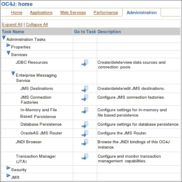

On the OC4J:home screen, click the Administration tab.
Expand Services, and then expand Enterprise Messaging Service.

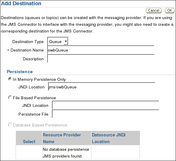

On JMS Destinations screen, click Create New.
On Add Destination screen, choose Destination Type Queue, enter Destination Name owbQueue, select Persistence In Memory Persistence Only, and enter JNDI Location jms/owbQueue.
Click OK.
On Add Destination screen, choose Destination Type Queue, enter Destination Name owb_abortQueue, select Persistence In Memory Persistence Only, and enter JNDI Location jms/owb_abortQueue.
Click OK.

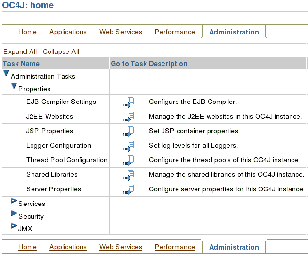

Expand Administration Tasks, then expand Properties.
Click the task icon next to Server Properties.

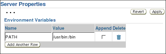

On the Server Properties screen, scroll downwards to Environment Variables section.
Under Environment Variables, click Add Another Row.
Enter PATH in Name, and fill Value with directories that contain the system commands.
Click Apply.

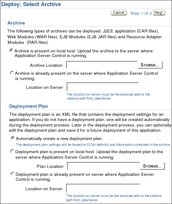

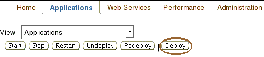

To deploy the Control Center Agent to OC4J:
On the OC4J:home screen, click the Applications tab.
Click Deploy to begin deploying Control Center Agent.
On the Deploy: Select Archive screen, under Archive, select Archive is present on local host. Upload the archive to the server where Application Server Control is running.
Click Browse and locate the jrt.ear file in the OWB_HOME/owb/jrt/applications directory.
Under Deployment Plan, select Automatically create a new deployment plan.
Click Next.

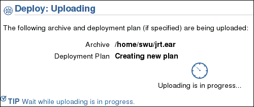

While the upload is in progress, you see the Deploy: Uploading screen.

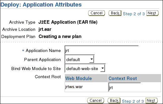

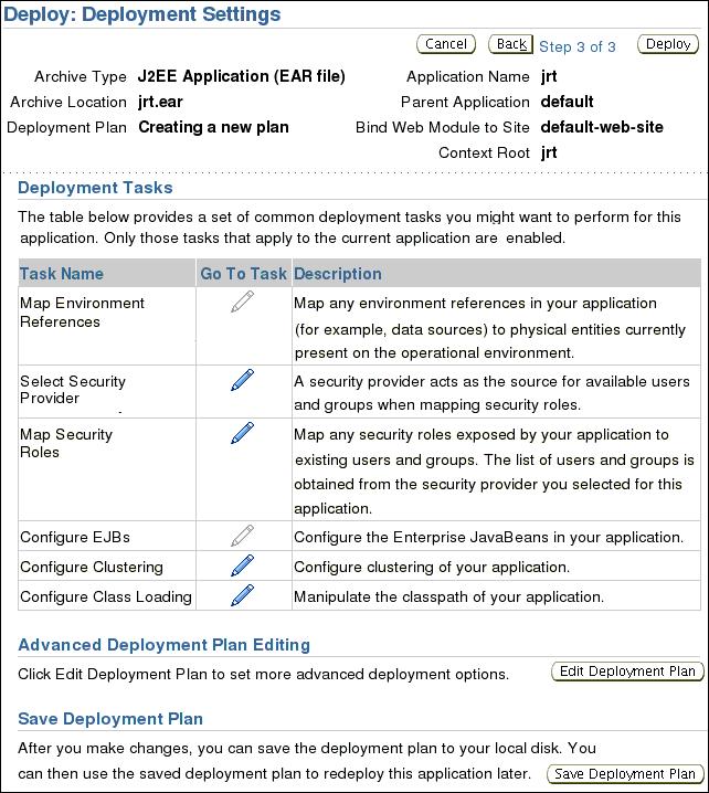

On the Deploy: Application Attributes screen, enter Application Name jrt, and Context Root jrt. Leave the other attributes at their default values.
Click Next.
On Deploy: Deployment Settings screen, leave all attributes at their default values, and click Deploy.

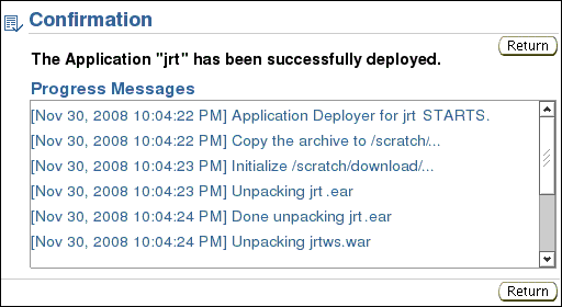

Once the application is successfully deployed, a confirmation message displays.
On the Confirmation screen, click Return.

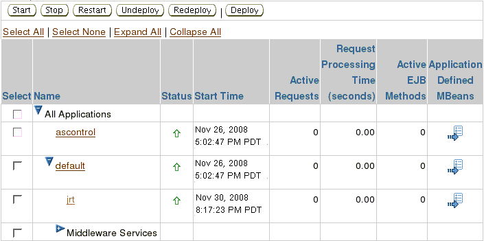

Under the Applications tab, expand All Applications, then expand default.
The new application CCA is up.

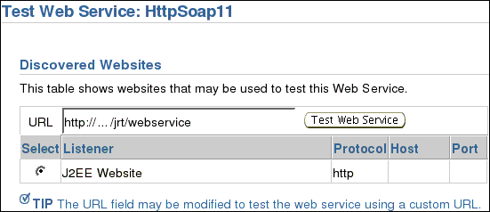

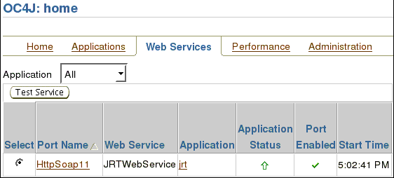

To check that the Web Service is running:
On the OC4J:home screen, click the Web Services tab.
Under the Web Services tab, select JRTWebService and click Test Service.
On the Test Web Service: HttpSoap11 screen, under Discovered Web sites, select the http site and click Test Web Service.

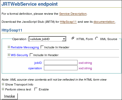

The JRTWebService endpoint screen displays that the Web Service is running.
You can access the operations available from the Operation drop down box, fill in the required parameters, and then click Invoke to execute the operation.
[Optional] Alternatively, go to http://AS_hostname/jrt/webservice.

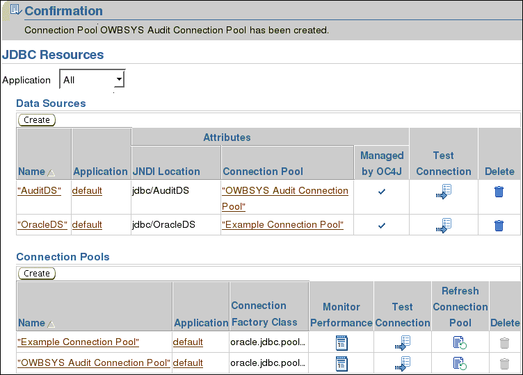

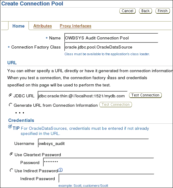

To configure the OWBSYS Audit Connection Pool:

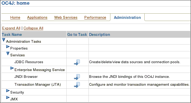

Expand Services.

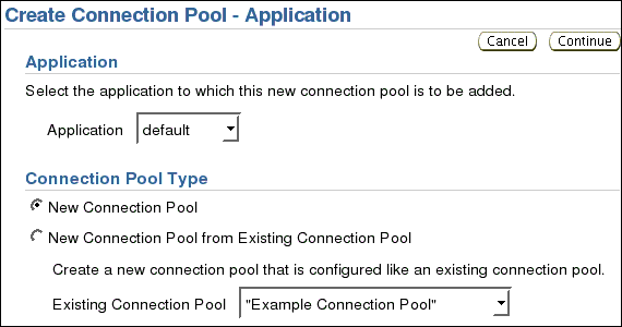

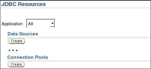

On the JDBC Resources screen, under Connection Pools, click Create.
On the Create Connection Pool - Application screen, under Application, select default.
Under Connection Pool Type, select New Connection Pool.
Click Continue.
On the Create Connection Pool screen, enter the Name OWBSYS Audit Connection Pool. Under URL, select JDBC URL, and enter the URL (in this example, jdbc:oracle:thin:@localhost:1521:ora111 is used for a local installation).
Under the Credential section, enter the User Name (in this example, owbsys_audit), and enter the Use Cleartext Password.

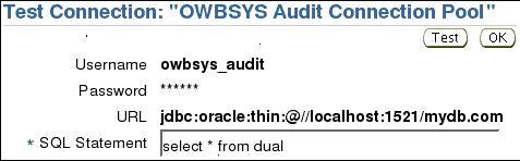

[Optional] On the Confirmation screen, test the availability of the connection. Click Test Connection.
On the Test Connection: "OWBSYS Audit Connection Pool" screen, click Test.
A confirmation screen appears.
Application Server 10g is not case-sensitive when verifying Oracle Database credentials; it converts all letters to lowercase before attempting to connect to the database. Because Oracle Database Release 11g Release 1 and subsequent releases are case sensitive, create user credentials in lowercase when using for Audit Table logging to prevent theInvalid username/password error message.To deploy Control Center Agent to OC4J, you must also configure the data source for the audit table. This data source is required by Control Center Agent; if not configured, the Control Center Agent deployment fails.

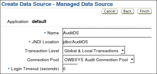

To configure the audit table data source:
Expand Services.

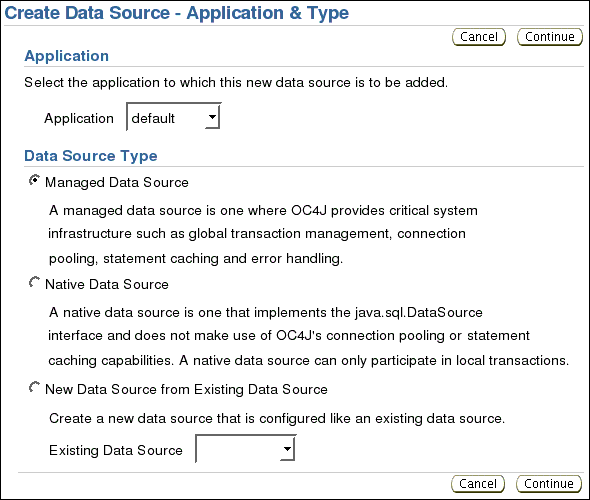

On the JDBC Resources screen, under Data Sources, click Create.
On the Create Data Source - Application & Type screen:
Under Application, select Application default.
Click Continue.
On the Create Data Source - Managed Data Source screen,
If you do not require audit table logging, leave other parameters at their default values.

Obtain the *.jar file that contains the JDBC driver for your desired platform.
Stop the OC4J service.
Copy the JDBC driver file into the AS_HOME/j2ee/home/applib directory, where AS_HOME is the Application Server home.
Restart the OC4J service.

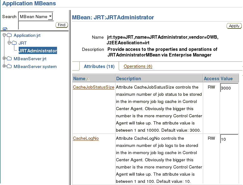

The JRTAdministratorMBean enables you to dynamically change Control Center Agent settings without restarting the Control Center Agent.
To change Control Center Agent settings with the JRTAdministratorMBean
Expand All Applications, then expand default.
In the jrt row, click the task icon in column Application Defined MBeans.
On the Application MBeans screen, in the left-hand side navigation menu, select JRTAdministrator.
The right-hand side shows all the Attributes and Operations of JRTAdministrator MBean, under the corresponding tabs.
Change the attributes to desired values, then click Apply.
To use a code template, you must install any additional JDBC driver files that it requires to access heterogeneous systems on all the client computers and on the computer that hosts the Control Center Agent.
Load the required JDBC drivers to the OWB_HOME/owb/lib/ext directory.
Import the code templates into any projects that uses them, in the design client.
Import the code template once for the project. After it is imported, all users working on the project can use the code template.
