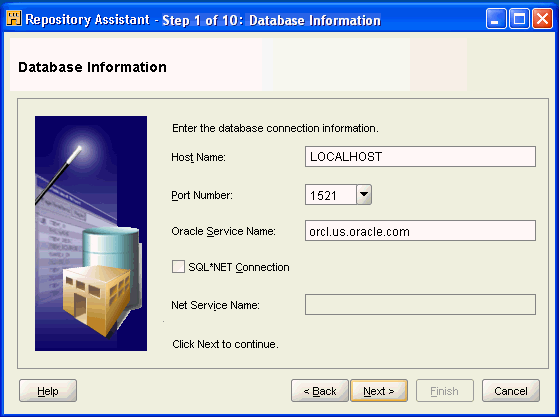

On the Database Information page, enter the host name, port number, and service name where Oracle Warehouse Builder is installed.
Click Next.

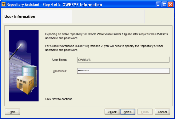

You can upgrade an Oracle Warehouse Builder Release 10.2 or 11.1 repository by exporting its content to a file, and then importing the file into an Oracle Warehouse Builder Release 11.2 repository, using the Repository Assistant.
You export a repository with the Repository Assistant as follows.
To export a repository to a file
Start the Repository Assistant.
On Windows, from the Start menu, select Program Files, then Oracle - OWB112, then Warehouse Builder, then Administration, then Repository Assistant.
On Linux, from the command line, run OWB_HOME/owb/bin/unix/reposinst.sh.
On the Welcome page of the Repository Assistant, click Next.
On the Database Information page, enter the host name, port number, and the service name where Oracle Warehouse Builder is installed.
Click Next.
On the Choose Operation page, select Upgrade repository to current release of Oracle Warehouse Builder.
Click Next.

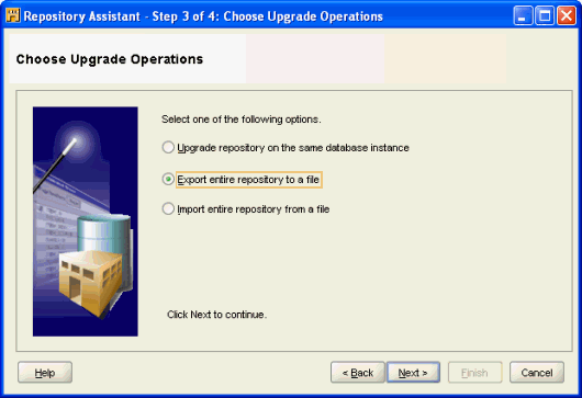

On the Choose Upgrade Operation page, select Export entire repository to a file.
Click Next.
On the User Information page, for an Oracle Warehouse Builder Release 10.2 source, enter the user name and password of Oracle Warehouse Builder Release 10.2 repository owner. For an Oracle Warehouse Builder Release 11.1 source, enter the OWBSYS user name and password.
Click Next.

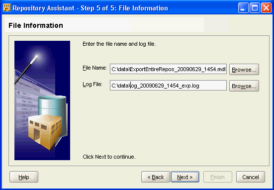

On the File Information page, enter the following information:
File Name: the name of the MDL file for storing the repository.
Log File: the name of the export operation log file that stores status and statistical information.
Click Next.
On the Summary page, click Finish.
An Export Repository Progress window appears showing progress.
At the end of the export process, a status message appears. The export operation creates the file.

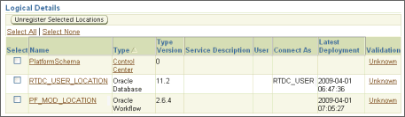

Oracle Warehouse Builder provides the utility to upgrade the entire repository from Release 10.2 to Release 11.2 through Repository Assistant. After the upgrade, you should use the Repository browser to update all locations, and then run the deployed objects, and mappings.

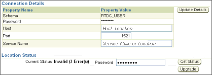

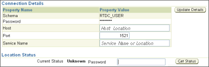

For Repository upgrade from Release 10.2 to Release 11.2, some extra steps are required for Process Flow, besides updating the locations through the Repository browser.
A warning information message is displayed after the location is upgraded.
Warning:
This OWF location has not been seeded.It can be seeded by using the Design Client to deploy at least one Process Flow Package into it.
This warning message is not displayed every time, such as if you have both 11.2 and 10.2 Repositories, when you upgrade your Repository 10.2 to 11.2, you cannot see the warning as the packages are present in the Repository collectively.

Importing a Repository from MDL File
"Importing a Repository Export MDL File to Oracle Warehouse Builder Release 11.2" describes the import operation. In step 6, you are entering the credential of the source (remote) database, which contains the repository MDL and log files.

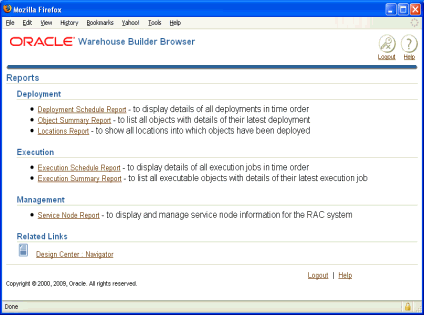

To upgrade locations using the Repository Browser
In Repository Browser, select Control Center. Click Reports.
In the Reports window, under Deployment, click Locations Reports.
On the Locations Report, under Logical Details, in the Validation column of the table, click Unknown.
Under Connection details, under Location Status, because the status is Unknown, enter the password and click Get Status.
The Current Status is Invalid.
Under Location Status, click Upgrade.
The Current Status is now Valid.
Once you are finished, notice that the Validation column shows Tested locations
