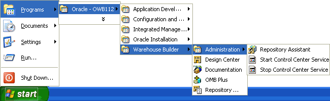

To use a repository, you must define an initial workspace, and the owner of that workspace. The following instructions use the Repository Assistant.
Start the repository assistant from the Start menu, selecting Program Files, then Oracle - OWB112, then Warehouse Builder, then Administration, then Repository Assistant.
On the Welcome screen of the Repository assistant, click Next.
