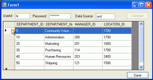

Using the DataSet Class with Oracle Data Provider for .NET
The DataSet class provides a memory-resident copy of database data. It consists of one or more tables that store relational or XML data. Unlike an OracleDataReader object, a DataSet is updatable and backward scrollable.
To use the DataSet class:
  1. If you have not done so before, make another copy of the Form1 that you completed in Chapter 3, and name it Form3.vb or .cs, as described in Appendix B, "Copying a Form". If Form1.xx does not appear in the Solution Explorer, from the Project menu, select Show All Files.
  2. From the View menu, select Designer view.
  3. From the View menu, select Toolbox.
  4. From the Toolbox, select a DataGridView and drag it onto Form1.
  5. From the View menu, select Properties Window.
  6. In the Properties window, change the Name of the data grid view to departments.
    Description of dataset1.gif follows
  7. From the View menu, select Code.
  8. Immediately after the conn declaration in the code, add variable declarations to the class variables, as indicated.
    Visual C#:
    public partial class Form1 : Form
      public Form1()
          InitializeComponent();
      private OracleConnection conn = new OracleConnection();
      private OracleCommand cmd;
      private OracleDataAdapter da;
      private OracleCommandBuilder cb;
      private DataSet ds;
    Visual Basic:
    Public Class Form1    Dim conn As New OracleConnection     Private cmd As OracleCommand
        Private da As OracleDataAdapter
        Private cb As OracleCommandBuilder
        Private ds As DataSet
  9. Within the connect_Click() method try block, add code to:
    • Query the database
    • Fill the DataSet with the result of the command query
    • Bind the DataSet to the data grid (departments)
    Visual C#:
    conn.Open();
    connect.Enabled = false;
    string sql = "select * from departments where department_id < 60";
    cmd = new OracleCommand(sql, conn);
    cmd.CommandType = CommandType.Text;
    da = new OracleDataAdapter(cmd);
    cb = new OracleCommandBuilder(da);
    ds = new DataSet();
    da.Fill(ds);
    departments.DataSource = ds.Tables[0];
    Visual Basic:
    conn.Open()
    connect.Enabled = False
    Dim sql As String = "select * from departments where department_id < 60"
    cmd = New OracleCommand(sql, conn)
    da = New OracleDataAdapter(cmd)
    cb = New OracleCommandBuilder(da)
    ds = New DataSet()
    da.Fill(ds)
    departments.DataSource = ds.Tables(0)
  10. Build and save the application.
  11. Run the application, entering the login and data source.
    After you successfully connect to the database, the data grid is populated with the results of the query.
    Description of dataset3.gif follows

  1. Run the application you created in the last section, entering the login and data source, and connecting to the database.
  2. At the bottom of the data grid, enter a new record at the * prompt:
    • For DEPARTMENT_ID, enter 5.
    • For DEPARTMENT_NAME, enter Community Outreach.
    • Leave MANAGER_ID without a value.
    • For LOCATION_ID, enter 1700.
    Description of dataset4.gif follows
  3. Click Save.
  4. Close the application to check if the new record is saved.
  5. Run the application again, and connect to the database.
    Note that the new department is at the top of the DEPARTMENTS table, in numerical order by DEPARTMENT_ID.
  6. Change the name of the department to Community Volunteers, and click the Save button.
    Description of dataset10.gif follows
  7. Repeat Step 4, run the application again, and connect to the database, and note that the name of the department is changed.
