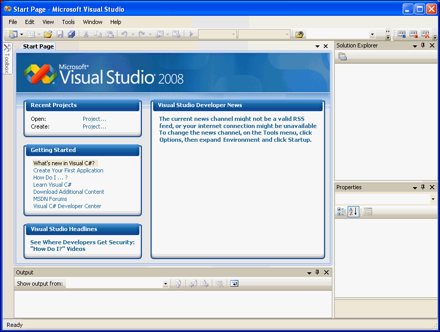

  1. Start Visual Studio.
    Open the Start menu, select All Programs, and then select Microsoft Visual Studio 2008.
    Description of connect00.gif follows
    The Microsoft Visual Studio IDE environment appears.

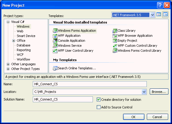

  2. In the Start Page, under the Recent Projects heading, click Create: Project.
    Alternatively, from the File menu, select New, and then select Project.
    A New Project dialog box appears.
  3. In Project Types, select the type of project you are creating:
    Visual C#:
    Visual C#: Windows
    Visual Basic:
    Other Languages: Visual Basic: Windows
  4. In Templates, select Windows Forms Application.
  5. In the Name field, enter the appropriate name.
    Visual C#:
    HR_Connect_CS
    Visual Basic:
    HR_Connect_VB
    The abbreviation CS indicates C# projects and VB indicates Visual Basic projects.
  6. In Location, enter the directory where you want to save the files.
    For this guide, enter this directory C:\HR_Projects.
  7. In Solution Name, the appropriate name, HR_Connect_CS or HR_Connect_VB should appear.
    A solution can contain several projects; when it contains only one project, you can use the same name for both.
  8. Check Create directory for solution.
  9. Click OK.

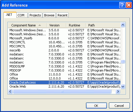

Adding a Reference
This section shows you how to add a reference to the Oracle.DataAccess.dll file, which contains the data provider, Oracle Data Provider for .NET.
To add a reference:
  1. From the Project menu, select Add Reference.
    Description of reference01.gif follows
    The Add Reference windows appears.
  2. In the Add Reference window, under the .NET tab, select Oracle.DataAccess. Click OK.

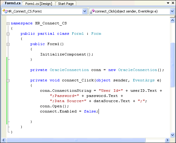

  1. From the View menu, select Code.
  2. Add the code indicated to instantiate a database connection string.
    Visual C#: Add the class variable conn to the Form1 class right after the public Form1() block with this code.
    private OracleConnection conn = new OracleConnection();
    Description of connect1.gif follows
    Visual Basic: Add the conn class variable in the Form1 class declaration, using this code.
    Public Class Form1
       Dim conn As New OracleConnection
    Description of connect2.gif follows
  3. Save your changes.
  4. Change to Designer view by clicking on the View menu and selecting Designer.
  5. Double-click the Connect button on Form1 to open the code window to the connect_Click() method.
    Insert the code indicated into the connect_Click() method.
    Visual C#:
    conn.ConnectionString = "User Id=" + userID.Text +
       ";Password=" + password.Text +
       ";Data Source=" + dataSource.Text + ";";
    conn.Open();

  6. Set the Enabled attribute of the button to false by inserting the indicated code at the end of the connect_Click() method.
    This disables the Connect button, which is a good practice once a connection is successfully made.
    Visual C#:
    connect.Enabled = false;

    using (OracleConnection conn = new OracleConnection())
      conn.Open();
      // application code
    Visual Basic:
    Try
      conn.Open()
    Catch ex As Exception
      MessageBox.Show(ex.Message.ToString())
    Finally
      conn.Dispose()
    End Try
