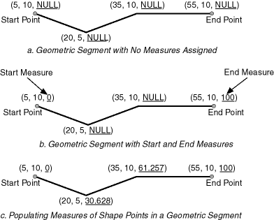

7.1.6 Measure Populating
Any unassigned measures of a geometric segment are automatically populated based upon their distance distribution. This is done before any LRS operations for geometric segments with unknown measures (NULL in Oracle Spatial). The resulting geometric segments from any LRS operations return the measure information associated with geometric segments. The measure of a point on the geometric segment can be obtained based upon a linear mapping relationship between its previous and next known measures or locations. See the algorithm representation in Figure 7-3 and the example in Figure 7-4.
Figure 7-3 Measures, Distances, and Their Mapping Relationship
Description of Figure 7-3 follows
Description of "Figure 7-3 Measures, Distances, and Their Mapping Relationship"
Figure 7-4 Measure Populating of a Geometric Segment
Description of Figure 7-4 follows
Description of "Figure 7-4 Measure Populating of a Geometric Segment"
Measures are evenly spaced between assigned measures. However, the assigned measures for points of interest on a geometric segment do not need to be evenly spaced. This could eliminate the problem of error accumulation and account for inaccuracy of data source.
Moreover, the assigned measures do not even need to reflect actual distances (for example, they can reflect estimated driving time); they can be any valid values within the measure range. Figure 7-5 shows the measure population that results when assigned measure values are not proportional and reflect widely varying gaps.
Figure 7-5 Measure Populating with Disproportional Assigned Measures
Description of Figure 7-5 follows
Description of "Figure 7-5 Measure Populating with Disproportional Assigned Measures"
In all cases, measure populating is done in an incremental fashion along the segment direction. This improves the performance of current and subsequent LRS operations.

After adding the new measure dimension, geometries with measure information such as geometric segments and LRS points can be represented. An example of creating a geometric segment with three line segments is shown in Figure 7-7.
Figure 7-7 Creating a Geometric Segment
Description of Figure 7-7 follows
Description of "Figure 7-7 Creating a Geometric Segment"
In Figure 7-7, the geometric segment has the following definition (with measure values underlined):
SDO_GEOMETRY(3302, NULL, NULL,
     SDO_ELEM_INFO_ARRAY(1,2,1),
     SDO_ORDINATE_ARRAY(5,10,0, 20,5,NULL, 35,10,NULL, 55,10,100))
Whenever a geometric segment is defined, its start and end measures must be defined or derived from some existing geometric segment. The unsigned measures of all shape points on a geometric segment will be automatically populated.
The SDO_GTYPE of any point geometry used with an LRS function must be 3301.

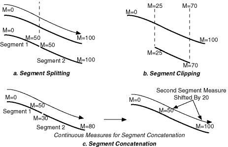

7.5.3 Clipping a Geometric Segment
You can clip a geometric segment to create a new geometric segment out of an existing geometric segment, as shown in Figure 7-10, part a.
Figure 7-10 Clipping, Splitting, and Concatenating Geometric Segments
Description of Figure 7-10 follows
Description of "Figure 7-10 Clipping, Splitting, and Concatenating Geometric Segments"
In Figure 7-10, part a, a segment is created from part of a larger segment. The new segment has its own start and end points, and the direction is the same as in the original larger segment.
7.5.4 Splitting a Geometric Segment
You can create two new geometric segments by splitting a geometric segment, as shown in Figure 7-10, part b. The direction of each new segment is the same as in the original segment.
In Figure 7-10 and several figures that follow, small gaps between segments are used in illustrations of segment splitting and concatenation. Each gap simply reinforces the fact that two different segments are involved. However, the two segments (such as segment 1 and segment 2 in Figure 7-10, parts b and c) are actually connected. The tolerance (see Section 1.5.5) is considered in determining whether or not segments are connected.
7.5.5 Concatenating Geometric Segments
You can create a new geometric segment by concatenating two geometric segments, as shown in Figure 7-10, part c. The geometric segments do not need to be spatially connected, although they are connected in the illustration in Figure 7-10, part c. (If the segments are not spatially connected, the concatenated result is a multiline string.) The measures of the second geometric segment are shifted so that the end measure of the first segment is the same as the start measure of the second segment. The direction of the segment resulting from the concatenation is the same as in the two original segments.
Measure assignments for the clipping, splitting, and concatenating operations in Figure 7-10 are shown in Figure 7-11. Measure information and segment direction are preserved in a consistent manner. The assignment is done automatically when the operations have completed.
Figure 7-11 Measure Assignment in Geometric Segment Operations
Description of Figure 7-11 follows
Description of "Figure 7-11 Measure Assignment in Geometric Segment Operations"
The direction of the geometric segment resulting from concatenation is always the direction of the first segment (geom_segment1 in the call to the SDO_LRS.CONCATENATE_GEOM_SEGMENTS function), as shown in Figure 7-12.
Figure 7-12 Segment Direction with Concatenation
Description of Figure 7-12 follows
Description of "Figure 7-12 Segment Direction with Concatenation"
