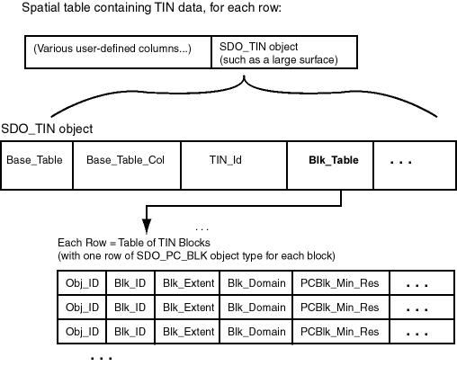

Figure 2-2 shows the storage model for TIN data, in which the TIN block table (specified in the BLK_TABLE attribute of the SDO_TIN type) stores the blocks associated with the SDO_TIN object.
Figure 2-2 Storage of TIN Data
Description of Figure 2-2 follows
Description of "Figure 2-2 Storage of TIN Data"
