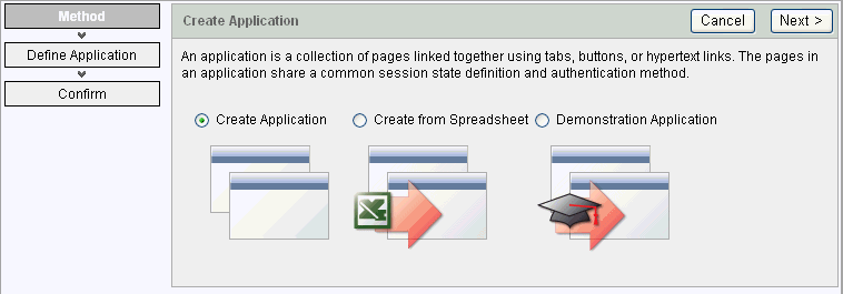

  4. For Method, accept the default, Create Application, and click Next.

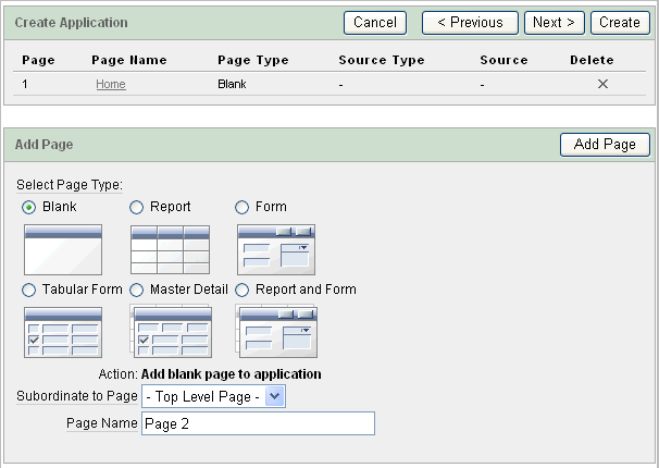

  6. For Pages, specify the following in the Add Page section:
    1. Select Page Type - Accept the default, Blank.
      Tip:
      Explanatory information for each option appears on the right side of the page. This page-level help appears throughout the application.
    2. Page Name - Enter Home.
    3. Click Add Page.
      The Home page is now listed in the top area. Also, note that the Add Page area appears so you can continue adding pages to your initial application.
    Description of cr_app_add_pg.gif follows

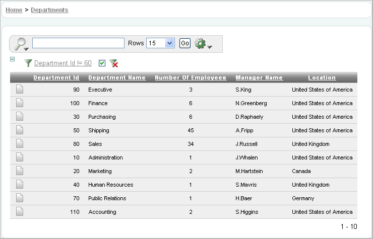

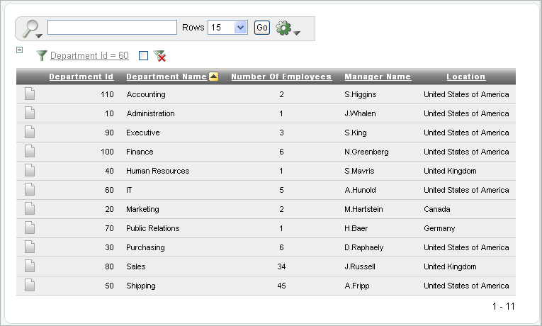

    The revised Departments report appears.
    Description of bldap_deptexp.gif follows

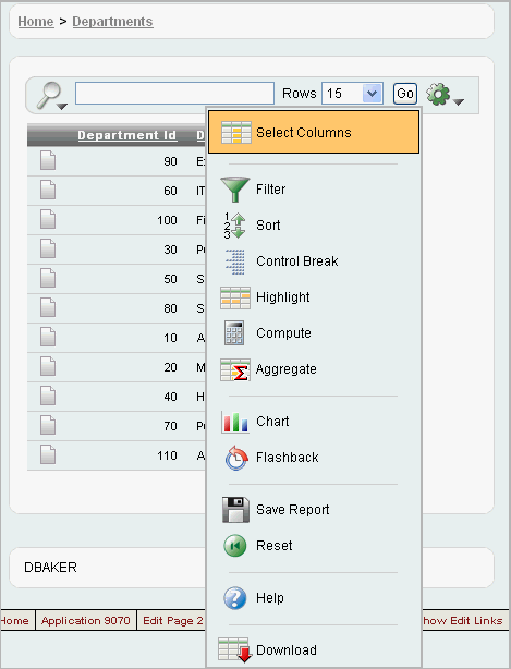

  2. To add the new columns, click the Actions menu. The list of Action options appears.
    Description of bldap_addcolumn.gif follows
    Note that the Manager Id and Location Id columns are no longer available. Also note that the three new columns are not displayed on the revised report: Number of Employees, Manager Name, and Location. The following steps are required to add these columns to the display and reorder them.
  3. Select Select Columns.

    The Departments page appears and includes the new columns.
    Description of bldap_deptnew.gif follows

There is more than one way a user can create a filter. The user can add a filter from the:
  • Search Bar
  • Actions Menu
  • Column Heading
The Actions menu offers more options than the others. For a quick filter using the equals operator, the Search Bar or column heading are the quickest methods. For anything else, use the Filter option from the Actions menu.
To create a filter for all departments not equal to 60:
  1. Select the Actions menu.
  2. Select Filter.
    The filter settings display. Note the user can also click the column heading link to create a filter for that column. Creating a filter from the column heading menu, however, is limited to the equal operator.
    Description of bldap_filter.gif follows
  3. From the Operator drop down, select the not equals operator:
  4. Select 60 from the Expression drop down.
  5. Click Apply.
    The Departments report is displayed with the Department_Id!=60 filter applied. All departments, accept for the IT department with a Department Id of 60, are included in the report.
    Description of bldap_dept60.gif follows
    Notice the filter is shown at the top of the report. You can edit, disable, or delete this filter. To edit, click on the filter name. To disable, uncheck the check box. To delete, click on the Delete icon that looks like an X over the filter icon.
  6. Uncheck the check box next to the Department Id!=60 filter to disable it.
    The report shows data for all Department Ids.

To change the sort order:
  2. Select Sort.
    The sort settings are displayed. Note this option is also available for each column by clicking the column heading. The Actions menu is quicker when changing the sort order for multiple columns.

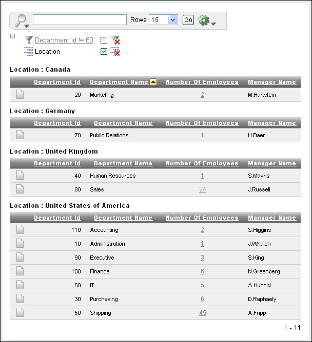

Add a Controlled break
Another Actions menu option the user can select to reformat the report, is the controlled break. This allows the user to delineate data into clearly visible groups.
To add a controlled break:
  1. Click the Location column heading.
    The column heading menu appears.
  2. Click the Control Break icon as shown below.
    Note this same option is also available from the Actions menu.
    Description of bldap_ctlbrk.gif follows
    The report is reformatted to show a break after each group of rows that share the same location.
    Description of bldap_locbrk.gif follows
    Note the Location control break report setting has been added under the Department Id!=60 filter.

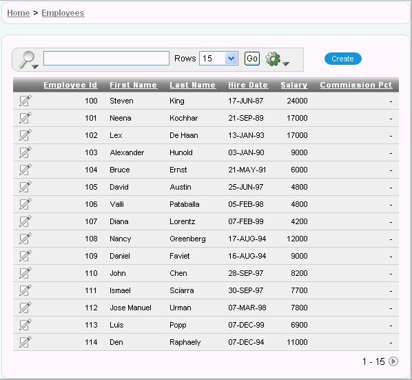

Previewing the Pages
To preview the two pages you just created, run the current page. From the Employees report, you can then preview the form.
To preview the pages:
  1. Click the Run Page icon.
    Description of runpg_afterwiz.gif follows
    The Employees report appears.
    Description of bldap_emprpt.gif follows
    Note the following about the Employees report:
    • The Search Bar with the Actions menu appears at the top. For more information see Using an Interactive Report .
    • The column headings are links that allow the user to quickly perform various sorting, filtering and reformatting operations. For more information see Using an Interactive Report .
    • The Edit icon you selected appears in each row. You can click the Edit icon to update the employee record. Since you created a form based on a table with a report, the wizard automatically linked the report to the form. If you create just a report, as is done in the previous Creating the Initial Application section, the wizard automatically links the report to the single row view.
    • The Create button appears in the upper right corner. You can click the Create button to add an employee to the underlying table.
    • The Employees report includes the five columns you specified. When you selected the columns and applied the changes, Oracle Application Express created the appropriate SQL code in the background to produce this result.
    Your data might appear in a different order. If so, ignore this difference and continue with these steps.

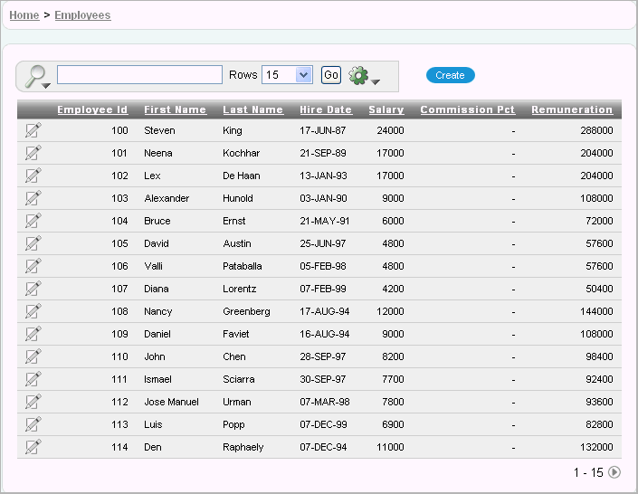

Previewing the Page
To preview the page, click the Run Page icon in the upper right corner. Notice the Remuneration column does not appear. You must add the column by using the Select Column action.
To display the Remuneration column:
  2. Select the Select Columns action.
  3. Move the Remuneration column from the Do Not Display box to the Display in Report box.
    Description of bldap_addrem.gif follows
  4. Click Apply.
    The Employees Report is displayed and includes the Remuneration column.
    Description of bldap_empfrmrem.gif follows

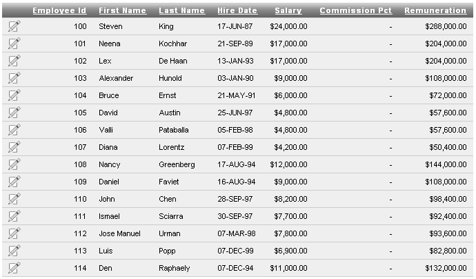

Changing the Column Format
Next, change the format of the columns that contain numeric values.
To change the column format:
  1. Click Edit Page 3 on the Developer toolbar (at the bottom of the page).
    The Page Definition appears.
  2. Under Regions, click Interactive Report.
    The Interactive Report Attributes page appears.
  3. Locate the Column Attributes section.
    Next, change the format of the value in the Salary and Remuneration columns.
  4. To edit the Salary format:
    1. Click the Edit icon next to SALARY.
    2. For Number/Date Format, select $5,234.10 from the list.
      Notice that the appropriate format mask appears in the field.
    3. Click Apply Changes.
  5. Repeat the previous step for REMUNERATION.
  6. Click the Run Page 3 icon in the upper right corner to preview the page.
    Notice that the numbers in the Salary and Remuneration columns now appear with the dollar sign, include commas and decimals, and are correctly aligned.
    Description of bldap_emprptnum2.gif follows

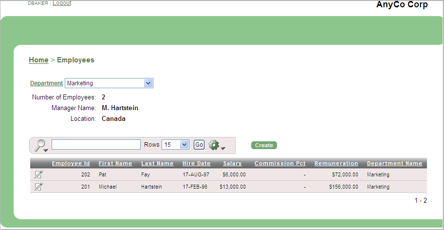

Adding a Department Column to the Employees Reports
In this exercise, you link the Employees and Departments reports. When you complete this section, the Employees report will have a Departments column showing which department each employee belongs to.
To perform this task, you create a column on the Employees page to enable the user to select a department. You then run the Employees report and add the Departments column to the report display. The report settings are saved as the default.
Topics in this section include:
Add a Column
In order to filter the Employees report by department, add a Department column to the report.
To add a column:
  1. Click on Edit Page 3 in the Developer toolbar.
  2. Under Regions, click Employees and scroll down to Source.
  3. Replace Region Source with the following SQL:
    SELECT e.EMPLOYEE_ID,
        e.FIRST_NAME,
        e.LAST_NAME,
        e.HIRE_DATE,
        e.SALARY,
        e.COMMISSION_PCT,
        calc_remuneration(salary, commission_pct) REMUNERATION,
        e.DEPARTMENT_ID,
        d.DEPARTMENT_NAME
    FROM OEHR_EMPLOYEES e,
        OEHR_DEPARTMENTS d
    WHERE e.DEPARTMENT_ID=d.DEPARTMENT_ID
  4. Click Apply Changes.
  5. Click Apply Changes to confirm.
    The next section explains how to add the column to the report display and how to use this column to filter employee reports.
Display Column in the Report

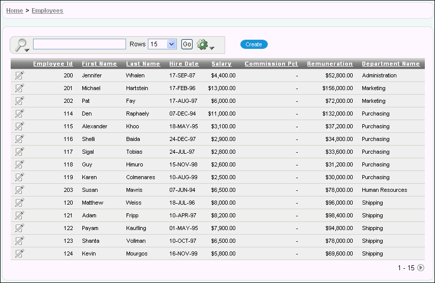

When you first run this report, use the Select Columns action to add the Department Name column to the display. Once this column is visible on the report, make this report the default and filter by department.
To add the Department Name column to the report:
  1. Click Run Page 3 icon.
  2. Select the Actions menu and select Select Columns from the list.
  3. Move the Department Name from the Do Not Display box to the last entry in the Display in Report box. Description of bldap_deptcol.gif follows
  4. Click Apply.
    The Employees Report is displayed and includes the Department Name column.
    Description of bldap_empdept.gif follows

To save the current report settings as the default:
  1. Run the Employees report page.
    The current report default does not include the Department Name column when the report is displayed.
  2. Click the Actions menu.
  3. Select Save Report from the list.
  4. For Save, select As Default Report Settings from the list.
  5. Click Apply.
    If a reset is performed on this page, these default report settings are used. The Department Name column is displayed by default.

Run the Departments Report
Now it's time to run the report and test the Number of Employees column link from the Departments report. The Employees report is displayed showing all employees that belong to the selected department.
  1. Click the Run Page 2 icon.
    The Departments report is displayed. Note that end users can now drill down on the data in the Number of Employees column.
    Description of bldap_numemplink.gif follows
  2. In the Number of Employees column, click the 3 for the Executive row.
    All employees that belong to the Executive department appear in the Employees report.
    Description of bldap_emplink.gif follows
    The Department Id filter is displayed because this report is filtered by the Department Id value for the Executive department, 90, passed to this report from the Departments report. Notice the Clear Interactive Report command is included at the end of the URL in your browser, as shown in this example:
    f?p=9257:3:3672543193352902::NO:RP,3,CIR:IR_DEPARTMENT_ID:90

    Description of bldapp_nodptassgn.gif follows
    Employee Kimberely Grant appears. This employee is not currently assigned to a department. Therefore, no department details appear. The 1 - 1 you see on this form is part of the Employees report, not part of the Department Details region you just edited.
  10. From the Department list, select Marketing.
    Description of bldapp_dptdetail.gif follows
    Note the details under Department.
