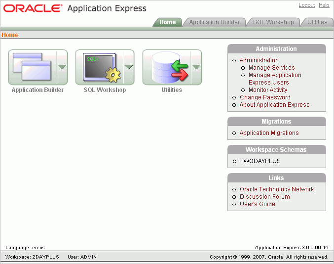

When you log in to Oracle Application Express, the Workspace home page appears.
Description of workspace4.gif follows
Take a few minutes to explore the product. The following three large icons appear in the center of the page:
Note that your workspace and username appear in the lower left corner.
About the Administration List
An Administration list appears on the right side of the Workspace home page. Use the links to administer your application development environment.
If you have administrator or developer privileges, these links appear:
About the Migrations Link
Use the Migrations link to migrate a Microsoft Access application and generate an Oracle Application Express application from the retrieved objects.
About the Workspace Schemas List
The Workspace Schemas list displays the database schemas that are associated with, and therefore accessible to, this workspace.
About the Links List
The Links list contains links to resources to expand your knowledge of Oracle Application Express.

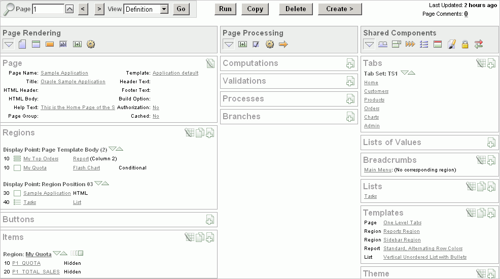

You use the Application Builder component of Oracle Application Express to build your application. Through wizards or your direct input, you can assemble an HTML interface (or application) on top of database objects such as tables and procedures. Each application is a collection of linked pages using tabs, buttons, or hypertext links.
A page is the basic building block of an application. Pages also contain user interface elements such as tabs, lists, buttons, items, and regions. To see the definition of each page belonging to your application, you use the Page Definition page.
Description of gtst_pgdef1.gif follows
The Page Definition contains three main areas:
