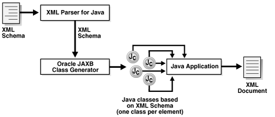

Figure 8-1 depicts the process flow of a framework that uses the JAXB class generator.
Figure 8-1 JAXB Class Generator for Java
This graphic is described in the following text.
Description of "Figure 8-1 JAXB Class Generator for Java"
The basic stages of the process illustrated in Figure 8-1 are as follows:
  1. The XML parser parses the XML schema and sends the parsed data to the JAXB class generator.
  2. The class generator creates Java classes and interfaces based on the input XML schema.
    By default, one XML element or type declaration generates one interface and one class. For example, if the schema defines an element named <anElement>, then by default the JAXB class generator generates a source file named AnElement.java and another named AnElementImpl.java. You can use customize binding declarations to override the default binding of XML Schema components to Java representations.
  3. The Java compiler compiles the .java source files into class files. All of the generated classes, source files, and application code must be compiled.
  4. Your Java application uses the compiled classes and the binding framework to perform the following types of tasks:
    • Create a JAXB context. You use this context to create the marshaller and unmarshaller.
    • Build object trees representing XML data that is valid against the XML schema. You can perform this task by either unmarshalling the data from an XML document that conforms to the schema or instantiating the classes.
    • Access and modify the data.
    • Optionally validate the modifications to the data relative to the constraints expressed in the XML schema.
    • Marshal the data to new XML documents.
