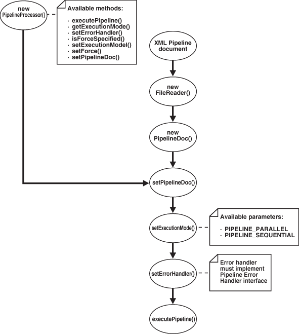

Figure 9-2 illustrates how to pass a pipeline document to a Java application that uses the XML Pipeline processor, configure the processor, and execute the pipeline.
Figure 9-2 Using the Pipeline Processor for Java
The program flow of an XML Pipeline processor application.
Description of "Figure 9-2 Using the Pipeline Processor for Java"
The basic steps are as follows:
  1. Instantiate a pipeline document, which forms the input to the pipeline execution. Create the object by passing a FileReader to the constructor as follows:
    PipelineDoc pipe;
    FileReader f;
    pipe = new PipelineDoc((Reader)f, false);
  2. Instantiate a pipeline processor. PipelineProcessor is the top-level class that executes the pipeline. Table 9-3 describes some of the available methods.
    Table 9-3 PipelineProcessor Methods
    Method Description
    executePipeline()
    Executes the pipeline based on the PipelineDoc set by invoking setPipelineDoc().
    getExecutionMode()
    Gets the type of execution mode: PIPELINE_SEQUENTIAL or PIPELINE_PARALLEL.
    setErrorHandler()
    Sets the error handler for the pipeline. This call is mandatory to execute the pipeline.
    setExecutionMode()
    Sets the execution mode. PIPELINE_PARALLEL is the default and specifies that the processes in the pipeline should execute in parallel. PIPELINE_SEQUENTIAL specifies that the processes in the pipeline should execute sequentially.
    setForce()
    Sets execution behavior. If TRUE, then the pipeline executes regardless of whether the target is up-to-date with respect to the pipeline inputs.
    setPipelineDoc()
    Sets the PipelineDoc object for the pipeline.
    The following statement instantiates the pipeline processor:
    proc = new PipelineProcessor();
  3. Set the processor to the pipeline document. For example:
    proc.setPipelineDoc(pipe);
  4. Set the execution mode for the processor and perform any other needed configuration. For example, set the mode by passing a constant to PipelineProcessor.setExecutionMode().
    The following statement specifies sequential execution:
    proc.setExecutionMode(PipelineConstants.PIPELINE_SEQUENTIAL);
  5. Instantiate an error handler. The error handler must implement the PipelineErrorHandler interface. For example:
    errHandler = new PipelineSampleErrHdlr(logname);
  6. Set the error handler for the processor by invoking setErrorHandler(). For example:
    proc.setErrorHandler(errHandler);
  7. Execute the pipeline. For example:
    proc.executePipeline();

Writing a Pipeline Processor Application
The PipelineSample.java source file illustrates a basic pipeline application. You can use the application with any of the pipeline documents in Table 9-4 to parse and transform an input XML document.
The basic steps of the program are as follows:
  1. Perform the initial setup. The program declares references of type FileReader (for the input XML file), PipelineDoc (for the input pipeline document), and PipelineProcessor (for the processor). The first argument is the pipeline document, which is required. If a second argument is received, then it is stored in the logname String. The following code fragment illustrates this technique:
    public static void main(String[] args)
      FileReader f;
      PipelineDoc pipe;
      PipelineProcessor proc;
      if (args.length < 1)
        System.out.println("First argument needed, other arguments are ".
                           "optional:");
        System.out.println("pipedoc.xml <output_log> <'seq'>");
        return;
      if (args.length > 1)
        logname = args[1];
  2. Create a FileReader object by passing the first command-line argument to the constructor as the filename. For example:
    f = new FileReader(args[0]);
  3. Create a PipelineDoc object by passing the reference to the FileReader object. The following example casts the FileReader to a Reader and specifies no validation:
  4. Instantiate an XML Pipeline processor. The following statement instantiates the pipeline processor:
  5. Set the processor to the pipeline document. For example:
  6. Set the execution mode for the processor and perform any other configuration. The following code fragment uses a condition to determine the execution mode. If three or more arguments are passed to the program, then it sets the mode to sequential or parallel depending on which argument is passed. For example:
    String execMode = null;
    if (args.length > 2)
       execMode = args[2];
       if(execMode.startsWith("seq"))
       else if (execMode.startsWith("para"))
          proc.setExecutionMode(PipelineConstants.PIPELINE_PARALLEL);
  7. Instantiate an error handler. The error handler must implement the PipelineErrorHandler interface. The program uses the PipelineSampleErrHdler shown in PipelineSampleErrHdlr.java. The following code fragment illustrates this technique:
  8. Set the error handler for the processor by invoking setErrorHandler(). The following statement illustrates this technique:
  9. Execute the pipeline. The following statement illustrates this technique:
