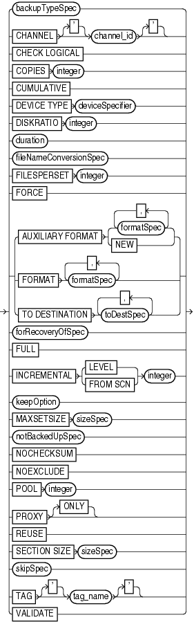

backupOperand::=
Description of backupoperand.gif follows

backupOperand
This subclause specifies options such as the device type and output format. Refer to backupOperand::= for the syntax diagram.
Syntax Element Description
backupTypeSpec Specifies the type of backup being created, either backup sets (AS BACKUPSET) or image copies (AS COPY).
See Also: backupTypeSpec for details
CHANNEL channel_id Specifies the case-sensitive name of a channel to use when creating backups. Use any meaningful name, for example ch1 or dev1. The database uses the channel ID to report I/O errors. If you do not set this parameter, then RMAN dynamically assigns the backup sets to any available channels during execution.
As shown in Example 2-23, you can use CHANNEL to specify which channels back up which files.
Note: You can also specify this parameter in the backupSpec clause.
CHECK LOGICAL Tests data and index blocks that pass physical corruption checks for logical corruption (see Example 2-25). This option typically adds 1-3% overhead.
Examples of logical corruption are corruption of a row piece or index entry. If RMAN finds logical corruption, then it logs the block in the alert log and server session trace file. The SET MAXCORRUPT command specifies the total number of physical and logical corruptions permitted in a data file.
By default, the BACKUP command computes a checksum for each block and stores it in the backup. If you specify the NOCHECKSUM option, then RMAN does not perform a checksum of the blocks when writing the backup.
If SET MAXCORRUPT and NOCHECKSUM are not set, then CHECK LOGICAL detects all types of corruption that are possible to detect during a backup.
COPIES integer Sets the number of identical backups (1 - 4) that RMAN creates. The default value is 1.
You can use multiple format strings to specify different names and locations for the copies. Example 2-22 illustrates a duplexed backup to different locations on disk.
RMAN can duplex backups to either disk or tape, but cannot duplex backups to tape and disk simultaneously. When backing up to tape, ensure that the number of copies does not exceed the number of available tape devices. Also, if COPIES is greater than 1, then the BACKUP_TAPE_IO_SLAVES initialization parameter must be enabled on the target database.
You can specify duplexing in multiple commands. The order of precedence is as follows, with settings higher on the list overriding lower settings:
  1. BACKUP COPIES
  2. SET BACKUP COPIES
  3. CONFIGURE ... BACKUP COPIES
Note: This option does not apply with AS COPY and results in an error message.
Note: Duplexing cannot be used when creating files in the fast recovery area.
CUMULATIVE Copies the data blocks used since the most recent level 0 backup (see Example 2-16).
DEVICE TYPE deviceSpecifier Allocates automatic channels for the specified device type only. For example, if you configure disk and tape channels, then configure sbt as the default device type, then the following command allocates disk channels only:
BACKUP DEVICE TYPE DISK DATABASE;
The DEVICE TYPE option is valid only for automatic channels and is not valid for manually allocated channels. You cannot use the DEVICE TYPE option for a device other than DISK if you have not run CONFIGURE DEVICE TYPE for this device.
Note: To specify a disk channel for the BACKUP RECOVERY AREA command, you must use the TO DESTINATION of the subclause toDestSpec.
See Also: deviceSpecifier
DISKRATIO integer Directs RMAN to populate each backup set with data files from at least integer disks.
This parameter is only enabled when you are backing up data files or control files, and when the operating system can give RMAN disk contention and node affinity data. To manually disable this feature, set DISKRATIO to 0.
For example, assume that data files are distributed across 10 disks. If the disks supply data at 10 bytes/second, and if the tape drive requires 50 bytes/second to keep streaming, then set DISKRATIO to 5 to direct RMAN to include data files from at least 5 disks in each backup set.
If you set FILESPERSET but not DISKRATIO, then DISKRATIO defaults to the same value as FILESPERSET. If you specify neither parameter, then DISKRATIO defaults to 4. RMAN compares the DISKRATIO value to the actual number of devices involved in the backup and uses the lowest value. For example, if DISKRATIO is 4 and the data files are located on three disks, then RMAN attempts to include data files from three disks in each backup set.
The DISKRATIO parameter is easier for data file backups when the data files are striped or reside on separate disk spindles and you either:
  • Use a high-bandwidth tape drive that requires several data files to be multiplexed to keep the tape drive streaming.
  • Make backups while the database is open and you must spread the I/O load across several disk spindles to leave bandwidth for online operations.
Note: Do not spread I/O over more than the minimum number of disks required to keep the tape streaming. Otherwise, you increase restore time for a file without increasing performance.
duration Specifies options related to the maximum time for a backup command to run.
See Also: duration
fileNameConversionSpec This option is valid only when BACKUP is creating image copies. Files being copied are renamed according to the specified patterns. If a file being backed up has a name that does not match any of the specified rename patterns, then RMAN uses FORMAT to name the output image copies. If no FORMAT is specified, then RMAN uses the default format %U.
See Also: fileNameConversionSpec for file renaming patterns
FILESPERSET integer Specifies the maximum number of input files to include in each output backup set. This parameter is only relevant when BACKUP generates backup sets.
RMAN backs up the files in each backupSpec as one or more backup sets. When the number of files in each backupSpec exceeds the FILESPERSET setting, then RMAN splits the files into multiple backup sets accordingly. The default value for FILESPERSET is 64.
The RMAN behavior is illustrated by the following BACKUP commands:
BACKUP AS BACKUPSET (DATAFILE 3, 4, 5, 6, 7) (DATAFILE 8, 9);
BACKUP AS BACKUPSET DATAFILE 3, 4, 5, 6, 7, 8, 9;
BACKUP AS BACKUPSET DATAFILE 3, ... 72;
In the first command, RMAN places data files 3, 4, 5, 6, and 7 into one backup set and data files 8 and 9 into another backup set. In the second command, RMAN places all data files into one backup set. In the third command, the ellipses indicate data files 3 through 72. Because in this case RMAN is backing up 70 data files, RMAN places 64 files in one backup set and 6 in another.
By default, RMAN divides files among backup sets to make optimal use of channel resources. The number of files to be backed up is divided by the number of channels. If the result is less than 64, then this number is the FILESPERSET value. Otherwise, FILESPERSET defaults to 64.
Note: You cannot specify the number of backup pieces that are in a backup set.
FORCE Forces RMAN to ignore backup optimization. That is, even if CONFIGURE BACKUP OPTIMIZATION is set to ON, RMAN backs up all specified files.
Note: You can also specify this option in the backupSpecOperand clause.
AUXILIARY FORMAT Copies the files on the target database to the specified location on the auxiliary instance. RMAN can only generate image copies when AUXILIARY FORMAT is specified. RMAN must be connected to both TARGET and AUXILIARY instances and have access to auxiliary channels.
You can use the BACKUP AUXILIARY FORMAT command to copy data files, archived logs, controlfile, and server parameter file (spfile) over the network between primary and standby databases. For example, if a data file on a primary database was lost, you could CONNECT to the standby database as TARGET and the primary database as AUXILIARY, and copy an intact data file from the standby host to the primary host.
See Also:Example 2-30, "Copying Archived Log From Operating System File to ASM"
   formatSpec Specifies a pattern for naming the output image copies on an auxiliary instance. The path must be valid on the auxiliary host.
See Also: formatSpec for valid substitution variables
   NEW Creates an image copy in the directory specified in the DB_CREATE_FILE_DEST initialization parameter of the auxiliary instance. The image copy is an Oracle-managed file.
FORMAT formatSpec Specifies a pattern for naming the output backup pieces or image copies (see Example 2-17). For AS COPY, if one or more of the directories mentioned in the specified format does not exist, then RMAN signals an error.
The default location for disk backups depends on whether a fast recovery area is enabled and whether FORMAT is specified:
  • If a fast recovery area is enabled, and if you do specify FORMAT, then RMAN names the output files according to the FORMAT setting. If no location is specified in FORMAT, then RMAN creates the backup in a platform-specific location—not in the recovery area.
  • If a fast recovery area is enabled, and if you do not specify FORMAT, then RMAN creates the backup in the recovery area and uses the substitution variable %U to name the backup.
  • If a fast recovery area is not enabled, and if you do not specify FORMAT, then RMAN creates the backup in a platform-specific location and uses %U to name the backup.
To create RMAN backups in the fast recovery area with names in Oracle Managed Files format, do not specify the FORMAT clause on the BACKUP command or channel.
Note: You cannot specify an Oracle Managed Files file name as the format for a backup. For example, if +DISK1/datafile/system.732.609791431 is an OMF file name, then you cannot specify this file name in the FORMAT parameter.
Backup pieces must have unique names. The maximum length of a backup piece file name is platform-specific. For backups to a media manager, the length is also limited by the limit in the supported version of the media management API. Vendors supporting SBT 1.1 must support file names up to 14 characters. Some SBT 1.1 vendors may support longer file names. Vendors supporting SBT 2.0 must support file names up to 512 characters. Some SBT 2.0 vendors may support longer file names.
You cannot specify multiple, identical FORMAT strings within a single backupSpec (for example, BACKUP DATAFILE 3 TO '/tmp/df3.f', DATAFILE 4 TO '/tmp/df4.f'). However, RMAN permits a single FORMAT string to exist in multiple backupSpec clauses.
Note: If you are making an archival backup with the KEEP option (see Example 2-26), then the format string must contain %U. The autobackup also uses this format string.
TO DESTINATION toDestSpec Specifies the directory where the backup is created. This parameter is valid for disk and not SBT channels. The backup files are created in an Oracle Managed Files (OMF) directory. Backup skips the files only when backups do not exist in the specified TO DESTINATION.
forRecoveryOfSpec Identifies the backup being created as an incremental backup to be used in rolling forward an image copy.
See Also: forRecoveryOfSpec
FULL Creates a backup of all blocks of data files included in the backup. FULL is the opposite of INCREMENTAL. RMAN makes full backups by default if neither FULL nor INCREMENTAL is specified.
A full backup has no effect on subsequent incremental backups and is not considered a part of any incremental backup strategy. A full image copy backup can be incrementally updated, however, by applying incremental backups with the RECOVER command.
Note: Unused block compression, which is described in the entry for BACKUP AS BACKUPSET, causes some data file blocks to be skipped during full backups.
INCREMENTAL LEVEL integer Copies only those data blocks that have changed since the last incremental integer backup, where integer is 0 or 1 (see Example 2-16).
See "Incremental Backups" for an explanation of incremental backups.
INCREMENTAL FROM SCN integer Creates an incremental backup of all specified data files that includes all data file blocks changed at SCNs greater than or equal to the specified SCN.
One use of this option is to refresh a standby database with changes from the primary database (see Example 2-24, and the chapter on RMAN backups in Oracle Data Guard Concepts and Administration). This backup contains all changed blocks since the standby database was created or last synchronized. At the standby database, you can use RECOVER with NOREDO to apply the incremental backup. All changed blocks captured in the incremental backup are applied at the standby database, bringing it current with the primary database.
If you are not making incremental backups based on Volume Shadow Copy Service (VSS) snapshots, then you should specify formatSpec when you specify INCREMENTAL FROM SCN. The FORMAT string should include substitution variables such as %U because RMAN generates a control file backup.
If you specify FROM SCN with the NOKEEP option, and if you do not specify formatSpec when you specify INCREMENTAL FROM SCN, then RMAN creates incremental backups in the fast recovery area so that you can create incremental backups based on VSS snapshots in a Windows environment. In this way, you can use incremental backup sets and VSS shadow copies in conjunction. Specify the checkpoint SCN value in the FROM SCN parameter identical to the BACKUP_CHECKPOINT value in the VSS backup metadata document. If block change tracking is enabled, then the backups use the change tracking mechanism, which significantly reduces the time taken to create incremental backups. RMAN can apply incremental backups from the fast recovery area during recovery transparently.
Note: You cannot use PLUS ARCHIVELOG when also specifying INCREMENTAL FROM SCN.
See Also: Oracle Database Platform Guide for Microsoft Windows to learn about making backups with VSS
keepOption Overrides any configured retention policy for this backup so that the backup is not considered obsolete, as shown in Example 2-26.
You can use the KEEP syntax to generate archival database backups that satisfy business or legal requirements. The KEEP setting is an attribute of the backup set (not individual backup piece) or image copy.
Note: You cannot use KEEP with BACKUP BACKUPSET.
With the KEEP syntax, you can keep the backups so that they are considered obsolete after a specified time (KEEP UNTIL), or make them never obsolete (KEEP FOREVER). As shown in Example 2-27, you must be connected to a recovery catalog when you specify KEEP FOREVER.
Note: You can use CHANGE to alter the status of a backup generated with KEEP.
See Also: keepOption for more information about backups made with the KEEP option
MAXSETSIZE sizeSpec Specifies a maximum size for a backup set (as shown in Example 2-17). RMAN limits all backup sets to this size.
It is possible for a backup set to span multiple tapes, so blocks from each data file are written to multiple tapes. If one tape of a multivolume backup set fails, then you lose the data on all the tapes rather than just one. Because a backup set always include a whole file rather than part of a file, you can use MAXSETSIZE to specify that each backup set should fit on one tape.
Specify size in bytes (default), kilobytes (K), megabytes (M), or gigabytes (G). For example, to limit a backup set to 3 MB, specify MAXSETSIZE 3M. The default size is in bytes, rounded down from kilobytes. For example, MAXSETSIZE 3000 is rounded down to 2 KB (2048 bytes). The minimum value must be greater than or equal to the database block size.
The default number of files in each backup set is determined by FILESPERSET, which defaults to 64. When you specify MAXSETSIZE, RMAN attempts to limit the size in bytes of the backup sets according to the MAXSETSIZE parameter. The limit on the number of files in a backup set apply even if the total size of the resulting backup set is less than MAXSETSIZE.
Note: This option results in an error message if used with BACKUP AS COPY. If you run BACKUP AS COPY on a channel that has MAXSETSIZE set, then MAXSETSIZE is silently ignored.
notBackedUpSpec Limits the set of archived redo log files to be backed up according to whether a specified number of backups are present (and not obsolete), or whether the logs have been backed up since a specified date.
See Also: notBackedUpSpec
NOCHECKSUM Suppresses block checksums during the backup.
A checksum is a number that is computed from the contents of a data block. DB_BLOCK_CHECKSUM is a database initialization parameter that controls the writing of checksums for the blocks in data files in the database (not backups). If DB_BLOCK_CHECKSUM is typical, then the database computes a checksum for each block during normal operations and stores it in the block before writing it to disk. When the database reads the block from disk later, it recomputes the checksum and compares it to the stored value. If they do not match, then the block is damaged.
Note: You cannot disable checksums for data files in the SYSTEM tablespace even if DB_BLOCK_CHECKSUM=false.
By default, the BACKUP command computes a checksum for each block and stores it in the backup. The BACKUP command ignores the values of DB_BLOCK_CHECKSUM because this initialization parameter applies to data files in the database, not backups. If you specify the NOCHECKSUM option, then RMAN does not perform a checksum of the blocks when writing the backup.
When restoring a backup data file, RMAN honors the DB_BLOCK_CHECKSUM initialization parameter setting. RMAN clears the checksum if DB_BLOCK_CHECKSUM is set to false. If set to typical, then RMAN verifies the checksum when restoring from the backup and writing to the data file.
Note: You can turn off checksum checking by specifying NOCHECKSUM, but other physical consistency checks, such as checks of the block headers and footers, cannot be disabled.
See Also: Oracle Database Reference for more information about the DB_BLOCK_CHECKSUM initialization parameter
NOEXCLUDE When specified on a BACKUP DATABASE or BACKUP COPY OF DATABASE command, RMAN backs up all tablespaces, including any for which a CONFIGURE EXCLUDE command has been entered. This option does not override SKIP OFFLINE or SKIP READONLY.
POOL integer Specifies the media pool in which the backup is stored. Consult your media management documentation to see whether POOL is supported.
Note: This option does not work with AS COPY and results in an error.
PROXY Backs up the specified files with the proxy copy functionality, which gives the media management software control over the data transfer between storage devices and the data files on disk. The media manager—not RMAN—decides how and when to move data.
When you run BACKUP with the PROXY option, RMAN performs these steps:
  1. Searches for a channel of the specified device type that is proxy-capable. If no such channel is found, then RMAN issues a warning and attempts a a conventional (that is, non-proxy) backup of the specified files.
  2. If RMAN locates a proxy-capable channel, then it calls the media manager to check if it can proxy copy the files. If the media manager cannot proxy copy, then RMAN uses conventional backup sets to back up the files.
Note: If you specify PROXY, then the %p variable must be included in the FORMAT string either explicitly or implicitly within %U.
   ONLY Causes the database to issue an error message when it cannot proxy copy rather than creating conventional backup sets. If you do not want RMAN to try a conventional copy when a proxy copy fails, use the ONLY option
REUSE Enables RMAN to overwrite an existing backup or copy with the same file name as the file that BACKUP is currently creating.
SECTION SIZE sizeSpec Specifies the size of each backup section produced during a data file backup.
By setting this parameter, RMAN can create a multisection backup. In a multisection backup, RMAN creates a backup piece that contains one file section, which is a contiguous range of blocks in a file. All sections of a multisection backup are the same size. You can create a multisection backup for a data file, but not a data file copy.
File sections enable RMAN to create multiple steps for the backup of a single large data file. RMAN channels can process each step independently and in parallel, with each channel producing one section of a multisection backup set.
If you specify a section size that is larger than the size of the file, then RMAN does not use multisection backup for the file. If you specify a small section size that would produce more than 256 sections, then RMAN increases the section size to a value that results in exactly 256 sections.
Depending on where you specify this parameter in the RMAN syntax, you can specify different section sizes for different files in the same backup job.
Note: You cannot use SECTION SIZE with MAXPIECESIZE or with INCREMENTAL LEVEL 1.
skipSpec Excludes data files or archived redo log files from the backup if they are inaccessible, offline, or read-only.
See Also: skipSpec for details.
TAG tag_name Specifies a user-specified tag name for a backup set, proxy copy, data file copy, or control file copy. The tag is applied to the output files generated by the BACKUP command.
The tag name is not case-sensitive. The name must be 30 characters or less. The characters are limited to the characters that are valid in file names on the target file system. For example, ASM does not support the use of the hyphen (-) character in the file names it uses internally, so weekly-incremental is not a valid tag name for backups in ASM disk groups. Environment variables are not valid in the TAG parameter.
Typically, a tag name is a meaningful name such as MON_PM_BKUP or WEEKLY_FULL_BKUP. Tags are reusable, so that backup set 100 can have the tag MON_PM_BKUP one week while backup set 105 has the same tag the next week.
If you do not specify a tag name, then by default RMAN creates a tag for backups (except for control file autobackups). The default tag uses the format TAGYYYYMMDDTHHMMSS, where YYYY is the year, MM is the month, DD is the day, HH is the hour (in 24-hour format), MM is the minutes, and SS is the seconds. For example, a backup of data file 1 might receive the tag TAG20070208T133437. The date and time refer to when RMAN started the backup. If multiple backup sets are created by one BACKUP AS BACKUPSET command, then each backup piece is assigned the same default tag.
You can also specify the tag at the backupSpec level. If you specify the tag at:
  • The command level, then all backup sets created by the command have the tag.
  • The backupSpec level, then backup sets created with different backup specifications can have different tags.
  • Both levels, then the tag in the backupSpec takes precedence.
Note: A tag is an attribute of each backup piece in a given copy of a backup set (for AS BACKUPSET) or each image copy (for AS COPY). For example, if you run BACKUP AS BACKUPSET COPIES 1 DATABASE TAG TUE_PM, then only one copy of the backup set exists and each backup piece has tag TUE_PM. Assume that this backup set has primary key 1234. If you then run BACKUP BACKUPSET 1234 TAG WED_PM, then the first copy of the backup set has tag TUE_PM and the second copy of the backup set has tag WED_PM.
VALIDATE Scans the specified files and verifies their contents, testing whether this file can be backed up and whether the data blocks are corrupt.
RMAN creates no output files. This option is equivalent to using the VALIDATE command on the database files specified in the backup.
If you do not specify CHECK LOGICAL, then BACKUP VALIDATE checks for physical corruption only. If you specify CHECK LOGICAL, then BACKUP VALIDATE checks for both physical and logical corruption. RMAN populates the V$DATABASE_BLOCK_CORRUPTION view with any corruptions that it finds.
You can use the SET MAXCORRUPT command to set a limit for the number of corrupt blocks tolerated during the backup validation. The default is zero.
If you execute BACKUP INCREMENTAL with VALIDATE, then the behavior depends on whether block change tracking is enabled. If change tracking is enabled, then RMAN validates only changed blocks; otherwise, RMAN validates all blocks in the files included in the backup.
Note: You cannot validate backups of backup sets.
