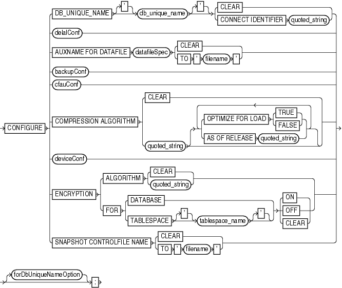

Syntax
configure::=
Description of configure.gif follows
(datafileSpec::=, backupConf::=, cfauConf::=, deviceConf::=, forDbUniqueNameOption::=)

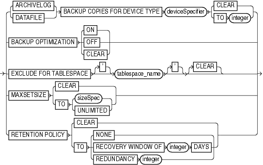

backupConf::=
Description of backupconf.gif follows
(deviceSpecifier::=, sizeSpec::=)

Semantics
configure
Syntax Element Description
DB_UNIQUE_NAME
db_unique_name
{CLEAR | CONNECT IDENTIFIER
'connect_string'}
Specifies the net service name for the physical standby database specified by DB_UNIQUE_NAME. The CONNECT IDENTIFIER string must not include the database user name and password.

delalConf Configures an archived redo log deletion policy.
AUXNAME FOR DATAFILE
datafileSpec TO 'filename'
Configures the auxiliary file name for the specified target data file to 'filename' (see Example 2-45). Specify CLEAR to unspecify the auxiliary file name.
If you are performing TSPITR or using DUPLICATE, then you can set AUXNAME to preconfigure the file names for use on the auxiliary database without manually specifying the auxiliary file names during the procedure. You cannot use CONFIGURE AUXNAME for recovery set, you must use SET NEWNAME.
For example, use this command during TSPITR if the data files are on raw disk and you must restore auxiliary data files to raw disk for performance reasons. Typically, you set the AUXNAME parameter in TSPITR for the data files of the SYSTEM and SYSAUX tablespaces and the tablespaces containing rollback or undo segments. Do not overlay files which are in use by the production database and can be discarded after TSPITR completes. In essence, the AUXNAME of a data file is the location where TSPITR can create a temporary copy of it.
When renaming files with the DUPLICATE command, CONFIGURE AUXNAME is an alternative to SET NEWNAME. The difference is that after you set the AUXNAME the first time, you do not need to reset the file name when you issue another DUPLICATE command: the AUXNAME setting remains in effect until you issue CONFIGURE AUXNAME ... CLEAR. In contrast, you must reissue the SET NEWNAME command every time you execute the DUPLICATE command.
See Also: Oracle Database Backup and Recovery User's Guide to learn how to perform RMAN TSPITR, and Oracle Database Backup and Recovery User's Guide to learn how to duplicate a database with RMAN
backupConf Configures default backup options such as duplexing, optimization, excluding tablespaces, backup set sizes, and retention policies.
cfauConf Configures control file autobackup settings.
COMPRESSION ALGORITHM
'algorithm_name'
Specifies the algorithm that RMAN uses to create compressed backup sets.

deviceConf Configures default backup settings for devices, such as the default backup device, channel configurations for devices, default backup types for each device, and parallelism.
ENCRYPTION Specifies transparent-mode encryption settings for the database or tablespaces.
This configuration applies unless overridden with the SET ENCRYPTION command. Options specified for an individual tablespace take precedence over options specified for the whole database.
See Also: "Encryption of Backup Sets" to learn about the different modes of backup encryption, and Oracle Database Advanced Security Administrator's Guide to learn about transparent data encryption
   ALGORITHM
   'algorithm_name'
Specifies the default algorithm to use for encryption when writing backup sets. Possible values are listed in V$RMAN_ENCRYPTION_ALGORITHMS. The CLEAR option resets the database to the default value.
   FOR DATABASE
   [ON | OFF | CLEAR]
Specifies whether to enable transparent encryption for the entire database. The options are as follows:

SNAPSHOT CONTROLFILE
NAME TO 'filename'
Configures the snapshot control file name and location to 'filename'. If you run CONFIGURE SNAPSHOT CONTROLFILE NAME CLEAR, then RMAN sets the snapshot control file name to its default.
The default value for the snapshot control file name is platform-specific and dependent on Oracle home. For example, the default on some UNIX systems is ?/dbs/snapcf_@.f. If you clear the control file name, and if you change Oracle home, then the default location of the snapshot control file changes as well.
The snapshot control file name is valid for this database only. Assume that you configure the snapshot control file name to a nondefault value on the primary database. If you use DUPLICATE to create a standby database, then the snapshot control file location on the standby database is set to the default value. If desired, you can then configure the snapshot location on the standby database to a nondefault value.
See Also: Oracle Database Backup and Recovery User's Guide for more information about snapshot control files

backupConf
This subclause manages persistent configurations relating to the BACKUP command. One configuration is backup optimization. If you enable backup optimization, then RMAN does not back up a file to a device type if the identical file is already backed up on the device type.
Table 2-3 explains the criteria used by backup optimization to determine whether a file is identical and can potentially be skipped. The table also explains the algorithm that RMAN uses when backup optimization is enabled and it needs to determine whether to skip the backup of an identical file. If RMAN does not skip a backup, then it makes the backup exactly as specified.
{ARCHIVELOG | DATAFILE}
BACKUP COPIES FOR DEVICE TYPE
deviceSpecifier TO integer
Specifies the number of copies of each backup set for DATAFILE (both data files and control files) or ARCHIVELOG files on the specified device type (see Example 2-42). You can create from 1 (default) to 4 copies.
RMAN can duplex backups to either disk or tape, but cannot duplex backups to tape and disk simultaneously. When backing up to tape, ensure that the number of copies does not exceed the number of available tape devices. Also, if COPIES is greater than 1, then the BACKUP_TAPE_IO_SLAVES initialization parameter must be enabled on the target database.
Control file autobackups are never duplexed. Also, duplexing is not permitted in the fast recovery area.
If duplexing is specified in the BACKUP command or in a SET BACKUP COPIES command, then the CONFIGURE setting is overridden.
BACKUP OPTIMIZATION
[ON | OFF | CLEAR]
Toggles backup optimization ON or OFF (default). Specify CLEAR to return optimization to its default value of OFF.
Backup optimization is enabled when all of the following conditions are met:
  • The CONFIGURE BACKUP OPTIMIZATION ON command has been run.
  • You run BACKUP DATABASE, BACKUP ARCHIVELOG with the ALL or LIKE options, BACKUP BACKUPSET ALL, BACKUP RECOVERY AREA, BACKUP RECOVERY FILES, or BACKUP DATAFILECOPY.
  • The RMAN job uses a channel of only one device type.
Optimization prevents RMAN from backing up a file to a device type if the identical file is already backed up on the device type. RMAN does not signal an error if backup optimization causes all files to be skipped during a backup. The backup retention policy affects which files backup optimization skips.
For two files to be identical, their content must be exactly the same, as described in Table 2-3. When you create backup pieces on disk or on media managed by Oracle Secure Backup, optimization excludes undo data from the backup when the data does not belong to an active transaction.
Note: BACKUP ... DELETE INPUT deletes all specified archived redo logs whether or not optimization skips these files during a backup.
Note: You can override backup optimization with the FORCE option of the BACKUP command.
See Also: Oracle Database Backup and Recovery User's Guide for a description of how RMAN determines that it can skip the backup of a file
EXCLUDE FOR TABLESPACE
tablespace_name [CLEAR]
Excludes the specified tablespace from BACKUP DATABASE and RESTORE DATABASE commands (see Example 2-44). You cannot exclude the SYSTEM tablespace.
The BACKUP command default does not exclude tablespaces. You must declare the option to use it. The exclusion is stored as an attribute of the tablespace and not to the individual data files. In this manner, the exclusion applies not only to the present set of data files but also to any files that are added to this tablespace in the future. If you run CONFIGURE ... CLEAR on a tablespace after excluding it, then it returns to the default configuration of nonexclusion.
You can still back up an excluded tablespace by explicitly specifying it in a BACKUP command or by specifying the NOEXCLUDE option on a BACKUP DATABASE command. Similarly, you can restore an excluded tablespace by specifying it in the RESTORE TABLESPACE command.
MAXSETSIZE Specifies the maximum size of each backup set created on a channel. Use the CLEAR option to return MAXSETSIZE to the default value of UNLIMITED.
Note: This option is ignored by BACKUP AS COPY.
   TO sizeSpec Specifies the maximum size of each backup set as integer gigabytes, kilobytes, or megabytes.
   TO UNLIMITED Specifies no size limit for backup sets.
RETENTION POLICY Specifies a persistent, ongoing policy for backup sets and copies that RMAN marks as obsolete, that is, not needed and eligible for deletion.
As time passes, RMAN marks backup sets and copies as obsolete according to the criteria specified in the retention policy. RMAN automatically deletes obsolete backup sets and copies in the fast recovery area when space is needed. RMAN does not automatically delete obsolete files outside the fast recovery area: you must manually execute DELETE OBSOLETE to remove them.
For backups, the basic unit of the retention policy is a backup set (not a backup piece) or image copy. For example, BACKUP AS BACKUPSET COPIES 4 TABLESPACE users creates a single backup set that is duplexed into four identical backup pieces. The retention policy considers this as one backup, not four separate backups.
Note: Use the CLEAR option to return RETENTION POLICY to its default of REDUNDANCY 1.
   TO NONE Disables the retention policy feature. RMAN does not consider any backup sets or copies as obsolete.
   TO RECOVERY WINDOW
   OF integer DAYS
Specifies a time window in which RMAN can recover the database.
The window stretches from the current time (SYSDATE) to the point of recoverability, which is the earliest date to which you want to recover. The point of recoverability is SYSDATE - integer days earlier.
Note: The REDUNDANCY and RECOVERY WINDOW options are mutually exclusive. Only one type of retention policy can be in effect at any time.
   TO REDUNDANCY integer Specifies that RMAN should retain integer full or level 0 backups of each data file and control file. The default retention policy setting is REDUNDANCY 1.
If more than integer full or level 0 backups of a data file or control file exist, then RMAN marks these extra files as obsolete. RMAN then determines the oldest of the retained backups and marks all archived redo log files and log backups older than this backup as obsolete. The DELETE OBSOLETE command removes obsolete data file backups (full or incremental), control file backups, and archived log backups or image copies.
The following scenario illustrates how redundancy works in an incremental backup strategy. Assume that the redundancy level is 1. You run a level 0 database backup at noon Monday, a level 1 cumulative backup at noon on Tuesday and Wednesday, and a level 0 backup at noon on Thursday. Immediately after each daily backup you run a DELETE OBSOLETE. The Wednesday DELETE command does not remove the Tuesday level 1 backup because this backup is not redundant: the Tuesday level 1 backup could be used to recover the Monday level 0 backup to a time between noon on Tuesday and noon on Wednesday. However, the DELETE command on Thursday removes the previous level 0 and level 1 backups.
