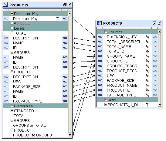

Star Schema
In a star schema implementation, Warehouse Builder stores the dimension data in a single table. Because the same table or view stores data for more than one dimension level, you must specify a dimension key column in the table. The dimension key column is the primary key for the dimension. This column also forms the foreign key reference to the cube.
Each level implements a subset of dimension attributes. By default, the level attribute name is the same as the dimension attribute name. To avoid name conflicts caused by all level data being stored in the same table, Warehouse Builder uses the following guidelines for naming in a star table:
  • If the level attribute name is not unique, Warehouse Builder prefixes it with the name of the level.
  • If the level attribute name is unique, Warehouse Builder does not use any prefix.
To ensure that no prefixes are used, you must explicitly change the level attribute name in the Create Dimension wizard or the Data Object Editor.
For example, if you implement the Products dimension using a star schema, Warehouse Builder uses a single table to implement all the levels in the dimension.
Figure 4-1 Star Schema Implementation of Products Dimension
Description of Figure 4-1 follows
Description of "Figure 4-1 Star Schema Implementation of Products Dimension"
Binding
When you perform binding, you specify the database columns that will store the data of each attribute and level relationship in the dimension. You can perform either auto binding or manual binding for a dimension.
Auto Binding  When you perform auto binding, Warehouse Builder binds the dimension object attributes to the database columns that store their data. When you perform auto binding for the first time, Warehouse Builder also creates the tables that are used to store the dimension data.
When you perform auto binding on a dimension that is already bound, Warehouse Builder uses the following rules:
  • If the implementation method of the dimension remains the same, Warehouse Builder rebinds the dimensional object to the existing implementation objects.
    For example, you create a Products dimension using the star schema implementation method and perform auto binding. The dimension data is stored in a table called PRODUCTS. You modify the dimension definition at a later date but retain the implementation method as star schema. When you now auto bind the Products dimension, Warehouse Builder rebinds the Products dimension attributes to the same implementation tables.
  • If the implementation method of a dimension is changed, Warehouse Builder deletes the old implementation objects and creates a new set of implementation tables. If you want to retain the old implementation objects, you must first unbind the dimensional object and then perform auto binding. For more information about implementation methods, see "Star Schema".
    For example, you create a Products dimension using the star schema implementation method and bind it to the implementation table. You now edit this dimension and change its implementation method to snowflake schema. When you now perform auto binding for the modified Products dimension, Warehouse Builder deletes the table that stores the dimension data, creates new implementation tables, and binds the dimension attributes and relationships to the new implementation tables.

Manual Binding You would typically use manual binding to bind existing tables to a dimension. Use manual binding if no auto binding or rebinding is required.
To perform manual binding for a dimension:
  1. Create the implementation objects (tables or views) that you will use to store the dimension data.
    In the case of relational dimensions, create the sequence used to load the surrogate identifier of the dimension. You can also choose to use an existing sequence.
  2. In the Projects Navigator, right-click the dimension and select Open.
    The Dimension Editor is opened.
  3. Go to the Physical Bindings tab.
  4. From the Component Palette, drag and drop the operator that represents the implementation object onto the canvas.
    Warehouse Builder displays the Add a New or Existing Object dialog box. For example, if the dimension data is stored in a table, drag a Table operator from the Component Palette and drop it onto the canvas. The Add a New or Existing Table dialog box is displayed.
  5. Choose the Select an existing Object option and then select the data object from the list of objects displayed in the selection tree.
  6. Click OK.
    A node representing the object that you just added is displayed on the canvas.
  7. If more than one data object is used to store the dimension data, perform steps 4 to 6 for each data object.
  8. Map the attributes in each level of the dimension to the columns that store their data. Hold down your mouse on the dimension attribute, drag, and then drop on the column that stores the attribute value.
    Also map the level relationships to the database column that store their data.
    For example, for the Products dimension described in "Dimension Example", the attribute Name in the Groups level of the Products dimension is stored in the Group_name attribute of the Products_tab table. Hold down the mouse on the Name attribute, drag, and drop on the Group_name attribute of the Products_tab table.

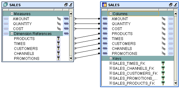

Binding
When you perform binding, you specify the database columns that will store the data of each measure and dimension reference of the cube. You can perform auto binding or manual binding for a cube.
Auto Binding When you perform auto binding, Warehouse Builder creates the table that stores the cube data and then binds the cube measures and references to the database columns. For detailed steps on performing auto binding, see "Auto Binding".
When you perform auto binding for a cube, ensure that you auto bind the dimensions that a cube references before you auto bind the cube. You will not be able to deploy the cube if any dimension that the cube references was auto bound after the cube was last auto bound.
For example, you create the SALES cube that references the TIMES and PRODUCTS dimensions and perform auto binding for the cube. You later modify the definition of the PRODUCTS dimension. If you now attempt to auto bind the SALES cube again, Warehouse Builder generates an error. You must first auto bind the PRODUCTS dimensions and then auto bind the cube.
Manual Binding In manual binding, you must first create the table or view that stores the cube data and then map the cube references and measures to the database columns that store their data. Alternatively, you can use an existing database table or view to store the cube data.
To perform manual binding for a cube:
  1. Create the table or view that stores the cube data.
  2. In the Projects Navigator, right-click the cube and select Open.
    The Cube Editor is opened.
    Warehouse Builder displays the Add a New or Existing Object dialog box. For example, if the cube data is stored in a table, drag a Table operator from the Component Palette and drop it onto the canvas. The Add a New or Existing Table dialog box is displayed.
  5. Choose Select an existing object and then select the data object from the list of objects displayed in the selection tree.
  6. Click OK.
  7. Map the measures and dimension references of the cube to the columns that store the cube data. Hold down your mouse on the measure or dimension reference, drag, and then drop on the data object attribute that stores the measure or dimension reference.
