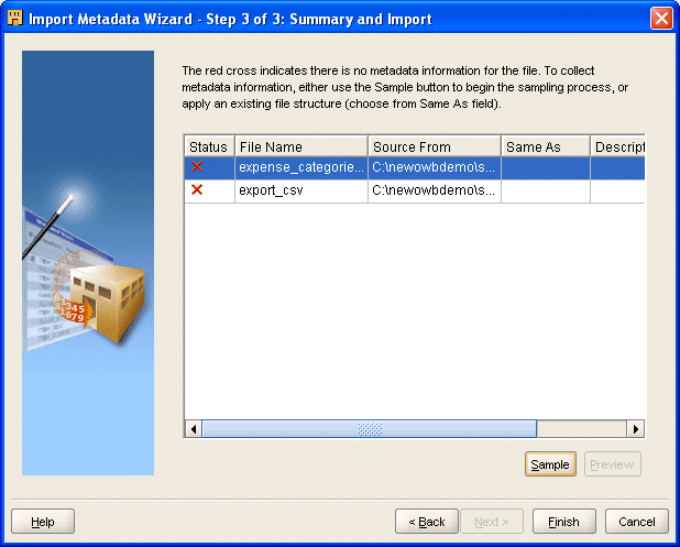

Starting the Import Metadata Wizard
Start the Import Metadata Wizard.
Right-click the module SALES_EXPENSES, select New, and follow the prompts in the Import Metadata Wizard. The prompts in the wizard vary according to the type of module you selected and therefore the type of data object you are importing.
In this example, you selected to import two flat files. On the summary page of the Import Metadata Wizard, select one of the files and then select Sample to launch the Flat File Sample Wizard.
In the next steps, you sample each file in turn and then select Finish on this page to import the metadata.
Figure 3-1 Import Metadata Wizard
Description of Figure 3-1 follows
Description of "Figure 3-1 Import Metadata Wizard"
