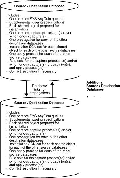

Figure 3-2 shows an example multiple-source Oracle Streams environment.
Figure 3-2 Example Oracle Streams Multiple-Source Environment
Description of Figure 3-2 follows
Description of "Figure 3-2 Example Oracle Streams Multiple-Source Environment"
You can create an Oracle Streams replication environment that is more complicated than the one shown in Figure 3-2. For example, a multiple-source Oracle Streams replication environment can use downstream capture and directed networks.
When there are multiple source databases in an Oracle Streams replication environment, change cycling is possible. Change cycling happens when a change is sent back to the database where it originated. Typically, you should avoid change cycling. Before you configure your replication environment, see Chapter 10, "Oracle Streams Tags", and ensure that you configure the replication environment to avoid change cycling.
