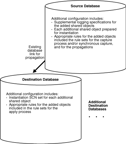

Figure 4-1 shows the additional configuration steps that must be completed to add replicated database objects to a single-source Oracle Streams environment.
Figure 4-1 Example of Adding Replicated Objects to a Single-Source Environment
Description of Figure 4-1 follows
Description of "Figure 4-1 Example of Adding Replicated Objects to a Single-Source Environment"

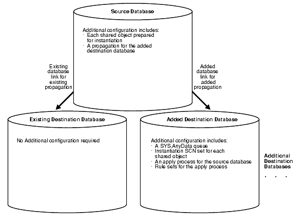

Figure 4-2 shows the additional configuration steps that must be completed to add a destination database to a single-source Oracle Streams environment.
Figure 4-2 Example of Adding a Destination to a Single-Source Environment
Description of Figure 4-2 follows
Description of "Figure 4-2 Example of Adding a Destination to a Single-Source Environment"

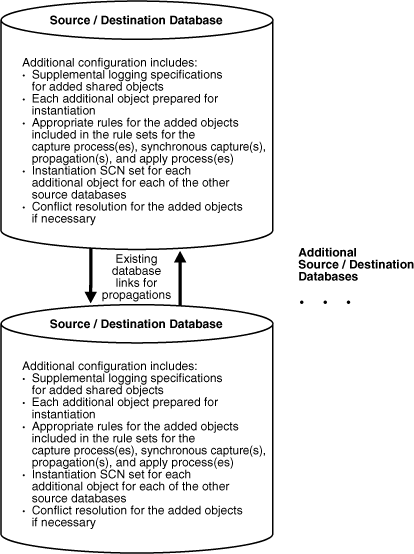

Figure 4-3 shows the additional configuration steps that must be completed to add replicated database objects to a multiple-source Oracle Streams environment.
Figure 4-3 Example of Adding Replicated Objects to a Multiple-Source Environment
Description of Figure 4-3 follows
Description of "Figure 4-3 Example of Adding Replicated Objects to a Multiple-Source Environment"

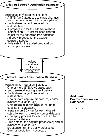

Adding a New Database to an Existing Multiple-Source Environment
Figure 4-4 shows the additional configuration steps that must be completed to add a source/destination database to a multiple-source Oracle Streams environment.
Figure 4-4 Example of Adding a Database to a Multiple-Source Environment
Description of Figure 4-4 follows
Description of "Figure 4-4 Example of Adding a Database to a Multiple-Source Environment"
When there are multiple source databases in an Oracle Streams replication environment, change cycling is possible. Change cycling happens when a change is sent back to the database where it originated. Typically, you should avoid change cycling. Before you configure your replication environment, see Chapter 10, "Oracle Streams Tags", and ensure that you configure the replication environment to avoid change cycling.
Complete the following steps to add a new source/destination database to an existing multiple-source Oracle Streams replication environment:
Ensure that no changes are made to the database objects being replicated at the database you are adding to the Oracle Streams replication environment until the instantiation at the database is complete.
  1. Complete the necessary tasks to prepare each database in your environment for Oracle Streams. See "Tasks to Complete Before Configuring Oracle Streams Replication".
    Some of these tasks might not be required at certain databases.
  2. Create any necessary ANYDATA queues that do not already exist. When you create a capture process, synchronous capture, or apply process, you associate the process with a specific ANYDATA queue. When you create a propagation, you associate it with a specific source queue and destination queue. See "Creating an ANYDATA Queue" for instructions.
  3. Create one or more apply processes at the new database to apply the changes from its source databases. Ensure that each apply process uses rule sets that are appropriate for applying changes. Do not start any apply process at the new database. See Chapter 7, "Configuring Implicit Apply" for instructions.
    Keeping the apply processes stopped prevents changes made at the source databases from being applied before the instantiation of the new database is completed. Starting the apply processes might lead to incorrect data and errors.
  4. If the new database will be a source database, then, at all databases that will be destination databases for the changes made at the new database, create one or more apply processes to apply changes from the new database. Ensure that each apply process uses rule sets that are appropriate for applying changes. Do not start any of these new apply processes. See Chapter 7, "Configuring Implicit Apply" for instructions.
  5. Configure propagations at the databases that will be source databases of the new database to send changes to the new database. Ensure that each propagation uses rule sets that are appropriate for propagating changes. See "Creating Oracle Streams Propagations Between ANYDATA Queues".
  6. If the new database will be a source database, then configure propagations at the new database to send changes from the new database to each of its destination databases. Ensure that each propagation uses rule sets that are appropriate for propagating changes. See "Creating Oracle Streams Propagations Between ANYDATA Queues".
  7. If the new database will be a source database, and the replicated database objects already exist at the new database, then specify any necessary supplemental logging for the replicated database objects at the new database. See "Specifying Supplemental Logging" for instructions.
  8. At each source database for the new database, prepare for instantiation each database object for which changes will be applied by an apply process at the new database.
    If you are using one or more capture processes, then run either the PREPARE_TABLE_INSTANTIATION, PREPARE_SCHEMA_INSTANTIATION, or PREPARE_GLOBAL_INSTANTIATION procedure in the DBMS_CAPTURE_ADM package for the specified table, specified schema, or entire database, respectively.
    If you are using one or more synchronous captures, then run the PREPARE_TABLE_INSTANTIATION procedure in the DBMS_CAPTURE_ADM package for the specified table.
    See "Preparing Database Objects for Instantiation at a Source Database" for instructions.
  9. If the new database will be a source database, then create one or more capture processes or synchronous captures to capture the relevant changes. See Chapter 5, "Configuring Implicit Capture" for instructions. If you plan to use capture processes, then Oracle recommends that you use only one capture process for each source database.
    When you use a procedure in the DBMS_STREAMS_ADM package to add the capture process rules, it automatically runs the PREPARE_TABLE_INSTANTIATION, PREPARE_SCHEMA_INSTANTIATION, or PREPARE_GLOBAL_INSTANTIATION procedure in the DBMS_CAPTURE_ADM package for the specified table, specified schema, or entire database, respectively, if the capture process is a local capture process or a downstream capture process with a database link to the source database.
    You must run the appropriate procedure to prepare for instantiation manually if any of the following conditions is true:
    • You use the DBMS_RULE_ADM package to add or modify rules.
    • You use an existing capture process and do not add capture process rules for any replicated database object.
    • You use a downstream capture process with no database link to the source database.
    If you must prepare for instantiation manually, then see "Preparing Database Objects for Instantiation at a Source Database" for instructions.
    When you use a procedure in the DBMS_STREAMS_ADM package to add the synchronous capture rules, it automatically runs the PREPARE_SYNC_INSTANTIATION function in the DBMS_CAPTURE_ADM package for the specified table.
  10. If the new database will be a source database, then start any capture process you created in Step 9 using the START_CAPTURE procedure in the DBMS_CAPTURE_ADM package, or see Oracle Database 2 Day + Data Replication and Integration Guide for instructions about starting a capture process using Oracle Enterprise Manager.
After completing these steps, complete the steps in the appropriate section:
