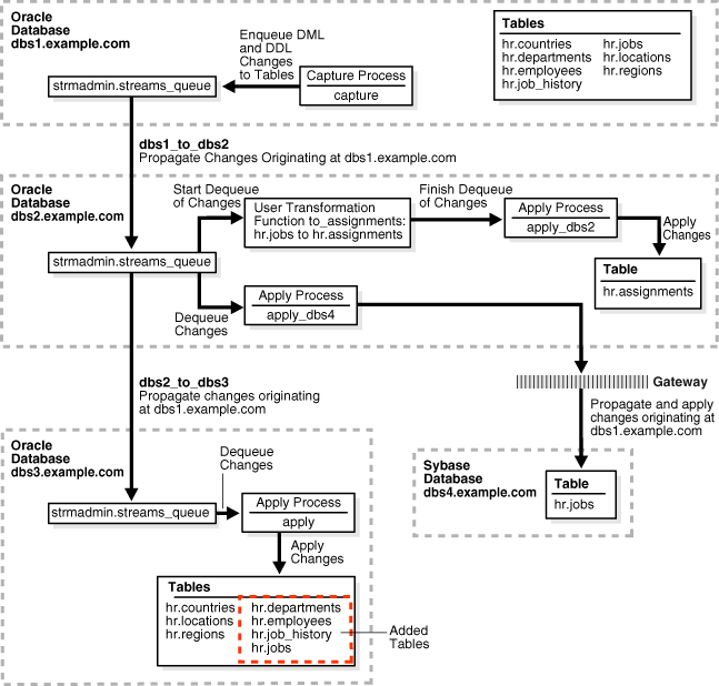

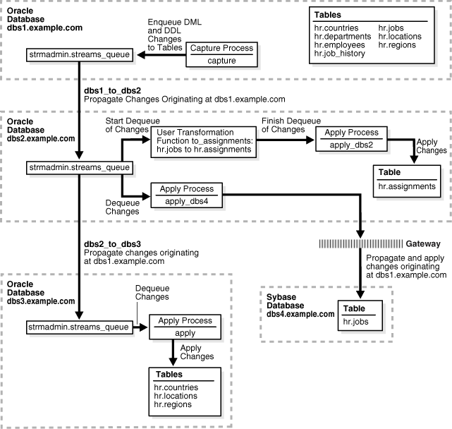

This example illustrates using Oracle Streams to replicate data between four databases. The environment is heterogeneous because three of the databases are Oracle databases and one is a Sybase database. DML and DDL changes made to tables in the hr schema at the dbs1.example.com Oracle database are captured and propagated to the other two Oracle databases. Only DML changes are captured and propagated to the dbs4.example.com database, because an apply process cannot apply DDL changes to a non-Oracle database. Changes to the hr schema occur only at dbs1.example.com. The hr schema is read-only at the other databases in the environment.
Figure 2-1 provides an overview of the environment.
Figure 2-1 Sample Environment that Shares Data from a Single Source Database
Description of Figure 2-1 follows
Description of "Figure 2-1 Sample Environment that Shares Data from a Single Source Database"
As illustrated in Figure 2-1, dbs1.example.com contains the following tables in the hr schema:
This example uses directed networks, which means that captured changes at a source database are propagated to another database through one or more intermediate databases. Here, the dbs1.example.com database propagates changes to the dbs3.example.com database through the intermediate database dbs2.example.com. This configuration is an example of queue forwarding in a directed network. Also, the dbs1.example.com database propagates changes to the dbs2.example.com database, which applies the changes directly to the dbs4.example.com database through an Oracle Database Gateway.
Some of the databases in the environment do not have certain tables. If the database is not an intermediate database for a table and the database does not contain the table, then changes to the table do not need to be propagated to that database. For example, the departments, employees, job_history, and jobs tables do not exist at dbs3.example.com. Therefore, dbs2.example.com does not propagate changes to these tables to dbs3.example.com.
In this example, Oracle Streams is used to perform the following series of actions:
  1. The capture process captures DML and DDL changes for all of the tables in the hr schema and enqueues them at the dbs1.example.com database. In this example, changes to only four of the seven tables are propagated to destination databases, but in the example that illustrates "Add Objects to an Existing Oracle Streams Replication Environment", the remaining tables in the hr schema are added to a destination database.
  2. The dbs1.example.com database propagates these changes in the form of messages to a queue at dbs2.example.com.
  3. At dbs2.example.com, DML changes to the jobs table are transformed into DML changes for the assignments table (which is a direct mapping of jobs) and then applied. Changes to other tables in the hr schema are not applied at dbs2.example.com.
  4. Because the queue at dbs3.example.com receives changes from the queue at dbs2.example.com that originated in countries, locations, and regions tables at dbs1.example.com, these changes are propagated from dbs2.example.com to dbs3.example.com. This configuration is an example of directed networks.
  5. The apply process at dbs3.example.com applies changes to the countries, locations, and regions tables.
  6. Because dbs4.example.com, a Sybase database, receives changes from the queue at dbs2.example.com to the jobs table that originated at dbs1.example.com, these changes are applied remotely from dbs2.example.com using the dbs4.example.com database link through an Oracle Database Gateway. This configuration is an example of heterogeneous support.
This example extends the Oracle Streams environment configured in the previous sections by adding replicated objects to an existing database. To complete this example, you must have completed the tasks in one of the previous examples in this chapter.
This example will add the following tables to the hr schema in the dbs3.example.com database:
When you complete this example, Oracle Streams processes changes to these tables with the following series of actions:
  1. The capture process captures changes at dbs1.example.com and enqueues them at dbs1.example.com.
  2. A propagation propagates changes from the queue at dbs1.example.com to the queue at dbs2.example.com.
  3. A propagation propagates changes from the queue at dbs2.example.com to the queue at dbs3.example.com.
  4. The apply process at dbs3.example.com applies the changes at dbs3.example.com.
When you complete this example, the hr schema at the dbs3.example.com database will have all of its original tables, because the countries, locations, and regions tables were instantiated at dbs3.example.com in the previous section.
Figure 2-2 provides an overview of the environment with the added tables.
Figure 2-2 Adding Objects to dbs3.example.com in the Environment
Description of Figure 2-2 follows
Description of "Figure 2-2 Adding Objects to dbs3.example.com in the Environment"
Complete the following steps to replicate these tables to the dbs3.example.com database.

Step 4   Specify the Table Propagation Rules for the Added Tables at dbs2.example.com
Connect to dbs2.example.com as the strmadmin user.
CONNECT strmadmin@dbs2.example.com
Add the tables to the rules for propagation from the queue at dbs2.example.com to the queue at dbs3.example.com.
BEGIN
  DBMS_STREAMS_ADM.ADD_TABLE_PROPAGATION_RULES(
    table_name               => 'hr.departments',
    streams_name             => 'dbs2_to_dbs3',
    source_queue_name        => 'strmadmin.streams_queue',
    destination_queue_name   => 'strmadmin.streams_queue@dbs3.example.com',
    include_dml              => TRUE,
    include_ddl              => TRUE,
    source_database          => 'dbs1.example.com',
    inclusion_rule           => TRUE);
END;
BEGIN
    table_name              => 'hr.employees',
END;
BEGIN
    table_name              => 'hr.job_history',
END;
BEGIN
    table_name              => 'hr.jobs',
END;
Step 5   Prepare the Four Added Tables for Instantiation at dbs1.example.com
Connect to dbs1.example.com as the strmadmin user.
CONNECT strmadmin@dbs1.example.com
Prepare the tables for instantiation. These tables will be instantiated at dbs3.example.com. This step marks the lowest SCN of the tables for instantiation. SCNs subsequent to the lowest SCN can be used for instantiation. Also, this preparation is necessary so that the Oracle Streams data dictionary for the relevant propagations and the apply process at dbs3.example.com contain information about these tables.
When the PREPARE_TABLE_INSTANTIATION procedure is run in this step, the supplemental_logging parameter is not specified. Therefore, the default value (keys) is used for this parameter. Supplemental logging already was enabled for any primary key, unique key, bitmap index, and foreign key columns in these tables in Step 3.
BEGIN
  DBMS_CAPTURE_ADM.PREPARE_TABLE_INSTANTIATION(
    table_name  => 'hr.departments');
END;
BEGIN
    table_name  => 'hr.employees');
END;
BEGIN
    table_name  => 'hr.job_history');
END;
BEGIN
    table_name  => 'hr.jobs');
END;
