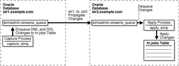

The example in this chapter illustrates using Oracle Streams to replicate data in one table between two databases. A capture process captures data manipulation language (DML) and data definition language (DDL) changes made to the jobs table in the hr schema at the str1.example.com Oracle database, and a propagation propagates these changes to the str2.example.com Oracle database. Next, an apply process applies these changes at the str2.example.com database. This example assumes that the hr.jobs table is read-only at the str2.example.com database.
Figure 1-1 provides an overview of the environment.
Figure 1-1 Simple Example that Shares Data from a Single Source Database
Description of Figure 1-1 follows
Description of "Figure 1-1 Simple Example that Shares Data from a Single Source Database"
