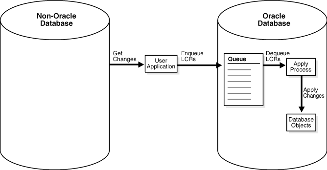

To capture and propagate changes from a non-Oracle database to an Oracle database, a custom application is required. This application gets the changes made to the non-Oracle database by reading from transaction logs, by using triggers, or by some other method. The application must assemble and order the transactions and must convert each change into a logical change record (LCR). Next, the application must enqueue the LCRs in an Oracle database using the DBMS_STREAMS_MESSAGING package or the DBMS_AQ package. The application must commit after enqueuing all LCRs in each transaction. Figure 11-2 shows a non-Oracle databases sharing data with an Oracle database.
Figure 11-2 Non-Oracle to Oracle Heterogeneous Data Sharing
Description of Figure 11-2 follows
Description of "Figure 11-2 Non-Oracle to Oracle Heterogeneous Data Sharing"
Change Capture in a Non-Oracle to Oracle Environment
Because the custom user application is responsible for assembling changes at the non-Oracle database into LCRs and enqueuing the LCRs at the Oracle database, the application is completely responsible for change capture. Therefore, the application must construct LCRs that represent changes at the non-Oracle database and then enqueue these LCRs into the queue at the Oracle database. The application can enqueue multiple transactions concurrently, but the transactions must be committed in the same order as the transactions on the non-Oracle source database.

To ensure the same transactional consistency at both the Oracle database where changes are applied and the non-Oracle database where changes originate, you must use a transactional queue to stage the LCRs at the Oracle database. For example, suppose a single transaction contains three row changes, and the custom application enqueues three row LCRs, one for each change, and then commits. With a transactional queue, a commit is performed by the apply process after the third row LCR, retaining the consistency of the transaction. If you use a nontransactional queue, then a commit is performed for each row LCR by the apply process. The SET_UP_QUEUE procedure in the DBMS_STREAMS_ADM package creates a transactional queue automatically.
Also, the queue at the Oracle database should be a commit-time queue. A commit-time queue orders LCRs by approximate commit system change number (approximate CSCN) of the transaction that includes the LCRs. Commit-time queues preserve transactional dependency ordering between LCRs in the queue, if the application that enqueued the LCRs commits the transactions in the correct order. Also, commit-time queues ensure consistent browses of LCRs in a queue.
Change Apply in a Non-Oracle to Oracle Environment
In a non-Oracle to Oracle environment, the apply process functions the same way as it would in an Oracle-only environment. That is, it dequeues each LCR from its associated queue based on apply process rules, performs any rule-based transformation, and either sends the LCR to a handler or applies it directly. Error handling and conflict resolution also function the same as they would in an Oracle-only environment. So, you can specify a prebuilt update conflict handler or create a custom conflict handler to resolve conflicts.
The apply process should be configured to apply persistent LCRs, not captured LCRs. So, the apply process should be created using the CREATE_APPLY procedure in the DBMS_APPLY_ADM package, and the apply_captured parameter should be set to FALSE when you run this procedure. After the apply process is created, you can use procedures in the DBMS_STREAMS_ADM package to add rules for LCRs to the apply process rule sets.
