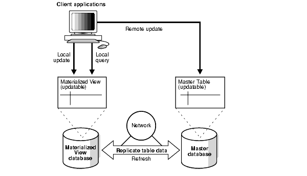

Overview of Updatable Materialized Views
In a more advanced configuration, you can create an updatable materialized view that allows users to insert, update, and delete rows of the target master table or master materialized view by performing these operations on the materialized view. An updatable materialized view can also contain a subset of the data in the target master. Figure 1-3 illustrates a replication environment using updatable materialized views.
Updatable materialized views are based on tables or other materialized views that have been set up to support replication. In fact, updatable materialized views must be part of a materialized view group that is based on another replication group. For changes made to an updatable materialized view to be pushed back to the master during refresh, the updatable materialized view must belong to a materialized view group.
Figure 1-3 Updatable Materialized View Replication
Description of Figure 1-3 follows
Description of "Figure 1-3 Updatable Materialized View Replication"
Updatable materialized views have the following properties.
  • They are always based on a single table, although multiple tables can be referenced in a subquery.
  • They can be incrementally (or fast) refreshed.
  • Oracle propagates the changes made to an updatable materialized view to the materialized view's remote master table or master materialized view. The updates to the master then cascade to all other replication sites.
Updatable materialized views provide the following benefits:
  • Allow users to query and update a local replicated data set even when disconnected from the master site or master materialized view site.
  • Require fewer resources than multimaster replication, while still supporting data updates. Materialized views can reduce the amount of stress placed on network resources because materialized views can be refreshed on demand, while multimaster replication propagates changes at regular intervals. In addition, because materialized views can reside in a database that contains far less data, the disk space and memory requirements for materialized view clients can be less than the requirements for an Oracle server containing master sites.

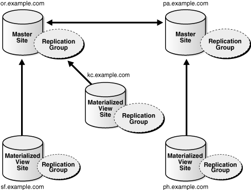

Multimaster and Materialized View Hybrid Configurations
Multimaster replication and materialized views can be combined in hybrid or "mixed" configurations to meet different application requirements. Hybrid configurations can have any number of master sites and multiple materialized view sites for each master.
For example, as shown in Figure 1-4, multimaster (or n-way) replication between two masters can support full-table replication between the databases that support two geographic regions. Materialized views can be defined on the masters to replicate full tables or table subsets to sites within each region.
Figure 1-4 Hybrid Configuration
Description of Figure 1-4 follows
Description of "Figure 1-4 Hybrid Configuration"
Key differences between materialized views and replicated master tables include the following:
  • Replicated master tables must contain data for the full table being replicated, whereas materialized views can replicate subsets of master table data.
  • Multimaster replication enables you to replicate changes for each transaction as the changes occur. Materialized view refreshes are set oriented, propagating changes from multiple transactions in a more efficient, batch-oriented operation, but at less frequent intervals.
  • If conflicts occur because of changes made to multiple copies of the same data, then detection and resolution of conflicts always occurs at a master site or a master materialized view site.

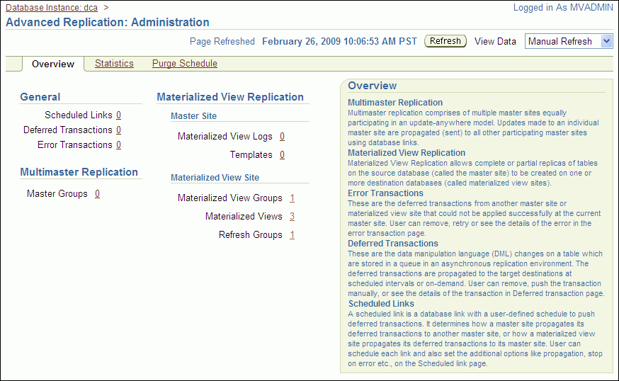

Advanced Replication Interface in Oracle Enterprise Manager
To help configure and administer replication environments, Oracle provides a sophisticated Advanced Replication interface in Oracle Enterprise Manager. To access the Advanced Replication interface, go to the Data Movement subpage in Enterprise Manager. The Advanced Replication interface online Help is the primary documentation source for this tool. Figure 1-5 shows the Advanced Replication interface in Enterprise Manager.
Figure 1-5 Advanced Replication Interface in Enterprise Manager
Description of Figure 1-5 follows
Description of "Figure 1-5 Advanced Replication Interface in Enterprise Manager"
See Also:
The Advanced Replication interface online Help in Oracle Enterprise Manager
