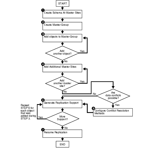

After you have set up your master sites, you are ready to build a master group. As illustrated in Figure 3-2, you must follow a specific sequence to successfully build a replication environment.
See Also:
"Configuring the Replication Sites" for information about setting up master sites
In this chapter, you create the hr_repg master group and replicate the objects illustrated in Figure 3-1.
Figure 3-1 Replicate the Tables in the hr Schema Between All Sites
Description of Figure 3-1 follows
Description of "Figure 3-1 Replicate the Tables in the hr Schema Between All Sites"

Figure 3-2 Creating a Master Group
Description of Figure 3-2 follows
Description of "Figure 3-2 Creating a Master Group"
Complete the following steps to create the hr_repg master group.
If you are viewing this document online, then you can copy the text from the "BEGINNING OF SCRIPT" line after this note to the "END OF SCRIPT" line into a text editor and then edit the text to create a script for your environment.

Step 1   Create the schema at master sites.
If the schema does not exist at all of the master sites participating in the master group, then create the schema now and grant it all of the necessary privileges. This example uses the hr schema, which is one of the sample schemas that are installed by default when you install Oracle. So, the hr schema should exist at all master sites.
PAUSE Press <RETURN> to continue when the schema exists at all master sites.
Step 2   Create the master group.
Use the CREATE_MASTER_REPGROUP procedure to define a new master group. When you add an object to your master group or perform other replication administrative tasks, you reference the master group name defined during this step. This step must be completed by the replication administrator.
BEGIN
   DBMS_REPCAT.CREATE_MASTER_REPGROUP (
      gname => 'hr_repg');
END;
Step 3   Add objects to master group.
Use the CREATE_MASTER_REPOBJECT procedure to add an object to your master group. In most cases, you probably will be adding tables and indexes to your master group, but you can also add procedures, views, synonyms, and so on.

Step 4   Add additional master sites.
After you have defined your master group at the master definition site (the site where the master group was created becomes the master definition site by default), you can define the other sites that will participate in the replication environment. You might have guessed that you will be adding the orc2.example.com and orc3.example.com sites to the replication environment. This example creates the master group at all master sites, but you have the option of creating the master group at one master site now and adding additional master sites later without quiescing the database. In this case, you can skip this step.
In this example, the use_existing_objects parameter in the ADD_MASTER_DATABASE procedure is set to TRUE because it is assumed that the hr schema exists at all master sites. In other words, it is assumed that the objects in the hr schema are precreated at all master sites. Also, the copy_rows parameter is set to FALSE because it is assumed that the identical data is stored in the tables at each master site.
When adding a master site to a master group that contains tables with circular dependencies or a table that contains a self-referential constraint, you must precreate the table definitions and manually load the data at the new master site. The following is an example of a circular dependency: Table A has a foreign key constraint on table B, and table B has a foreign key constraint on table A.

Step 5   If conflicts are possible, then configure conflict resolution methods.
See Also:
Chapter 6, "Configuring Conflict Resolution" for information about configuring conflict resolution methods
PAUSE Press <RETURN> to continue after configuring conflict resolution methods
or if no conflict resolution methods are required.
Step 6   Generate replication support.

You should wait until the DBA_REPCATLOG view is empty before resuming master activity. Execute the following SELECT statement to monitor your DBA_REPCATLOG view:
SELECT COUNT(*) FROM DBA_REPCATLOG WHERE GNAME = 'HR_REPG';
PAUSE Press <RETURN> to continue.
Step 7   Start replication.
After creating your master group, adding replication objects, generating replication support, and adding additional master databases, you must start replication activity. Use the RESUME_MASTER_ACTIVITY procedure to "turn on" replication for the specified master group.
BEGIN
   DBMS_REPCAT.RESUME_MASTER_ACTIVITY (
END;
