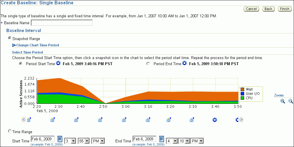

  6. In the Baseline Name field, enter a name for the baseline.

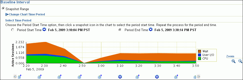

  7. Under Baseline Interval, select whether to use a snapshot range or a time range for the baseline. Do one of the following:
    • To use a range, select Snapshot Range. Complete the following steps:
      • Under Select Time Period, select a start time for the baseline by selecting Period Start Time and the snapshot icon below the Active Sessions chart that corresponds to the desired start time.
      • Select an end time for the baseline by selecting Period End Time and the snapshot icon below the Active Sessions chart that corresponds to the desired end time.
      • Optionally, to view older snapshots that are not displayed below the Active Sessions chart, expand Change Chart Time Period. Enter the desired start date in the Chart Start Date field and the desired end date in the Chart End Date field, and click Go.
      In this example, a snapshot range on February 5, 2009 from 3:10 p.m. to 3:30 p.m. is selected.

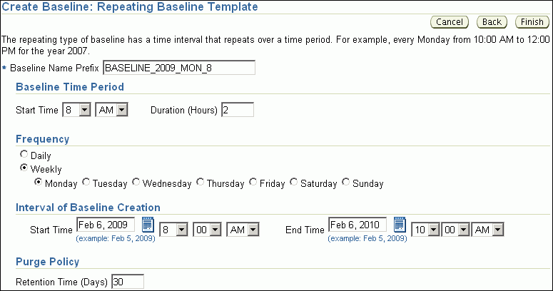

Creating a Repeating Baseline
A repeating baseline is a baseline that repeats during a time interval over a specific period. For example, a repeating baseline may repeat every Monday from 8:00 a.m. to 10:00 a.m. from February 6, 2009 to February 6, 2010.
To create a repeating baseline:
  1. From the Database Home page, click Server.
    The Server page appears.
  2. Under Statistics Management, click AWR Baselines.
    The AWR Baselines page appears with a list of existing baselines displayed.
  3. Click Create.
    The Create Baseline: Baseline Interval Type page appears.
  4. Select Repeating and then click Continue.
    The Create Baseline: Repeating Baseline Template page appears.
  5. In the Baseline Name Prefix field, enter a name prefix for the baseline.
  6. Under Baseline Time Period, specify the time of the day that you want the baseline to begin collecting AWR data and the duration of the baseline collection.
  7. Under Frequency, do one of the following:
    • Select Daily if you want the baseline to repeat on a daily basis.
    • Select Weekly if you want the baseline to repeat on a weekly basis, and then select the day of the week on which the baseline will repeat.
  8. Under Interval of Baseline Creation, complete the following steps:
    1. In the Start Time fields, select a date and time in the future when the data collection should begin.
    2. In the End Time fields, select a date and time in the future when the data collection should end.
  9. Under Purge Policy, enter the number of days to retain captured baselines.
  10. Click Finish.
    A baseline template with the same name as the baseline name prefix will be created. A baseline template is a specification that enables Oracle Database to automatically generate a baseline for a future time period.
    This example creates a baseline that repeats weekly on Mondays from 8:00 a.m. to 10:00 a.m. from February 6, 2009 to February 6, 2010. Every captured baseline expires after 30 days.
    Description of create_baseline_repeating.gif follows

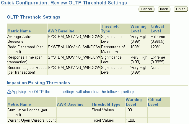

  4. Click Continue.
    The Quick Configuration: Review OLTP Threshold Settings page appears.
    Description of threshold_quick.gif follows
  5. Review the metric threshold settings and then click Finish.

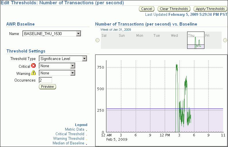

  3. In the Category/Name column, click the link for the metric whose threshold you want to set or change.
    For example, click Number of Transactions (per second).
    The Edit Thresholds: Number of Transactions (per second) appears.
    Description of edit_thresholds.gif follows
    The charts on this page provide simple and detailed views of metric activity for a 24-hour period. In the top simple chart, click a day to view the value of the metric plotted against a 24-hour period.
  4. Under AWR Baseline, in the Name list, select either the default SYSTEM_MOVING_WINDOW or the name of a baseline created in the AWR Baselines page.
    A baseline appears in the AWR Baseline list after you have scheduled statistics computation from the AWR Baselines page and the statistics have finished computing on the static baseline.
    In this example, BASELINE_THU_1530 is selected.
    The page refreshes to show the charts for the baseline that you selected.
  5. In the Threshold Settings section, complete the following steps to change the settings:
    1. In Threshold Type, leave Significance Level selected.
    2. In Critical, select Extreme.
    3. In Warning, select Very High.
    4. In Occurrences, leave the current value.
  6. Click Apply Thresholds.
    You are returned to the Baseline Metric Thresholds page. This page shows the altered metric threshold settings.

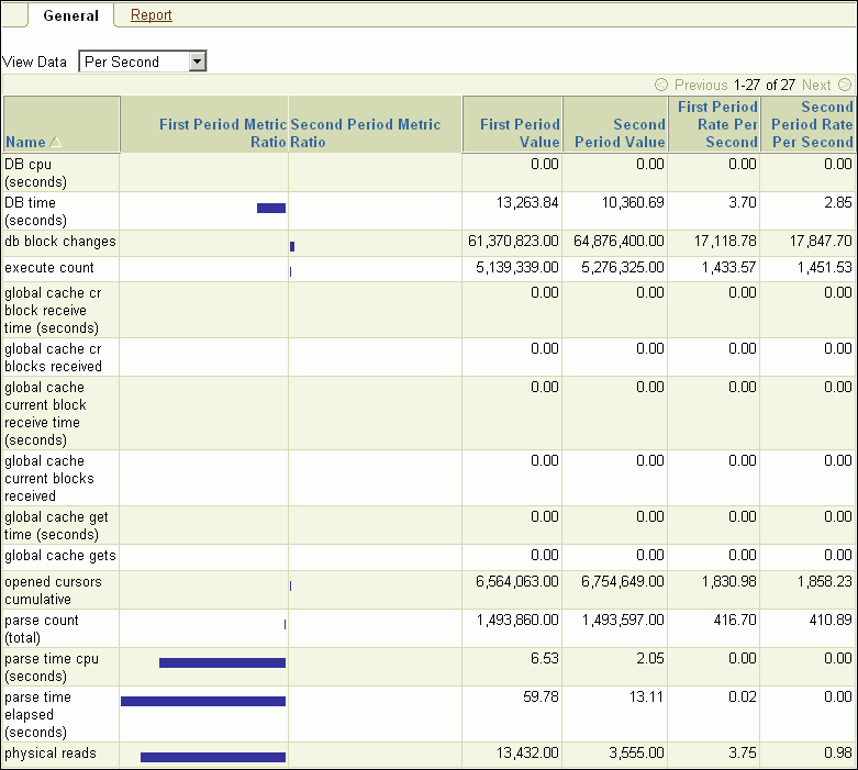

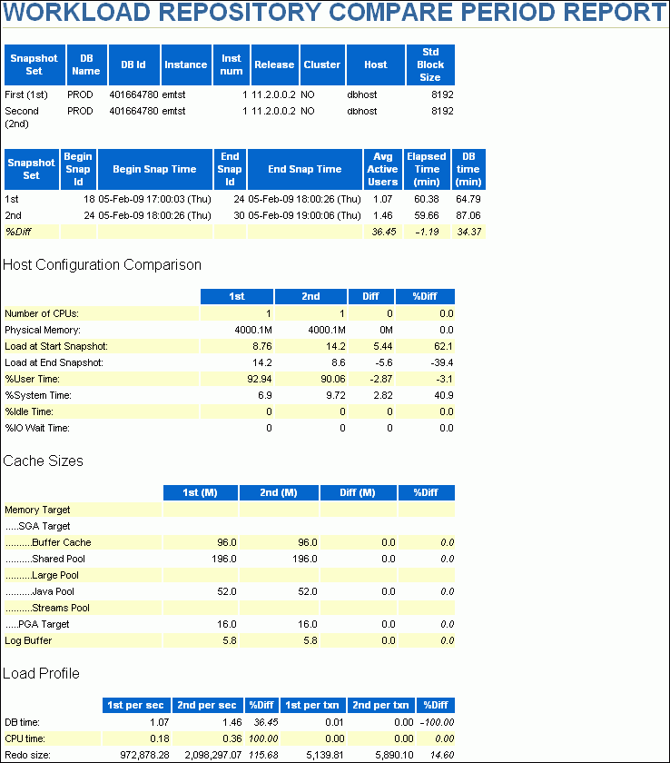

Running the AWR Compare Periods Reports
This section describes how to run the AWR Compare Periods reports using Enterprise Manager.
You can use AWR Compare Periods reports to compare the database performance between two time periods by:
Comparing a Baseline to Another Baseline or Pair of Snapshots
When performance degradation occurs over time, you can run the AWR Compare Periods report to compare the degraded performance, captured as a new baseline or a pair of snapshots, to an existing baseline. You must have a baseline that represents the system operating at an optimal level. If an existing baseline is unavailable, then compare database performance between two periods of time using two arbitrary pairs of snapshots, as described in "Comparing Two Pairs of Snapshots".
To compare a baseline to another baseline

  7. Review the periods to be included in the report and then click Finish.
    The Compare Periods: Results page appears.
    Data from the selected periods appears under the General subpage. You can view data per second or per transaction by selecting an option from the View Data list.
    If the time periods have different lengths, then the data is normalized over database time before calculating the difference so that periods of different lengths can be compared.
    In this example, almost every metric shows that more resources were consumed in the first period. The bar graphs indicate the proportions of the values in the two periods. The absence of bars indicates equivalent values. The report for this example shows significantly more database block changes per second and parse time in the first period than in the second.
    Description of awr2_results_general.gif follows

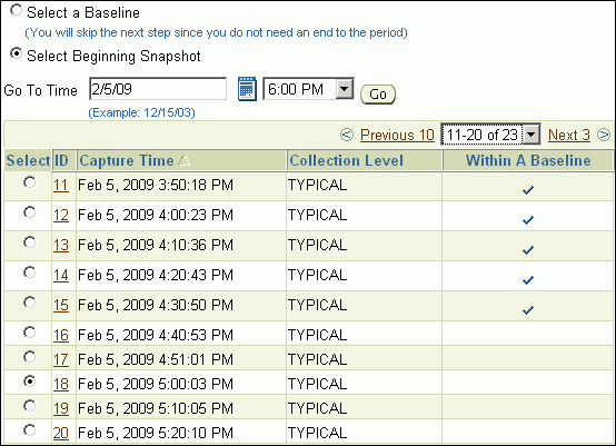

  5. Under Select Beginning Snapshot, select the starting point for the first snapshot period to be included in the report.
    In this example, snapshot 1 is selected.
    Description of awr_snapshot1_begin.gif follows

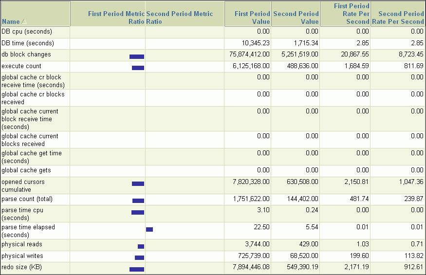

    In the following example, the first period shows more database activity, especially in parse time and physical reads, than the second period.
    Description of awr_results_general.gif follows

After an AWR Compare Periods report is generated for the time periods you want to compare, you can use it to analyze performance degradation. To learn how to create the report, see "Running the AWR Compare Periods Reports".
Figure 8-1 shows a portion of an AWR Compare Periods report.
Figure 8-1 AWR Compare Periods Report
Description of Figure 8-1 follows
Description of "Figure 8-1 AWR Compare Periods Report"
The AWR Compare Periods report is divided into the following sections:
Summary of the AWR Compare Periods Report
The report summary is at the beginning of the AWR Compare Periods report, and summarizes information about the snapshot sets and loads used in the report. The report summary contains the following sections:
Snapshot Sets
The Snapshot Sets section displays information about the snapshot sets used for this report, such as instance, host, and snapshot information.
In the example shown in Figure 8-1, the first snapshot period corresponds to the time when performance was stable on February 5 from 5:00 p.m. to 6:00 p.m. The second snapshot period corresponds to the time when performance degradation occurred on the same day from 6:00 p.m. to 7:00 p.m.
