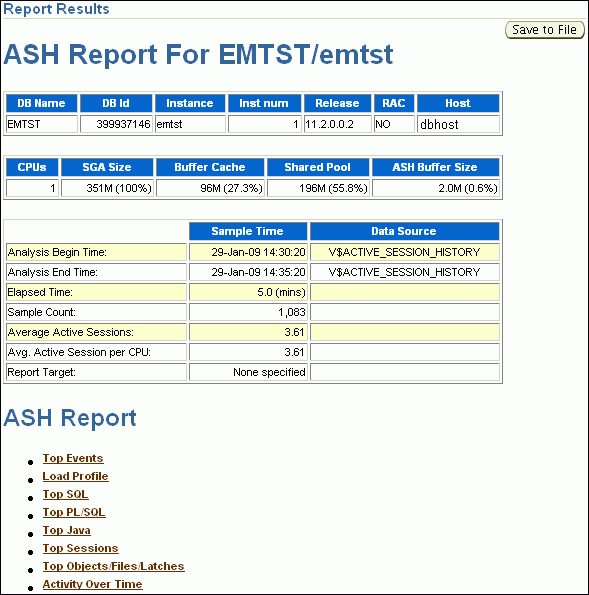

  1. On the Performance page, under Average Active Sessions, click Run ASH Report.
    The Run ASH Report page appears.
  2. Enter the date and time for the start and end of the time period when the transient performance problem occurred.
    In this example, database activity increased between 2:30 p.m. and 2:35 p.m., so an ASH report should be created for that time period.
    Description of run_ash.gif follows
  3. Click Generate Report.
    The Processing: View Report page appears while the report is being generated.
    After the report is generated, the ASH report appears under Report Results on the Run ASH Report page.
    Description of ash_report.gif follows
  4. Optionally, click Save to File to save the report in HTML format for future analysis.

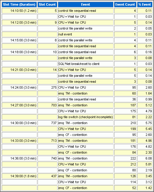

The Activity Over Time section of the ASH report is particularly useful for longer time periods because it provides in-depth details about activities and workload profiles during the analysis period. The Activity Over Time section is divided into time slots. The ASH report time span is divided into 10 time slots unless the time period is short or the data is sparse.
Figure 7-8 shows an activity report for the period between 2:10 p.m. and 2:40 p.m. The report indicates that the number of sampled sessions rose sharply in the fifth inner slot (2:24 p.m.) and stayed up. During this period CPU activity and lock enqueue waits increased dramatically.

Each time slot contains session and wait event activity, as described in Table 7-1.
Table 7-1 Activity Over Time
Column Description
Slot Time (Duration)
Duration of the slot
Slot Count
Number of sampled sessions in the slot
Event
Top three wait events in the slot
Event Count
Number of ASH samples waiting for the wait event
% Event
Percentage of ASH samples waiting for wait events in the entire analysis period
All inner slots are the same number of minutes each for easy comparison. The first and last slots, called outer slots, are odd-sized because they do not have a fixed slot time.
In Figure 7-8, the first outer slot has a duration of 1.2 minutes, whereas the last outer slot has a duration of 1.8 minutes. The duration of each inner slot is 3.0 minutes.
When comparing the inner slots, perform a skew analysis by identifying spikes. A spike in the Slot Count column indicates an increase in active sessions and a relative increase in database workload. A spike in the Event Count column indicates an increase in the number of sampled sessions waiting for an event. Typically, when the number of active session samples and the number of sessions associated with a wait event increase, the slot may be the cause of the transient performance problem.
