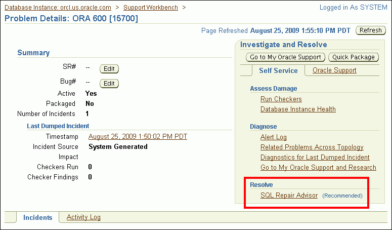

You run the SQL Repair Advisor from the Problem Details page of the Support Workbench. The instructions in this section assume that you were already notified of a critical error caused by your SQL statement and that you followed the workflow described in "Investigating, Reporting, and Resolving a Problem".
To run the SQL Repair Advisor:
Access the Problem Details page for the problem that pertains to the failed SQL statement.
See "Viewing Problems with the Enterprise Manager Support Workbench" for instructions.
In the Investigate and Resolve section, under the Self Service tab, under the Resolve heading, click SQL Repair Advisor.
