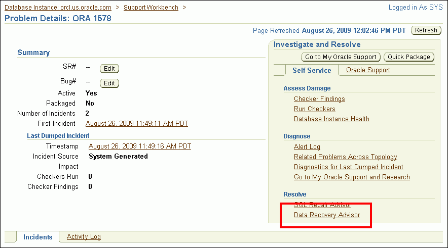

The Data Recovery Advisor is available only when you are connected asSYSDBA.You access the Data Recovery Advisor from the Support Workbench in the following ways:
From the Problem Details page
Click the Data Recovery Advisor link in the Investigate and Resolve section.
See "Viewing Problems with the Enterprise Manager Support Workbench" for instructions on how to access this page.

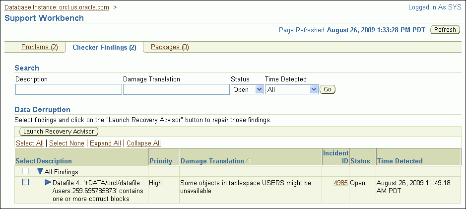

From the Checker Findings subpage of the Support Workbench home page
Select one or more data corruption findings and then click Launch Recovery Advisor.
See "Viewing Problems with the Enterprise Manager Support Workbench" for instructions on how to access the Support Workbench home page.
