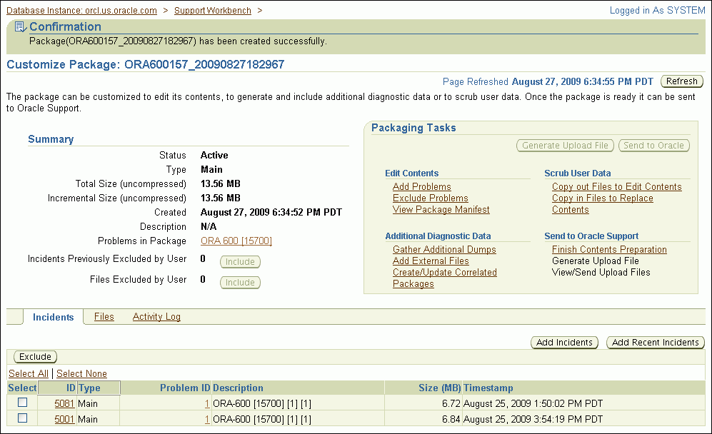

The Customize Package page appears. It displays the problems and incidents that are contained in the package, plus a selection of packaging tasks to choose from. You run these tasks against the new package or the updated existing package.
(Optional) In the Packaging Tasks section, click links to perform one or more packaging tasks. Or, use other controls on the Customize Package page and its subpages to manipulate the package. Return to the Customize Package page when you are finished.
See "Viewing and Modifying Incident Packages" for instructions for some of the most common packaging tasks.

The Customize Package page is used to perform various packaging tasks, such as adding and removing problems; adding, removing, and scrubbing (editing) package files; and generating and uploading the package zip file.
To access the Customize Package page:
Access the Package Details page for the desired package, as described in "Viewing Package Details".
Click Customize Package.
The Customize Package page appears. See Figure 9-7.

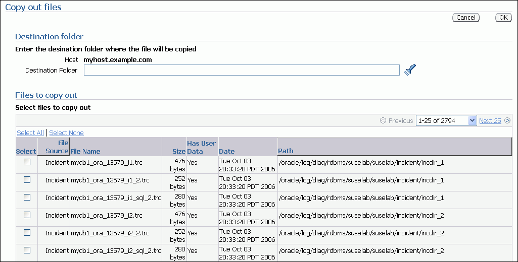

In the Packaging Tasks section, under the Scrub User Data heading, click Copy out Files to Edit contents.
The Copy Out Files page appears. It displays the name of the host to which you can copy files.
Do one of the following to specify a destination directory for the files:
Enter a directory path in the Destination Folder field.

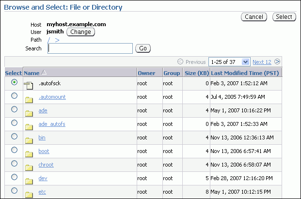

Click the flashlight icon next to the Destination Folder field, and then complete the following steps:
If prompted for host credentials, enter credentials for the host to which you want to copy out the files, and then click OK. (Select Save as Preferred Credential to avoid the prompt for credentials next time.)
In the Browse and Select File or Directory window, click directory links to move down the directory hierarchy, and click directory names next to the Path label to move up the directory hierarchy, until you see the desired destination directory.
To reduce the number of directories displayed in the list, enter search text in the Search field and click Go. All directories that have the search text anywhere in the directory name are displayed.
Select the desired destination directory, and then click Select.
The Browse and Select File or Directory window closes, and the path to the selected directory appears in the Destination Folder field of the Copy Out Files page.
Under Files to Copy Out, select the desired files, and then click OK.
If you do not see the desired files, they may be on another page. Click the Next link to view the next page. Continue clicking Next, or select from the list of file numbers (to the left of the Next link) until you see the desired files. You can then select the files and click OK.The Customize Package page returns, displaying a confirmation message that lists the files that were copied out.

On the Package Details page, click Customize Package.
On the Customize Package page, in the Packaging Tasks section, under Additional Diagnostic Data, click Create/Update Correlated Packages.
See Figure 9-7.
On the Correlated Packages page, under Correlated Packages, select one or more instances that have incidents and click Create.
A confirmation message appears, and the package IDs of the newly created correlated packages appear in the ID column.
