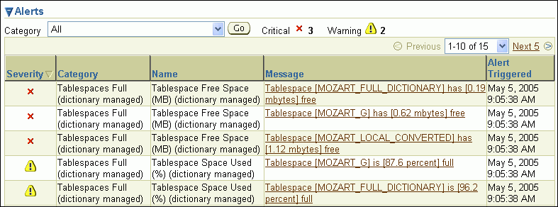

You view alerts by accessing the home page of Enterprise Manager Database Control.
You can also view alerts for locally managed tablespaces with the DBA_OUTSTANDING_ALERTS view. See "Server-Generated Alerts Data Dictionary Views" for more information.
