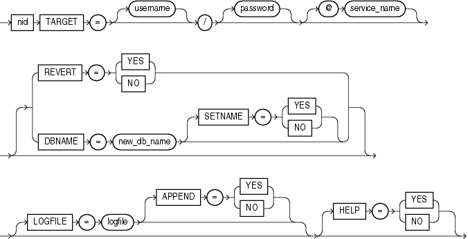

  3. Invoke the DBNEWID utility on the command line, specifying a valid user (TARGET) that has the SYSDBA privilege (you will be prompted for a password):
    % nid TARGET=SYS
    To change the database name in addition to the DBID, also specify the DBNAME parameter on the command line (you will be prompted for a password). The following example changes the database name to test_db:
    % nid TARGET=SYS DBNAME=test_db

  3. Invoke the utility on the command line, specifying a valid user with the SYSDBA privilege (you will be prompted for a password). You must specify both the DBNAME and SETNAME parameters. This example changes the name to test_db:
    % nid TARGET=SYS DBNAME=test_db SETNAME=YES

DBNEWID Syntax
The following diagrams show the syntax for the DBNEWID utility.
Description of nid.gif follows
Parameters
Table 18-1 describes the parameters in the DBNEWID syntax.
Table 18-1 Parameters for the DBNEWID Utility
Parameter Description
TARGET
Specifies the username and password used to connect to the database. The user must have the SYSDBA privilege. If you are using operating system authentication, then you can connect with the slash (/). If the $ORACLE_HOME and $ORACLE_SID variables are not set correctly in the environment, then you can specify a secure (IPC or BEQ) service to connect to the target database. A target database must be specified in all invocations of the DBNEWID utility.
REVERT
Specify YES to indicate that a failed change of DBID should be reverted (default is NO). The utility signals an error if no change DBID operation is in progress on the target database. A successfully completed change of DBID cannot be reverted. REVERT=YES is valid only when a DBID change failed.
DBNAME=new_db_name
Changes the database name of the database. You can change the DBID and the DBNAME of a database at the same time. To change only the DBNAME, also specify the SETNAME parameter.
SETNAME
Specify YES to indicate that DBNEWID should change the database name of the database but should not change the DBID (default is NO). When you specify SETNAME=YES, the utility writes only to the target database control files.
LOGFILE=logfile
Specifies that DBNEWID should write its messages to the specified file. By default the utility overwrites the previous log. If you specify a log file, then DBNEWID does not prompt for confirmation.
APPEND
Specify YES to append log output to the existing log file (default is NO).
HELP
Specify YES to print a list of the DBNEWID syntax options (default is NO).
