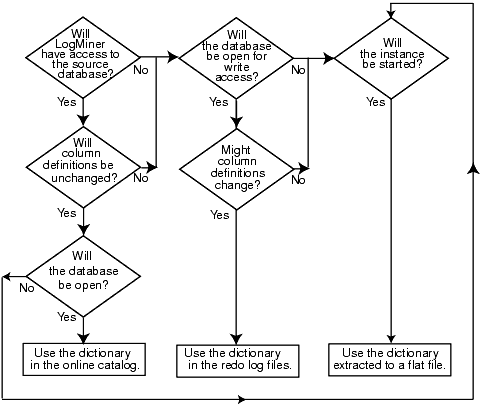

LogMiner Dictionary Options
LogMiner requires a dictionary to translate object IDs into object names when it returns redo data to you. LogMiner gives you three options for supplying the dictionary:
  • Using the Online Catalog
    Oracle recommends that you use this option when you will have access to the source database from which the redo log files were created and when no changes to the column definitions in the tables of interest are anticipated. This is the most efficient and easy-to-use option.
  • Extracting a LogMiner Dictionary to the Redo Log Files
    Oracle recommends that you use this option when you do not expect to have access to the source database from which the redo log files were created, or if you anticipate that changes will be made to the column definitions in the tables of interest.
  • Extracting the LogMiner Dictionary to a Flat File
    This option is maintained for backward compatibility with previous releases. This option does not guarantee transactional consistency. Oracle recommends that you use either the online catalog or extract the dictionary from redo log files instead.
Figure 19-2 shows a decision tree to help you select a LogMiner dictionary, depending on your situation.
Figure 19-2 Decision Tree for Choosing a LogMiner Dictionary
Description of Figure 19-2 follows
Description of "Figure 19-2 Decision Tree for Choosing a LogMiner Dictionary"
The following sections provide instructions on how to specify each of the available dictionary options.

Extract a LogMiner Dictionary
To use LogMiner, you must supply it with a dictionary by doing one of the following:
