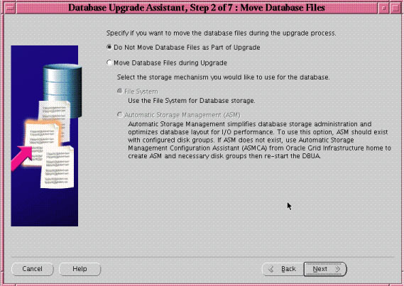

Relocating Existing Data Files to the New Oracle Database Environment
Before you remove the old Oracle environment, you must relocate any data files in that environment to the new Oracle Database environment.
To relocate data files to the new Oracle Database environment
  • Use Database Upgrade Assistant (DBUA) and select the Move Database Files option during the upgrade.
See Also:
"Upgrading with Database Upgrade Assistant on Linux, UNIX, and Windows" for more information

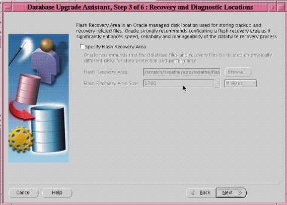

Flashback: OFF

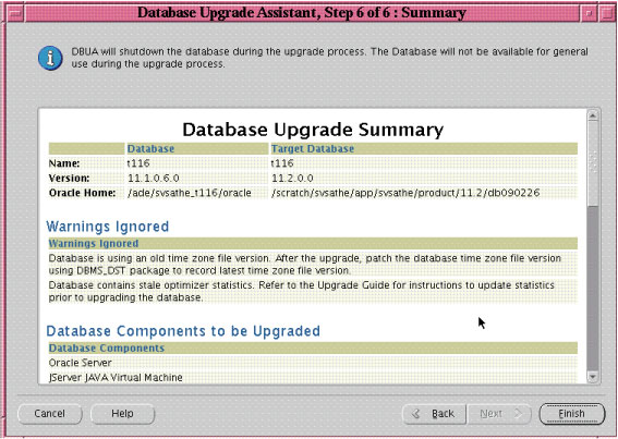

WARNING: --> Database is using a timezone file older than version 14.
.... After the release migration, it is recommended that DBMS_DST package
.... be used to upgrade the 11.2.0.1.0 database timezone version
.... to the latest version which comes with the new release.

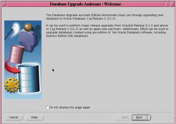

  1. Start DBUA from the Oracle home where the new database software has been installed:
    • On Linux or UNIX platforms, enter the following command at a system prompt in the new Oracle Database 11g Release 2 (11.2) home:
      dbua
      The dbua executable is usually located in the ORACLE_HOME/bin directory.
    • On Windows operating systems, select Start > Programs > Oracle - HOME_NAME > Configuration and Migration Tools > Database Upgrade Assistant.
    The DBUA Welcome screen displays.
    Description of dbua01.jpg follows
  2. If you need help at any screen or want to consult more documentation about DBUA, then click Help to open the online help.
    Click Next.

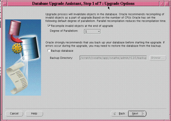

  4. The Upgrade Options screens allows you to set the following options:
    Recompile invalid objects at the end of upgrade
    Select Recompile invalid objects at the end of upgrade if you want DBUA to recompile all invalid PL/SQL modules after the upgrade is complete.
    When you upgrade a database to Oracle Database 11g Release 2 (11.2), many of the PL/SQL modules in your database become invalid. As a result, all existing PL/SQL modules in an INVALID state must be recompiled, such as packages, procedures, types, and so on.
    By default, Oracle Database recompiles invalid PL/SQL modules as they are used. The time it takes to recompile the module can result in poor performance when you begin to use your newly upgraded database.
    To eliminate these performance issues, select Recompile invalid objects at the end of upgrade. When you select this option, DBUA recompiles all the invalid PL/SQL modules immediately after the upgrade is performed. This ensures that you do not experience any performance issues later, as you begin using your newly upgraded database.
    Selecting Recompile invalid objects at the end of upgrade is equivalent to running the utlrp.sql script, located in the ORACLE_HOME/rdbms/admin directory, which is used to recompile stored PL/SQL and Java code.
    The task of recompiling all the invalid PL/SQL modules in your database can take a significant amount of time and increase the time it takes to complete your database upgrade. If you have multiple CPUs, then you can reduce the time it takes to perform this task by taking advantage of parallel processing on your available CPUs. If you have multiple CPUs available, then DBUA automatically adds an additional section to the Recompile Invalid Objects screen and automatically determines the number of CPUs you have available.

    Backup Database
    Select Backup database if you want DBUA to back up your database for you.
    Important:
    Oracle strongly recommends that you back up your database before starting the upgrade. If errors occur during the upgrade, then you might be required to restore the database from the backup.
    If you use DBUA to back up your database, then it makes a copy of all your database files in the directory you specify in the Backup Directory field. DBUA performs this cold backup automatically after it shuts down the database and before it begins performing the upgrade procedure. The cold backup does not compress your database files, and the backup directory must be a valid file system path. You cannot specify a raw device for the cold backup files.
    In addition, DBUA creates a batch file in the specified directory. You can use this batch file to restore the database files:
    • On Windows operating systems, the file is called db_name_restore.bat.
    • On Linux or UNIX platforms, the file is called db_name_restore.sh.
    If you choose not to use DBUA for your backup, then Oracle assumes you have backed up your database using your own backup procedures.
    DBUA does not back up Oracle ASM databases. You must manually back them up on your own.
    Click Next.
    If you are upgrading a single-instance database or Oracle Express Edition (XE), then the Move Database Files screen appears. If you are upgrading an Oracle Real Application Clusters database, then the Move Database Files screen does not display.
    Description of dbua04.jpg follows
  5. Select one of the following options:
    • Do Not Move Database Files as Part of Upgrade
    • Move Database Files during Upgrade
    If you choose to move database files, then you must also make one of the following selections:
    • File System
      Your database files are moved to the host file system.
    • Oracle Automatic Storage Management (Oracle ASM)
      Your database files are moved to Oracle ASM storage, which must currently exist on your system. If you do not have an Oracle ASM instance, then you can create one using Automatic Storage Management Configuration Assistant (ASMCA) from the Oracle Grid Infrastructure home and then restart DBUA.
      See Also:
      Click Next.
      The Recovery and Diagnostic Locations screen displays, where you can designate a flash recovery area for your database.
      Description of dbua05.jpg follows
    Flash recovery area is an Oracle managed disk location used for storing backup and recovery related files. Oracle strongly recommends configuring a flash recovery area, because it significantly enhances speed, reliability, and manageability of the database recovery process. The location of the flash recovery area is also used by Enterprise Manager if you enable local management and daily backups on the Management Options screen.
    If you selected the Move Database Files during Upgrade option in step 5, or if an Oracle Express Edition database is being upgraded to Oracle Enterprise Edition, then you must configure a flash recovery area. If a flash recovery area is currently configured, then the current settings are retained but the screen displays to allow you to override these values.
  6. Do one of the following:
    • Accept the default flash recovery area location
    • Enter the full path to a different location in the Flash Recovery Area field
    • Click Browse and select a different flash recovery area location
    • Accept the default size for the flash recovery area
    • Enter a different value in the Flash Recovery Area Size field
    • Click the up or down arrows to adjust the flash recovery area size
    See Also:
    Oracle Database 2 Day DBA for more information about configuring the flash recovery area
    Click Next.

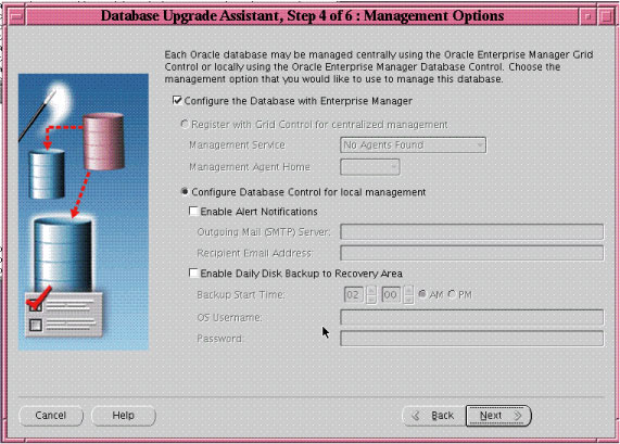

    At the Management Options screen, you have the option of setting up your database so it can be managed with Enterprise Manager. Enterprise Manager provides Web-based management tools for managing individual database instances, as well as central management tools for managing your entire Oracle environment, including multiple databases, hosts, application servers, and other components of your network.
    Before you can register the database with Oracle Enterprise Manager Grid Control, an Oracle Enterprise Manager Agent must be configured on the host computer.
  7. To set up your database to be managed with Enterprise Manager, select Configure the Database with Enterprise Manager and then select one of the following options:
    • Register with Grid Control for centralized management
      If you select this option, then you must also select an Oracle Management Service from the Management Service drop-down list. When you run DBUA, it checks to see if the Oracle Management Agent has been installed on the host computer. If no Oracle Management Agent is found, then the Grid Control option is not available.
      When you finish installing the Oracle Database software, the database is automatically available as a managed target within Oracle Enterprise Manager Grid Control.
    • Configure Oracle Enterprise Manager Database Control for local management
      If you are not centrally managing your Oracle environment, then you can still use Enterprise Manager to manage your database. When you install Oracle Database, you automatically install Oracle Enterprise Manager Database Control, which provides Web-based features for monitoring and administering the single-instance or cluster database you are installing.
      Do the following steps if you want the SYSMAN user (the default Super Administrator and owner of the Management Repository schema) to receive E-mail notification when a metric for a specified condition reaches a critical or warning threshold:
      • Select Enable Alert Notifications
      • Enter the name of the e-mail server you want to use for notifications in the Outgoing Mail (SMTP) Server field
      • Enter the e-mail address of the SYSMAN user in the Recipient Email Address field
      For example, Enterprise Manager can send an e-mail when a target goes down or when there are database space usage problems. E-mail notifications are enabled immediately upon installation.
      Do the following steps to use the Oracle suggested backup strategy to back up your entire database with a minimum amount of configuration:
      • Select Enable Daily Disk Backup to Recovery Area
      • Enter a start time in the Backup Start Time field
      • Enter host credentials in the OS Username and Password fields
      If you select the Enable Daily Disk Backup to Recovery Area option, then Enterprise Manager is configured to back up your database immediately after you finish upgrading Oracle Database. Enterprise Manager backs up the database to the flash recovery area. Later, you can use Enterprise Manager to customize your backup strategy further.
      On Windows the user whose credentials you enter for the backup must be granted the Logon as a batch job privilege in the Local Security Policies of Windows. If the chosen user does not have this privilege, then the backup job fails.
    Click Next.

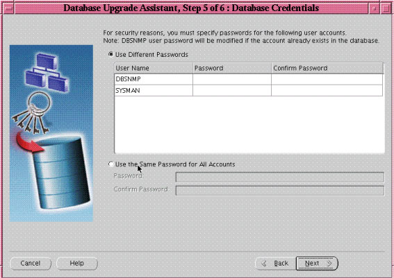

  8. Select one of the following options:
    • Use Different Passwords
      If you choose to use different passwords, then you must enter a password in the Password and Confirm Password columns for each account in the table.
    • Use the Same Password for All Accounts
      If you choose to use the same password, then you must enter that password in the Password and Confirm Password fields.
      If the default Oracle Database 11g Release 2 (11.2) security settings are in place, then new passwords must be at least eight characters, and passwords such as welcome and oracle are not allowed. See Oracle Database Security Guide for more information.
    Click Next.

  9. The Summary screen shows the following information about the upgrade before it starts:
    • Name, version, and Oracle home of the old and new databases
    • Database backup location, available space, and space required
    • Warnings ignored
    • Database components to be upgraded
    • Initialization parameters changes
    • Database files location
    • Listener registration
    See Also:
    "Setting the COMPATIBLE Initialization Parameter" for information about setting the COMPATIBLE initialization parameter after the upgrade
    Check all of the specifications. Then do one of the following:
    • Click Back if anything is incorrect until you reach the screen where you can correct it.
    • Click Finish if everything is correct.
    The Progress screen displays and DBUA begins the upgrade.

    Specify the attributes for the SYSAUX tablespace, which is added automatically to all new Oracle Database 11g Release 1 (11.1) databases you create.
    See Also:
    Oracle Database Administrator's Guide for more information about the SYSAUX tablespace
    Many of the attributes of the SYSAUX tablespace are set automatically and cannot be modified. For example, the SYSAUX tablespace is set to use Automatic Segment-Space Management. However, you can specify the location of the data file, the default size of the SYSAUX tablespace, and its autoextend attributes.
    If you specify an existing datafile for the SYSAUX tablespace, then you must select Reuse Existing File Name. Otherwise, DBUA alerts you to the fact that the file currently exists.
    Click Next.
    The Recompiling Invalid Objects screen appears.
  13. Secure your database with passwords for the Enterprise Manager accounts. You can set a single password, which is applied to each of the listed Enterprise Manager user accounts, or enhance the security of the accounts by providing unique passwords for each user.
    Click Next.
    The Recovery Configuration screen appears.
  14. Specify a flash recovery area and enable archiving. When you are managing your database, it is important to configure the database so you can recover your data in the event of a system failure.
    The Flash Recovery Area can be used to recover data that would otherwise be lost during a system failure. This location is also used by Enterprise Manager if you enabled local management and daily backups on the Management Options screen.
    Click Next.
    The Network Configuration screen appears.
  15. At the Upgrade Operations page, do one of the following:
    • Select the option to upgrade only the Oracle ASM instance
    • Select the option to upgrade the database
      If you choose to upgrade the database, and the database is using Oracle ASM, then DBUA asks if you want to upgrade the Oracle ASM instance along with the database. Oracle recommends that you upgrade the database and Oracle ASM in separate DBUA sessions, in separate Oracle homes.
    Click Next.
    The Selecting a Database Instance screen appears.
  16. At the Changes in Default Behavior screen, DBUA displays some changes in the behavior of Oracle Database 11g Release 1 (11.1) from that of previous releases. In some cases the default values of some initialization parameters have changed. In other cases some new behavior/requirement has been introduced that might affect current scripts or applications.
  17. Complete the procedures described in Chapter 4, "After Upgrading to the New Release".

Displays help for DBUA
DBUA Command Line Syntax for Silent Mode
You can specify all valid options from the command line using the following syntax:
dbua [ -silent ] [ -sid SID ] [-oracleHome home_name] [-oracleBase base_name]
[-diagnosticDest diagnostic_destination]
[-sysDBAUserName SYSDBA_user] [-sysDBAPassword SYSDBA_pwd]
[-upgradeASM] [-autoextendFiles] [-newGlobalDbName db_name] [-newSid new_SID]
[-generateMapFile] [-useASM] [-commonFileLocation common_files]
[-omfLocation omf_area] [-databaseMapFile map_file_name]
[-newRecoveryArea recover_area] [-newRecoveryAreaSize recover_size]
[-apexAdminPassword apex_pwd] [-disableUpgradeScriptLogging ]
[-backupLocation directory]
[-sysauxTablespace -datafileName name -datafileSize size
  -datafileSizeNext size -datafileSizeMax size]
[-postUpgradeScripts script [, script ] ... ]
[-initParam parameter=value [, parameter=value ] ... ]
[-disableArchiveLogMode] [-recompile_invalid_objects true | false]
[-degree_of_parallelism cpu_number]
[-emConfiguration {CENTRAL|LOCAL|ALL|NOBACKUP|NOEMAIL|NONE}
  -dbsnmpPassword password -sysmanPassword password -asmPassword password
  -hostUserName hostname -hostUserPassword password -backupSchedule hh:mm
  [-smtpServer server_name -emailAddress address]
  [-centralAgent location] [-localRacSid SID]]
[-recoveryAreaDestination directory] [-h|-help]
