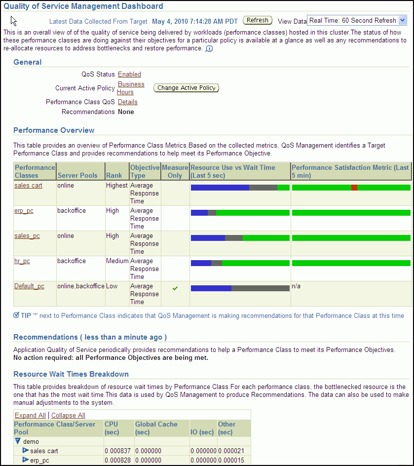

  4. The Quality of Service Management Dashboard page is displayed after the correct credentials are entered.
    Description of qos_dashboard_02.gif follows
The Dashboard has four main sections:
  • General
  • Performance Overview
  • Recommendations
  • Resource Wait Time Breakdown
The General section of the Dashboard gives you a quick overview of the system. This section lists the QoS Status (Enabled or Disabled), the Current Active Policy, a link for checking the Performance Class details, and a notification for available recommendations. There is also a button that enables you to quickly change the current active policy.
In the Performance Overview section, there is a table that lists the Performance Classes, the server pools where work is occurring, their rank, the Performance Objective being measured, and whether the Performance Objectives are being monitored only, or are being monitored and managed. For each Performance Class there are bar graphs that provide an overview of the Performance Class metrics. See "Interpreting the Performance Overview Graphs" for more information.
In the Recommendation section you can view the recommendations that are available when a Performance Class is not meeting its Performance Objectives. You can also view any violations that prevent the recommendations from being made.

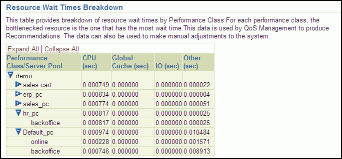

At the bottom of the Dashboard is the Resource Wait Times Breakdown section. This section contains a table that provides a breakdown of resource wait times by Performance Class. For each Performance Class, the bottlenecked resource is the one that has the most wait time. This data is used by QoS Management to produce Recommendations. The data can also be used to make manual adjustments to the system. If you expand each Performance Class listed in the table, then you can see the server pools for that Performance class, and the resource wait times for each server pool.

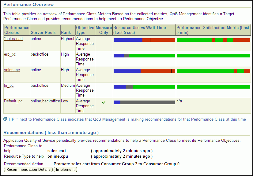

On the Dashboard, in the Performance Overview section, there is a list of the current Performance Classes, some basic information about each Performance Class, and two bar graphs that show the most recent trend for the performance metrics for that class, as shown in Figure 4-1.
Figure 4-1 Example of the Performance Overview Charts
Description of Figure 4-1 follows
Description of "Figure 4-1 Example of the Performance Overview Charts"
In Figure 4-1, there are bar graphs for the sales_cart, erp_pc, sales_pc, hr_pc, and Default_pc Performance Classes. There are two bar graphs displayed for each Performance Class. The two bar graphs are titled Resource Use vs. Wait Time (Last 5 sec.) and Performance Satisfaction Metric (Last 5 min.). The Resource Use vs. Wait Time bar graph has three sections of varying size that illustrate the resource use, wait and headroom portions of the Performance Objective. The Performance Satisfaction Metric bar graph is displayed as a single bar, growing from left to right, with the green and red segments representing the five second time slices that were exceeding or violating the Performance Objective respectively. If you place your cursor over a section of the bar graph, then a description of that measurement appears by your cursor.
In Figure 4-1, there is no Performance Satisfaction Metric bar graph displayed for the Default_pc Performance Class because the Default_pc Performance Class is only monitored. Oracle Database QoS Management does not calculate the performance satisfaction metrics for Performance Classes that are marked as Measure Only.
The Resource Use vs. Wait Time chart is refreshed only when you refresh the page contents. In this chart:
  • The blue section represents the portion of the average time spent for all database requests by that Performance Class using resources in the last five seconds
  • The gray section represents the portion of the average time spent for all database requests by that Performance Class waiting on resources in the last five seconds
  • The green section represents the headroom for that Performance Class (proportion of the average time for all database requests below the specified Performance Objective) in the last five seconds
  • If a Performance Class is not meeting its Performance Objectives, then the gray and green sections disappear and the resource wait time is shown in red with a line to indicate where the Performance Objective is relative to the actual response time.
  • If you place your mouse cursor over any section of this bar graph, then the actual values of Use, Wait and Headroom are displayed
The point between the gray and the green sections of the bar is the Performance Objective value. If you set this value below the resource use time, then you will never meet that objective. When configuring the Performance Objectives for a Performance Class, you must set the Performance Objective high enough to produce sufficient headroom (shown in green) to be able to share resources between Performance Classes to meet service levels as demand changes.
If red appears in this chart for a Performance Class, then you know that the Performance Class is not meeting its Performance Objectives. Oracle Database QoS Management issues a recommendation and an action to implement, if possible, to correct the problem. The recommendations generated by Oracle Database QoS Management occur once each minute, so they correspond to an earlier time than the current Performance Overview charts.

The Performance Satisfaction Metric chart changes to show red and green lines for specific five second samples. Using this chart you can spot trends in the performance of your system.
For the Performance Satisfaction Metric bar graph:
  • The red section represents the periods of time the Performance Class was not meeting its Performance Objectives during the sampling period
  • The green section represents the periods of time the Performance Class was meeting its Performance Objectives during the sampling period

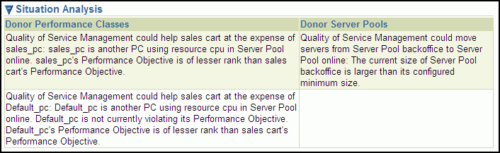

The Recommended Actions page also has a section called Situation Analysis. If you display the output in this section, then you can see a description the projected impact implementing the Recommendation will have on the Performance Classes and the server pool, as shown in the following screenshot.
Description of apqos_recmnd_detail2c_02.gif follows

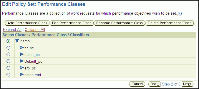

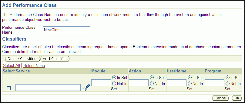

  3. The second page enables you to create, edit, rename, or delete Performance Classes for the system. You can create a new Performance Class, or use the Edit Performance Class button to modify the classifiers for an existing Performance Class.
    Description of policy_edit_2_02.gif follows
    You can use the Expand All link to show the classifiers for each Performance Class, or expand an individual Performance Class entry to show the classifiers for only that Performance Class.
    Select the Performance Class you want to edit, and then click the appropriate action button (Edit, Rename, or Delete). If you want to create a Performance Class for this Policy Set, then click the Add Performance Class button. See "Creating a Performance Class" for more information on creating a Performance Class.
    When you have finished, click Next.

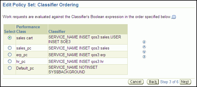

  4. After creating or modifying the Performance Classes, the next step is to set the order in which the classifiers are evaluated.
    Description of policy_edit_3_02.gif follows
    This step is very important, because the classifiers determine which Performance Class a work request is placed into. Select a Performance Class and use the arrow keys to the right of the classifiers to move the entries up and down in the list.
    As a work request enters the system, the work request is evaluated against the classifiers. The first expression that evaluates to TRUE determines which Performance Class the work request belongs to. You should put the more fine-grained classifiers at the top, and the more generic classifiers at the bottom of the list.

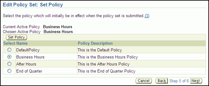

  6. After you have configured the Performance Policies, you must choose which one to put into effect immediately after the Policy Set is submitted.
    Description of policy_edit_5_02.gif follows
    Select the preferred Performance Policy, then click Set Policy. When finished, click Next.

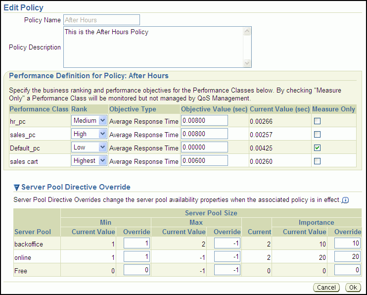

To modify the server pool settings, you configure a server pool directive override for a Policy Set. When you configure server pool directive overrides, the new parameters you specify for the server pool are used instead of the parameters specified at the time of server pool creation.
You can change the minimum and maximum settings for the listed server pools, but you cannot create additional server pools using this interface. Any changes made here, after they are submitted, alter the current server pool properties set in the Manage Server Pools section of Oracle Enterprise Manager Database Control.
You can modify the server pool parameters manually using the Manage Server Pool pages of Enterprise Manager Database Control or SRVCTL, but you should not use this method of altering the server pool configuration when you have Oracle Database QoS Management enabled. If you use both server pool directive overrides and manually change the server pool configuration, then the server pool directive overrides specified for the current Policy Set will override the manual settings and can result in confusion.
To create or edit the Performance Classes and the classifiers they use, perform the following tasks:
  1. Start the Policy Set Editor wizard using the Edit Policy Set link in Oracle Enterprise Manager Database Control.
  2. Go to the second screen in the wizard.
    On the Edit Policy Set: Performance Classes page, the available Performance Classes are displayed. If this is the first time configuring the system, then a Performance Class for each database service is shown along with a Default Performance Class.
    To specify a classifier for a work request, you must specify at least one service name. If you specify multiple services, then use a comma-delimited list. Optionally, you can also specify any of the following filters:
    • A comma-delimited list of module names and whether the work request uses a module in this list
    • A comma-delimited list of actions, and whether the work request performs an action in this list
    • A comma-delimited list of user names, and whether the work request uses a user name in this list
    • A comma-delimited list of programs, and whether the work request is running a program in this list
  3. Click Add Performance Class, and the Performance Class creation page is displayed. In the Performance Class Name text field, enter a name for the Performance Class.
    Description of add_perf_class_1_02.gif follows
  4. In the Classifiers section, enter information to define a rule for classifying work requests. First select a database service, then specify matching values (In Set) for the module, action, UserName, or program name that is associated with the work request using the specified database service. You can also specify exclusion values (Not In Set) for these attributes.
    If you want to add multiple classifiers for the Performance Class, then click the Add Classifier button and enter in the appropriate information.
    When evaluating a classifier for a Performance Class, all of the specified values are compared to the work request attributes using an AND operation; if you specify multiple classifiers for the Performance Class, then the results of each classifier evaluation for that Performance Class are combined using an OR operation.
  5. After you have defined all the classifiers for the Performance Class, click the Next button until you reach the end of the wizard. Review the information you specified, then click Submit Policy Set.

Specifying the Evaluation Order of the Classifiers
The classifiers generate Boolean expressions that are evaluated each time a work request enters the system. The first classifier that evaluates to TRUE determines the Performance Class for that work request. To ensure that the work requests are put in the correct Performance Classes, you must be careful in specifying the order in which the classifiers are evaluated.
To set the order of evaluation for the classifiers, perform the following steps:
  1. Start the Policy Set Editor wizard.
  2. Proceed to the third page in the wizard, which is titled Edit Policy Set: Classifier Ordering.
  3. Use the arrow keys to the right of a classifier to move the classifier up or down in the list. The classifiers for the Performance Classes at the top of the list are evaluated first. If the work request does not match the classifiers for that Performance Class, then evaluation continues with the next Performance Class in the list, until there are no further evaluations to be made. If a work request matches the classifiers for a Performance Class, then the work request is associated with that Performance Class and evaluation stops.
    For proper classification of work requests, you should put the Performance Classes with the strictest classifiers at the top of the list, and the Performance Classes with most lax classifiers near the bottom of the list. The Default_pc Performance Class, which has the most general classifiers, should always be at the bottom of the list.
  4. You then advance to the end of the Edit Policy Set wizard, and click Submit Policy Set to make the change permanent.

Setting the Current Performance Policy
You can change the Performance Policy that will be active when you submit the Policy Set to Oracle Database QoS Management.
To set the current Performance Policy, perform the following steps:
  2. Proceed to the fifth page in the wizard, which is titled Edit Policy Set: Set Policy.
  3. Select the Performance Policy you want enforced, and click Set Policy.
At the end of the Policy Set Editor wizard, you can review the settings you specified, then click Submit Policy Set to configure Oracle Database QoS Management.

A server pool directive override gives you the ability to enforce different settings for server pool sizes, or change the importance of server pools. For example, if you are expecting a surge in demand, such as during an advertised sale period, then you could use a server pool directive override to allocate more resources to the accounting applications.
Server pool directive overrides should be used only when necessary. Instead of using a server pool directive override, you should monitor the system over time and modify the server pool settings as needed. Using a server pool directive override can result in unexpected changes in resource allocations. For example, assume you have server pools named webapps, HR, and payroll. You create a server pool directive override to increase the minimum server pool size for the payroll server pool. When the server pool directive override is active, a server might be removed from the HR or webapps server pool to satisfy the higher minimum server requirement of the payroll server pool.
See Also:
"Modifying Server Pool Settings" for more information about configuring the server pool settings
To configure a server pool directive override, perform the following steps:
  2. Proceed to the fourth page in the wizard, which is titled Edit Policy Set: Performance Policies.
  3. Click the Edit Policy button to edit a Performance Policy. The Edit policy page appears.
    Expand the Server Pool Directive Override section, if necessary.
    Description of server_pool_overrides.gif follows
    To set server pool directive overrides, perform the following:
    • To override the current value for the minimum number of servers in a server pool, enter a new value in the Min:Override field for that server pool. Valid values are 0 to the maximum number of servers in that server pool.
    • To override the current value for the maximum number of servers in a server pool, enter a new value in the Max:Override field for that server pool. Valid values are from the minimum number of servers in that server pool to the size of the cluster.
    • To override the current value for the Importance of the server pool, enter a new value in the Importance:Override field for that server pool. Valid values are 0 to 1000; higher values indicate greater importance.
    After you have finished entering the server pool directive override values, click OK to implement the changes.

You can view a variety of performance metrics for the Oracle Database QoS Management system as a whole, or for individual Performance Classes.
Viewing Performance Metrics for All Performance Classes
After you have configured Oracle Database QoS Management, a short period of time is required for Oracle Database QoS Management to gather performance data and evaluate the performance of the system. After this period of time has passed, you can view the performance metrics for your system. To view the current performance metrics, perform the following steps:
  1. Log in to Oracle Enterprise Manager Database Control as the cluster administrator. Select the Cluster tab, if necessary.
  2. Go to the Administration page.
  3. In the section Quality of Service Management, click View Performance Class Quality of Service.

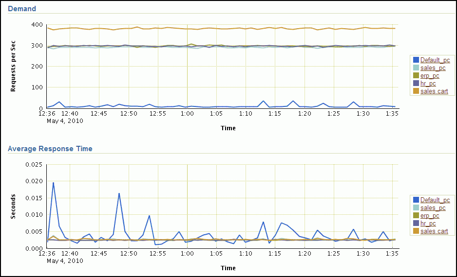

  4. The Performance Class Quality of Service page displays three charts measuring the current performance of each Performance Class that is being monitored.
    Description of perf_class_qos_chart1_02.gif follows
    Description of perf_class_qos_chart2_02.gif follows

At the bottom of the Dashboard is the Resource Wait Times Breakdown table. This table provides breakdown of resource wait times by Performance Class. For each Performance Class, the bottlenecked resource is the one that has the most wait time. This data is used by Oracle Database QoS Management to produce recommendations. You can also use this data to make manual adjustments to your system.
Description of res_wait_table_02.gif follows
